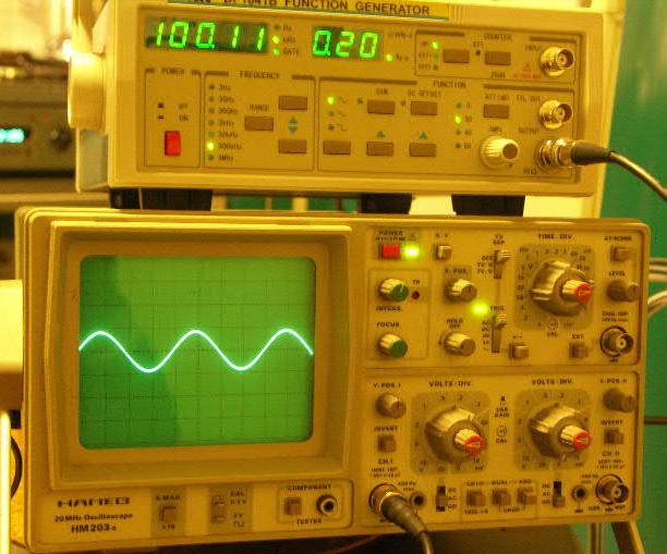

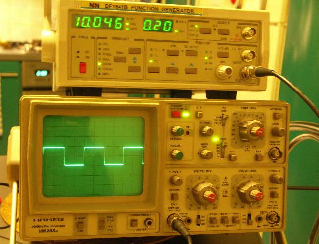

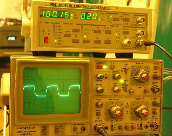

Is there anybody built a non feedback amplifier??

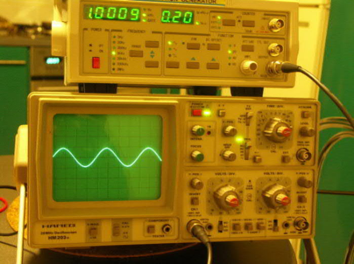

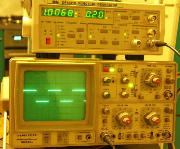

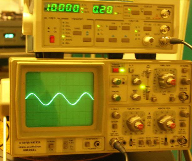

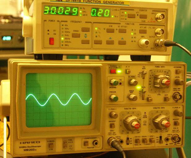

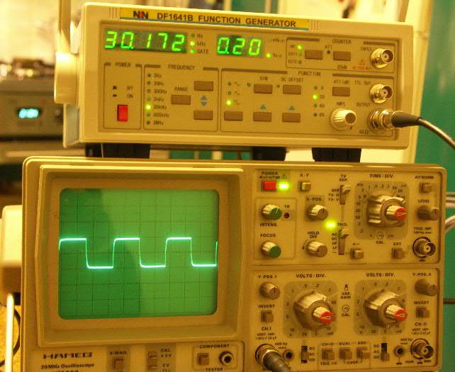

And the testing setup:
1. load 4 ohm
2. input 200mVpp
3. zobel network (100nF/100ohm) at the output
4. without a capacitor pFs at input to the ground
Hi
Impressive waveshape pictures especially at 100KHz!
These must definitively be translated in good sound, don't they?
When I see something like this I can't help to drull over it and
I think that "one more amplifier" doesn't matter, I would like to
build it.
How do I go about to get the boards and how much do they cost?
Thanks for the info

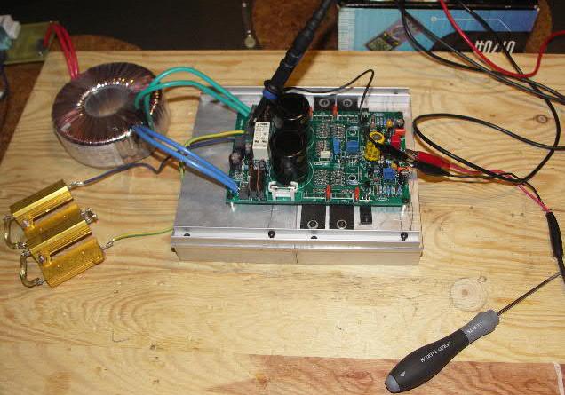

Re: My project alive!
jarek said:
The prototype of amplifier from http://www.diyaudio.com/forums/showthread.php?postid=399274#post399274 is working now.
Bias points are exactly as from PSPICE simulations. There is a 100uF (NP) capacitor in the feedback network, to block DC. The DC at the output is arranged easily and is stable in the range of 0.5 mV.
The current of each power transistors is about 20  30 mA.
Here how the pcb looks like:

Re: Re: Re: Re: Is there anybody built a non feedback amplifier?
padamiecki said:
I got 0VDC at the output (DC coupled) but the gain was at about 1.
Well - gain is about 12 dB, and can be set up to some 26 dB and more.
Try R4 = R7 = 4.7k
R11 = R12 = 200 Ohm
R13 = 4.7k
R8 + R9 = 2.4 k approx (this sets gain)
R38 + R42 = 1.97k approx, this sets DC
The DC drifts a little bit, but not that bad. Anyway output cap protects from it.
