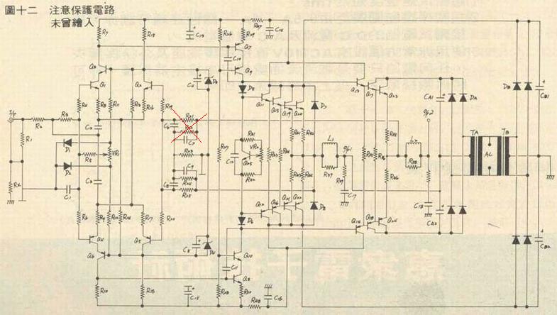

smoking amp,
Something like the amplifier below, but then take away the feedback part from the right hand output stage. Right?
Only make very sure that, unlike the amplifier shown, both output stages are perfectly equal and biased in the same way, otherwise the feedback from the left hand amplifier (the one driving the floating supply) will predistort the drive voltage of the right hand amplifier (the one driving the loudspeaker).
The example in the picture is not usable for this without modification since the left hand amplifier is biased in class B (or C) and the right hand amplifier in class A.
Steven
Hi Steven,
Yes, exactly, just would need to move the global feedback to the first stage controlling the rails. Looks like a clever implementation of a class H amp. where they were able to use the same input and VAS and Vbe biasing even.
If both stages are "exactly" identical parts and class of operation, then the global feedback would pre-distort out the errors in the second stage I guess, since both stages have the same load currents. Only problem is that the speaker currents still affect the global feedback, due to their still passing thru the first stage, so kind of nulls out the whole point of the SPLIF idea I guess. I'm not sure if running the first stage class A too will help, but it sure waists power then.
Don
This is the famous Sano (et al) circuit, patent # 4,115,739, the
point of which is to run the output stage in pure class A
efficiently. It is quite far from the SPLIF concept.

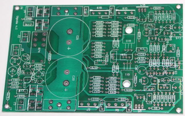

My project alive!
The prototype of amplifier from http://www.diyaudio.com/forums/showthread.php?postid=399274#post399274 is working now.
Bias points are exactly as from PSPICE simulations. There is a 100uF (NP) capacitor in the feedback network, to block DC. The DC at the output is arranged easily and is stable in the range of 0.5 mV.
The current of each power transistors is about 20 – 30 mA.
Here how the pcb looks like:
