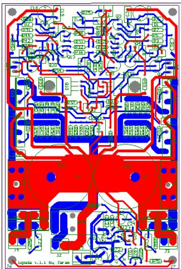

Hi Jarek,
your PCB looks quite nice, especially the star-earth looked fancy with their many branches on your PCB, techno-visually!
May I ask where did you purchase your PCB's, if so, how many and for what price did you get them?
btw, what's the dimension of your PCB?
Cheers Michael

jarek said:jmateus,
The double sided pcb is my own design in Protel. If you want I will sent to you an .pcb file.
The dimension is 150 mm x 100 mm

Ultima,
Yes, I purchased my pcb
I don't know if this satisfy you but it was at http://www.drukowane.pl/ (sorry only in Polish). I sent them a .pcb file and after a week got the pcbs.
I bought pcbs for about 8 E each plus 20 E for setup production.

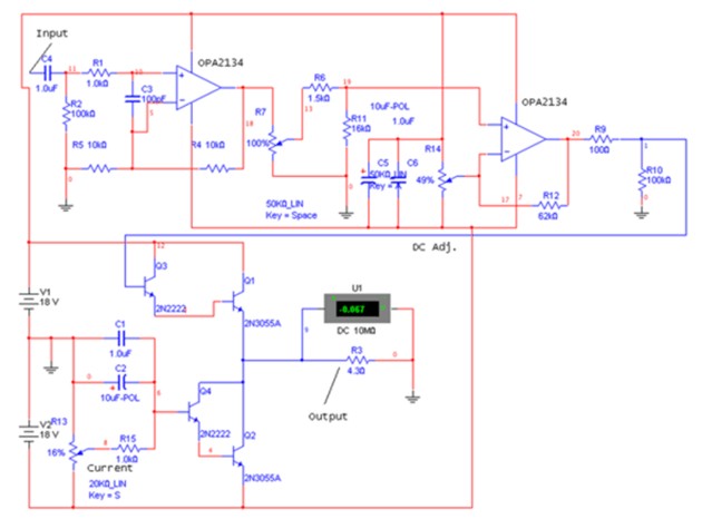

I have built this amp without any feedback except the vas stage. The DC offset on the VAS stage needs Zener stability around the Pot. If interesting I can send the last version of the amp. It sounds nice. The power supply is 12V/10ah battery. I plug it in directly to my DAC.
