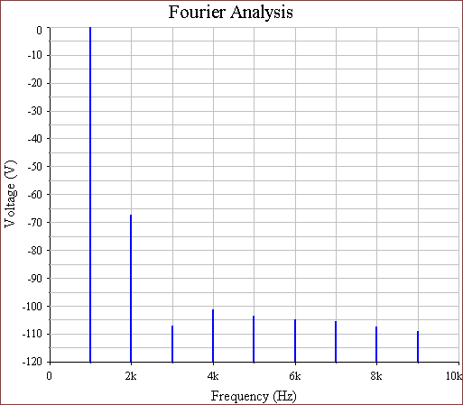

And now I have started my investigations
and design of zero feedback amplifier stage
The Fourier analysis in my Attachment shows interesting things!
Harmonics:
2nd: -067 dB
3rd: -107 dB
4th: -101
5th: -104
6th: -105
7th: -106 dB
What is great, is the 3rd is -40dB from 2nd!!!
😎 This is extraordinary 😎
I think I have never seen anything like it .....
Set up. 1 kHz sinus.
One 2SK170GR in a very special 'lineup' circuit does the voltage gain.
Gain is +12dB. Set by 2 resistances.
Input 1 Vrms, Input impedance 100kOhm.
Output by a 2SK170 buffer, resistor biased
and output 4 Vrms into one 4k7 load.
I will continue to refine this circuit.
Then I be back with more details.
As you understand it is a line preamplifier.
lineup
