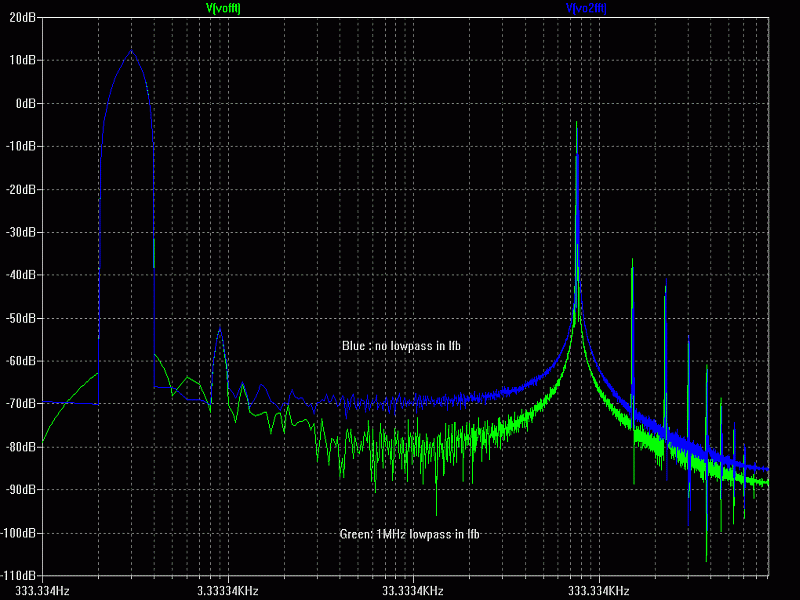

You're right that simulation is slow and then it's not accurate even at small time steps. However you can do a relative comparison of the distortion, I think.
I agree!
snip
When I add additionally feedback arround a switching amplifier, I place a sinus generator at the output and mesure how well it's attenuated compared to before adding feedback. In that way I can mesure the relative improvement (you really need a small time step and a long simulation time to see the difference in THD).
Yes, to inject a current in the output is useful. In this case often the amp internally don´t need to do big voltage excursions.
So I normally use this test "later".
snip
Often things turn out differently than I'd expected.
How true:cannotbe:
snip
From observation it seams that it's the ratio between the openloop gain at the oscillation frequency and the openloop gain at a given audible frequency that determines the attenuation of the sinus disturbance.
I simply don´t know!
My "working-style" is more like the experimenter : I try in a short time many possibilities and observe "what happens" and get so a better idea how it works. So, with pwm-amps in a simulator I get really a problem because I had to wait too long for that "what happens":bawling:
For "learning" I download from the Yahoo-group "LTSputil" This programm can merge e.g. FFT files. It "costs" me hours to learn to use it, but at least I use it to compare what "happens" when I put a lowpass in one leg of the current-fb.
I wish all a nice day, I had to continue my work (for money....I will hope😀 )
Regards
Heinz!

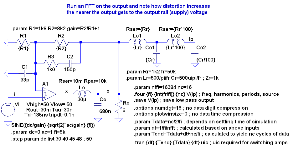

Originally posted by Portlandmike
Also, has anyone looked at, gee, don't really know what to call it, but I think it would be called current mode hysteretic. Its similar to the scheme for desktop CPU power that's floated to the top for its superior transient response.
I haven't looked at it for a long time, and don't have access to the Intel book anymore, but it was very fast, and pretty simple as I recall.
Ever heard of something similar for class D?
I guess you haven't read very much of this thread. 🙂
That was very much a topic of discussion.  Thanks to an idea I got over on the LTspice Yahoo group, I've gotten better at setting up simulations for maximum FFT and DFT (.four) resolution and have been able to compare the distortion performance of an ideal UcD design with a smallish 5kHz test signal while under varying degrees of dc bias (none to nearly railed) against a hysteretic, constant frequency ideal leapfrog (current mode control) design under the same conditions.
The UcD seems to suffer increasing distortion, including nasty even harmonics, as the dc level of the output gets nearer to the rail.  This seems primarily due to frequency droop.  Not surprisingly, the constant frequency design seems to do quite a bit better in this regard - about 4 to 5 times better (so maybe the UcD modulation scheme actually is less than optimum after all).
:angel: Or maybe I've made a mistake somewhere (I'll try to post the details of the analysis this weekend).
Regards -- analogspiceman

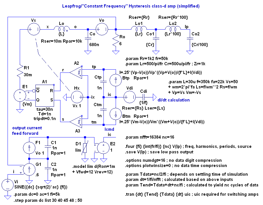

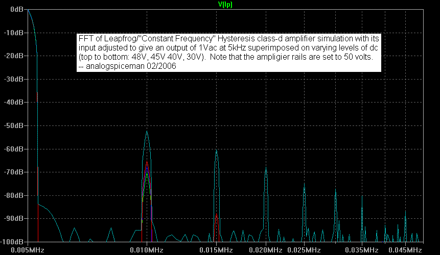

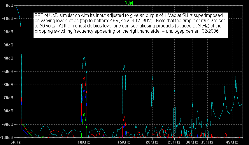

Producing the attached output FFT takes about 5 minutes on my wife's Pentium M 1.7 laptop (my old Pentium II 266 can't handle it). :xeye:
Here is a portion of the SPICE log file with the .four (DFT) data:
.step dc=30
DC component:29.2201
Total Harmonic Distortion: 0.009091%
.step dc=40
DC component:38.9236
Total Harmonic Distortion: 0.072294%
.step dc=45
DC component:43.7104
Total Harmonic Distortion: 0.220647%
.step dc=48
DC component:46.5436
Total Harmonic Distortion: 1.416930%
Total elapsed time: 252.743 seconds.
- - - - Here is a related post from the LTspice Yahoo group - - - -

I followed the link but must be missing something because I don't understand why the UcD180 topology wouldn't naturally reject power supply noise.  In the interest of speed and accuracy, my FFT simulation doesn't allow for dynamic variations in the power supplies, but it wouldn't be difficult to add it in (just have the comparator drive a pair of voltage controlled switches).
By the way, here's a gif of the simplified UcD schematic that was used to generate the FFT. - a.s.

analogspiceman said:
...The UcD seems to suffer increasing distortion, including nasty even harmonics, as the dc level of the output gets nearer to the rail.  This seems primarily due to frequency droop.  Not surprisingly, the constant frequency design seems to do quite a bit better in this regard - about 4 to 5 times better (so maybe the UcD modulation scheme actually is less than optimum after all).
Your work here is great.
What do you mean by "nasy even harmonics".
When I'm looking at amp distoriton, even's up to the forth, and maybe 6th can be ignored.
Were they monotonic, or was it a picket fence. Of coarse, this will all be obvious when you post, so I can wait. 🙂
It would be interesting to see a bridged UcD, one comparator, bridged fets. Bridge designs cancel even's I believe.
On your comment about the distortion being mostly due to the frequency shift, that's interesting. I've been simulating differnt modulators with complex poles and zeros to make the loop less insensitive to this. I did this awhile back, but thought maybe this wouldn't help since lower frequency in my experience ment less distortion becuase of less error pulses.... but the UcD driver topology seems to minimize this affect, so maybe it is an issue.
Oh, and about not reading the thread very well. Your correct on this, but what I I recall on the PC supply topology isn't was it used a sense resistor, and it was multiphase. It wasn't similar on many counts to the paper that started the thread. It was a National design for IMVP, but very similar to Sipex, or Semtech, can't remember which on. None are avialable to the non-intel client, but NSC got out of this, so maybe I can get a schematic.
Mike
Attached to this post should be a gif of the LTspice schematic that generated the above FFT data.  The design is highly idealized to capture the maximum potential of the topology and to increase simulation speed.  In many places current sources paralleled with 1 ohm and 1nF have been used to enhance convergence performance of the spice engine (the 1 ohm makes the current sources functionally equivalent to voltage sources). – a.s.
