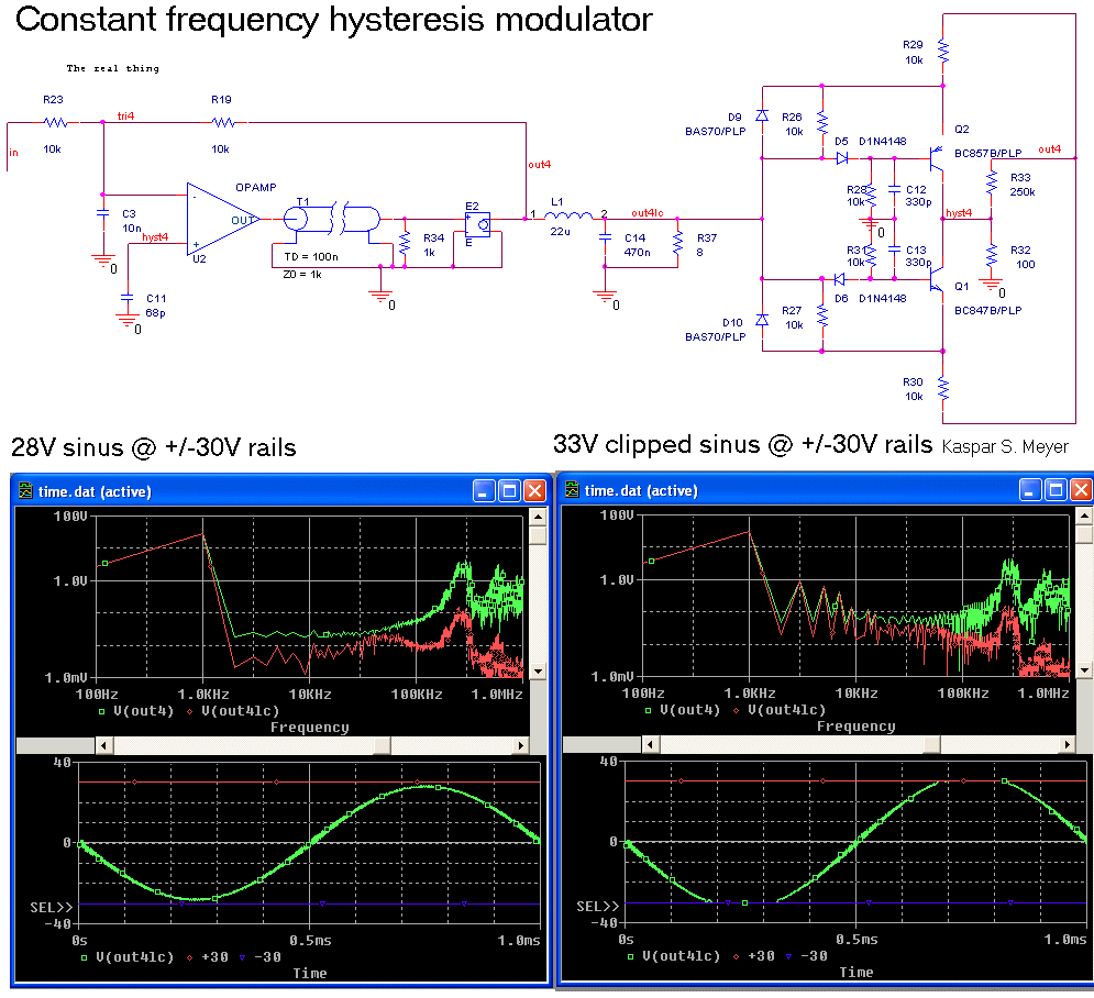

I made this yesterday. I took a whole day to figure something out that worked fast enough and with a high modulation index. The schottky diodes (bas70) was the solution.
What do you think.

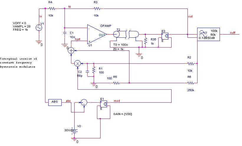

This is what the mathematical model looks like. The performance of the two are identical.
BTW. The frequency is actually not constant. I incresses and then it falls a bit as function of modulation. I decrease the hysteresis voltage proportional with the modulation index. In a normal hysteresis modulator the frequency falls by 1-M^2. This indicates that the hysteresis voltage shouldn't decrease as a dicret function of modulation in a real constant hysteresis modulator.
Fainally the delay messes things up a bit.
Originally posted by sovadk
I can do it without a multiplier. The circuit does exactly the same as an multiplier would have done.
What do you think?
I think it looks promising. 🙂 At least at first blush, it seems to be realizable, repeatable and reasonably accurate for the application.
BTW, the frequency is actually not constant. It increases and then it falls a bit as function of modulation. I decrease the hysteresis voltage proportional with the modulation index. In a normal hysteresis modulator the frequency falls by 1-M^2. This indicates that the hysteresis voltage shouldn't decrease as a discrete function of modulation in a real constant hysteresis modulator.
Finally the delay messes things up a bit.
Also, a fast moving input that changes significantly during the switching period can be a source of error (one that can be nulled - to a first order - by summing in an appropriate di/dt term).
By quasi-integrating switching stage output voltage, your circuit generates an analog of inductor current. But it tracks neither the low frequency (i.e. dc) part of current nor current shifts due to inductance changes (e.g. saturation), so it is useless for current limiting and/or overcurrent protection. It is extremely simple, however, and probably good enough for many applications. 🙂
Rather than compensate the plant by inferring its state, I favor going to the trouble to observe its actual state and using that for compensation. That way, when things limit, saturate, or otherwise go nonlinear, errors don't build up between the actual plant state and its analog (no rail sticking, etc.). That is one of the subtle advantages of leapfrog control. (Did you ever read that thread?)
Earlier in this thread, I compared Bruno's circuit to its closest linear counterpart as a function of modulation depth. At low levels the two were identical, but, near the rails, nonlinear effects (in no small part due to frequency droop) caused significant errors. I don't know how audible such behavior is, but it would be very interesting to see if any other class-d topology could do better. A combination of constant frequency hysteresis and leapfrog control might be a good candidate for such a contest (I have a feeling that just the leapfrog method combined with UcD style phase shift control might do noticeably better in this regard - maybe this weekend, eh?).

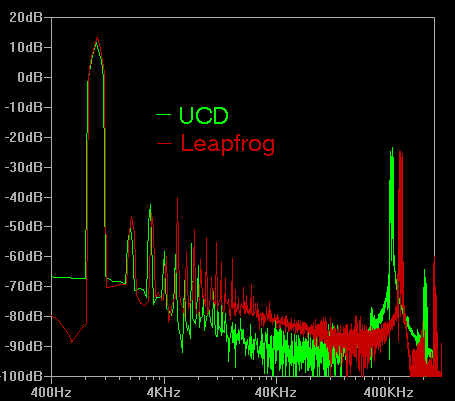

I that thread of your's, IVX said something about the distortion beeing 0.2% with current sense compared to 0.02% for a UCD style topology. So I did a simulation on those two based on classd_leapfrog_ucd.zip. This is the result (attached).
I does look like the leapfrog version distorts more. I'm pritty sure that i hasn't got anything to do with the topology, but more the implementation.
You're sensing not only the inductor current, but also the current everything else draws. Also the linearty of the actual current sense configuration might be of a concern.
