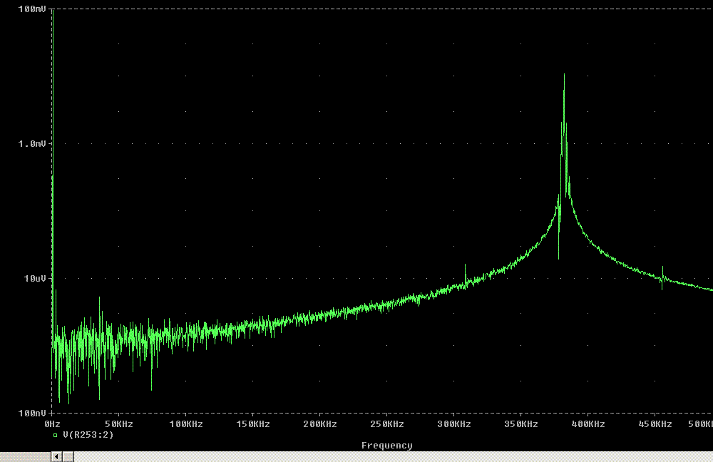

Here one can see the output spectrum when driven with a sinusoid at 20 dB below max input voltage.
The residual of the carrier can be clearly seen (between 350 and 400 kHz). The 1 kHz line can also be seen, followed to the right by its 3rd order harmonic (which is more than 80 dB down).
THD is remarkably rising with in creasing input signal level however. But it looks as if this simple circuit behaves quite well.
But it could be better and it lacks flexibility in terms of free choice of loop-gain oscillation frequency and overall gain. So I went further and developped a circuit that is a little more refined.

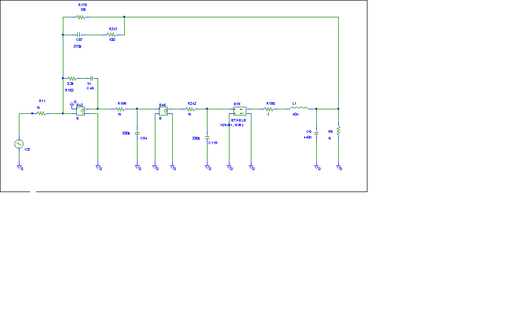

The phase-shifter is now consisting of an integrator (= always 90 deg phaseshift) followed by a 2nd order lowpass. This lowpass has also 90 degrees phaseshift at its pole frequency. A 1st order allpass could also be used - which could be implemented veeeeeery cheaply - but I would be reluctant to do so in practice. I simulated with a Q of 0.5 and 1 both "worked" fine but showed slightly different properties. The example shows two 1st order lowpasses decoupled with a buffer. A Sallen-Key topology would also work. Even a fully passive lowpass would do. An even higher filter-order could be used but I don't see any advantage in doing so.
Also higher order integration could be used to further reduce THD. But they were detrimental to load independancy (which is very good with the single-loop topology) in my simulations.
In order to incorporate the output filter a PID is used instead of a simple integrator.
At an output amplitude of 10 % below maximum the switching frequency comes down to 0.5 times the idle freuency approx. This looks a little much but is still less than some hysteresis controllers and definitely better than the Tripath amps whose switching frequency varies by several octaves. The frequency variation can be minimised with an easy and cheap trick. This also improves THD at high levels at the cost of low level THD performance.
I will post some simulation results later on.
Have fun !
Charles

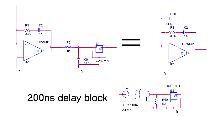

Charles I've attached a little simplification to your schematic, which btw works very well. I'm working on adding more feedback to it, so far I've achived ~20dB better supression of disturbances @10kHz.
I think you should add a delay to your design, right from the start. You probably know how to do this, but for all you other guys it's shown in the attachment.
This simplification would indeed make sense for a production unit ! For fiddling around with prototypes seperate filters might be more convenient.
Regards
Charles

I still owe you the answer how the frequency drift can be minimised. The two phase-shifting LPFs can be made LAG filters by using small resistors (1/10 to 1/4 of the other R) in series of both capacitors. The idle frequency will go up by doing this but that can be compensated for by the use of larger caps.
Regards
Charles
Regards
Charles

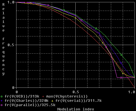

Okey, I've done a simulation on relative carrier frequency vs. modulation index for some different configurations (basic UCD, Charels design, Charles with added serial feedback, Charles with added parralel feedback and ideal hysteresis modulator).
The selfoscillationg designs beats the ideal hysteresis modulator, but it's not astonishing. It can also be seen that the more feedback there is the faster the frequency drops. This is an effect of carrier feedback.

I have no equations, except for the ideal hysteresys modulator. The graphs are made from simulation of the attached orcad schematic.
I've modified the "period()" goal function in PSpice to mesure the frequency after a 40us settle time over 15 periods. The x axis is the dc input voltage to the amplifiers. After calibration the dc_in corresponds to the modulation index.
I've quoted the code for modified period() goal function here:
I would have preferred an analysis in the fourier domain, but PSpice has no features for this. Generally the features for signal analysis are lagging. I wonder why this software is so expensive.
I would like to exploit the auto optimization features of the Orcad suite, but without proper goal functions it seams impossible to me.
I wrote a goal function to detect the frequency where the phase crosses -180 degrees, in order to predict the closed loop oscillation frequnecy. It worked fine, as long as the phase did cross -180 degrees. When it didn't the optimization feature halted. Why! It should just continue with some new random component values.
Does anybody have experience and solutions for this?

sovadk said:Okey, I've done a simulation on relative carrier frequency vs. modulation index for some different configurations (basic UcD, Charles' design, Charles' with added serial feedback, Charles' with added parallel feedback and ideal hysteresis modulator).
The self-oscillating design beats the ideal hysteresis modulator, but it's not astonishing. It can also be seen that the more feedback there is the faster the frequency drops. This is an effect of carrier feedback.
I've always looked at the frequency down-shift as a result of the extra 90 degrees of phase shift (input to output of the power stage) that comes from the asymmetrical switching waveform when operating near the rails. The fundamental Fourier component of the zero-output squarewave has no excess phase shift, so the operating frequency has to be at its highest in order to get the required phase shift around the loop from the delays and linear feedback elements alone.
By the way, there are schemes to stabilize the frequency of hysteresis based amplifiers. These take the voltages around the switching stage and the derivative of the inductor current command as inputs, do some reasonably straightforward math (unfortunately requiring multiplication and division) and come up with dynamically varying hysteresis thresholds. I've made up an LTspice simulation (signal math is easy) that seems to stabilize operating frequency rather well. I'm hoping to get the time to wrap the rest of an amplifier around it and see if it: 1) actually seems to work; and, 2) has any less distortion near the rails than does UcD.
The AIM circuit that started this thread seems to have disappointing load dependence. Perhaps the original author would care to comment.

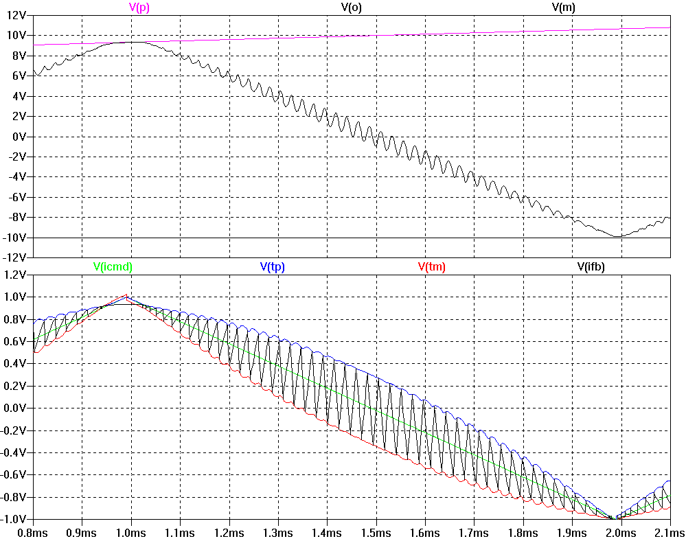

Okay, an LTspice simulation output plot demonstrating this control scheme should now be attached. 🙂
In the top window are the rail voltages (positive rail is ramping slightly) and the output voltage (note that voltage is not the controlled quantity - current is). The bottom window shows the current through the output inductor (Ifb), the current command and the dynamically varying plus and minus hysteresis limits. Frequency gets a little weird right around the rails but is otherwise fairly constant.
It is important to note that there is no voltage feedback. As the AIM guys point out, when this outer loop is closed, the switching ripple that shows up in the current command may completely distort or disrupt the expected operation of the current loop. Perhaps AIM style feedback would cure this, or perhaps it will not be a problem with leapfrog style feedback (or a combo of these). Hope I find the time to work on it this weekend.
The positive delta hysteresis limit equation: V=.5*(V(p,o)/V(p,m))*(V(o,m)/{f*L}+I(Vdi)) ; p & m are rails, o is output
And the negative: V=.5*V(o,m)/V(p,m)*(V(p,o)/{f*L}-I(Vdi)) ; p & m are rails, o is output
Regards -- analogspiceman
