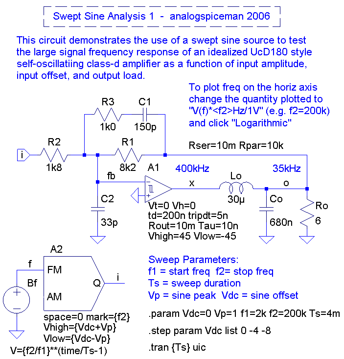

Have you ever examined the consistency of the small signal, high frequency square wave response (say a couple of volts peak at 10kHz) of your UcD design when summed with a large signal, low frequency triangle wave (say nearly rail to rail at 50 hertz or so)? This approximates the small treble riding on big bass of real music, but with a signal much more palatable to the "eye analyzer"
...Regards -- analogspiceman
That's been an interesting simulation as well. Seems the gain of the high frequency square wave is modulated with the increasing inductor ripple. Doesn't seem like an impossible fix.
Chris

Spice can be used on many levels to analyze and design class-d amplifiers. Simulating to the component level is probably the most popular approach. This "shotgun" attempt to construct an electronic breadboard usually runs very slowly (sometimes not at all) and often ends up far from reality due to the inaccuracy of component models. I suspect this design approach is most often used in place of understanding rather than to enhance it.
In my opinion, spice is best targeted to specific design tasks, rather than trying to hit them all at once. For example, one could examine the problem of possible power supply pumping, where the amplifier is modeled without any switching at all and the only "class-d" aspect that is modeled is it's lossless nature (thus, it transfers reactive load power to the supplies).
For all the LTspice aficionados out there, here are my recommendations of how best to use LTspice to optimize the feedback and control portions of your self-oscillating class-d designs.
- Don't run a full up simulation for this purpose - it just greatly increases run times and adds little of value to the optimization process.
- But do use the measured (or full up simulation) power stage delay as a realistic value to be entered as the delay parameter in the simplified power stage (explained below).
The power stage is essentially modeled as a power comparator with delay. Introducing a realistic delay is critical for predicting self oscillation frequency accurately. The diffschmitbuf A-device, one of LTspice's custom model types, is suited perfectly to this purpose (it even looks like a comparator). But first it must be set up by entering the following parameters (right mouse click over the device):
- Vt=0 Vh=0 ; sets input threshold and hysteresis voltage to zero to model an ideal comparator characteristic.
- Td=<delay> tripdt=1ns to Td ; sets delay value and accuracy band for switching edges (accurately bracketing transitions is critical for useful THD simulations).
- Vhigh=<+Vs> Vlow=<-Vs> ; sets the output rail voltages.
- Rout=<Rdson> ; typically set to equal output mosfet on-resistance.
- Tau=<Tt> ; transition time constant - set this to about one half the actual output stage 90%/10% transition time.
Note that this A-device does not model power supply interactions at all (not normally of interest during the control loop design phase). Fortunately, this can be added, if desired, at only a small cost to run times. (Do this via a totem pole pair of voltage controlled switch devices tacked onto the output of the A-device.)
Because this ideal A-device has infinite gain, LTspice will not be able to find an initial linear operating point, so "Skip Initial Operating Point Solution" (uic) must be specified in the Simulation Command panel.
- If you are comfortable with the frequency domain, an ac analysis can be used to set the component values in the feedback network. For this type of analysis replace the A-device with a voltage source (dc=0) followed by an Ideal Losses Transmission Line (tline) as a delay generator. The voltage source should have its small signal ac amplitude set to 1 (advanced menu) and its series resistance set to mosfet Rdson. For the tline, set Td to the power stage delay time and set Zo to mosfet Rdson.
If you are working with a UcD style feedback network, this analysis can be very helpful for ensuring that the lead network in the feedback path provides enough phase lead margin around the resonant point of the LC output filter operating into an open circuit.
The attached image show an example of the above applied to an LTspice analysis of a UcD style amplifier.
