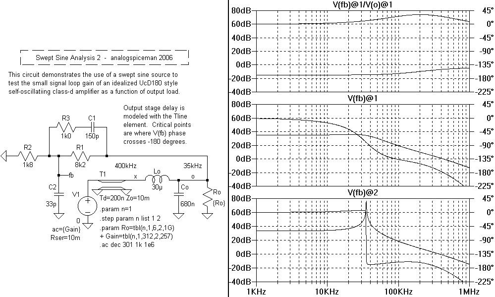

Attached is the output plot of the swept sine analysis posted earlier in this thread. Note how the dc level modulates the frequency response.
Regards -- analogspiceman

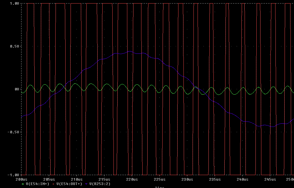

Here's an ac analysis for the component values in the feedback network of a UcD style design. As mentioned previously, this analysis can be very helpful for ensuring that the lead network in the feedback path provides enough phase lead margin around the resonant point of the LC output filter operating into an open circuit. Interestingly, most of the lead occurs past the sudden phase shift of resonance.

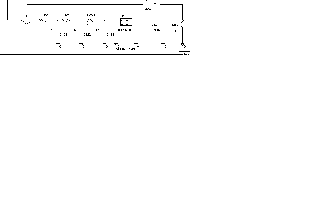

The attached image show an example of the above applied to an LTspice analysis of a UcD style amplifier.
Top Trace: the phase lead network response
Middle Trace: loop gain with nominal load (6 ohms)
Bottom Trace: open circuit loop gain

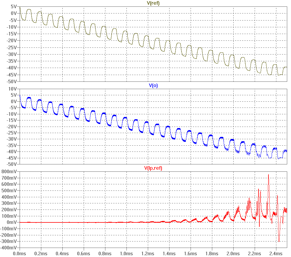

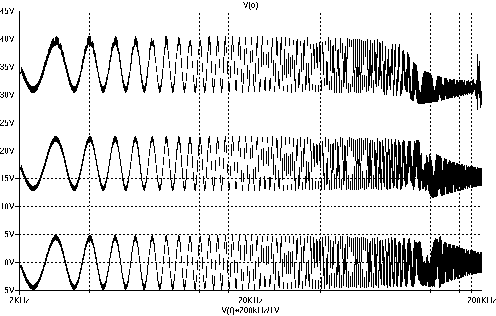

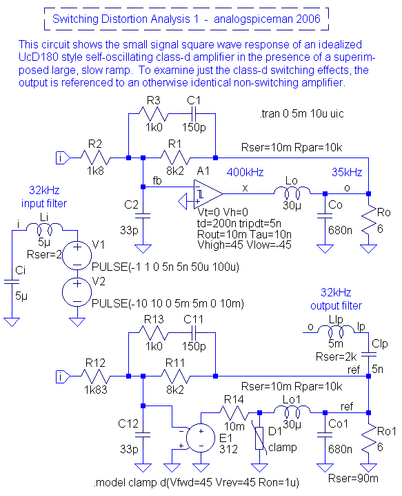

Originally posted by analogspiceman
Have you ever examined the consistency of the small signal, high frequency square wave response (say a couple of volts peak at 10kHz) of your UcD design when summed with a large signal, low frequency triangle wave (say nearly rail to rail at 50 hertz or so)? This approximates the small treble riding on big bass of real music, but with a signal much more palatable to the "eye analyzer"
Okay, here is a simulation that does just that. It shows the small signal (10kHz) square wave response of an idealized UcD180 style self-oscillating class-d amplifier in the presence of a superimposed large (rail-to-rail), slow triangle wave. To give the amplifier a break and show only its audio band response, signals have been band limited to 32kHz (both the input waveform and the output switching distortion products are low pass filtered with a 2-pole, zero overshoot LCR section).
To make things really interesting, I have attempted to examine just the class-d switching effects with everything else subtracted out. An otherwise identical non-switching amplifier has been constructed and the outputs of both are differenced against each other and examined with switching ripple blocked out. Both amplifiers have the same gain and saturation characteristics, and both have nearly identical frequency shaping networks (the linear amp has no delay a very slight high frequency lead network to provide stability and keep it from switching). If I've set up the simulation correctly, the only signals left in the difference plots are the switching-caused in-band audio artifacts.
Should be interesting, yes?
First the simulation schematic...
[...] the only signals left in the difference plots are the switching-caused in-band audio artifacts.
The top trace is the output of the non-switching amplifier (note that it saturates to the rail very much like the UcD output below it).
The middle trace is the UcD amplifier. It looks pretty clean except near the rails where the switching frequency becomes irregular.
The bottom trace is the audio artifact taken from the difference between the two amplifier outputs. For signals not too near the rails, there is very little distortion, but things do seem to break up a little bit near the edges, eh?

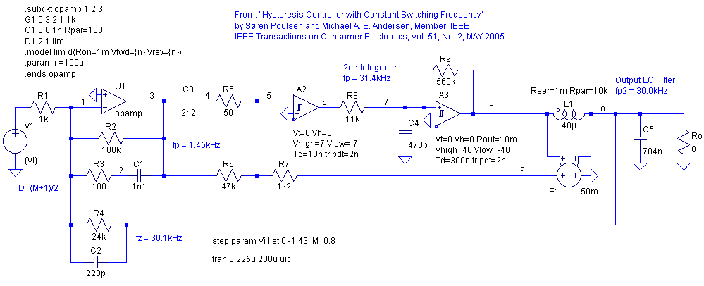

analogspiceman[/i] [B] If you mean this paper said:
If I'm not mistaken you are the primary author of the papers I referenced in the beginning of this thread. If so, I would very much appreciate it if you would email me the values used in the unreadable simulation schematics included in your papers that I referenced. You must have noticed that Bruno more or less blew off the claim made in the paper with regard to the superiority of a linearized hysteresis self oscillating class d amplifier as compared to the UcD style class d circuit. I would like to attempt to verify this claim using LTspice (hence the need for the values).
Never mind about emailing the values - Jaka Racman had access to a copy with better detail than the one I got from the IEEE, and he was kind enough to update me with the previously unreadable information. 🙂 Thanks Jaka
I still had to guess at several pieces to the puzzle, though. The inductor sense winding was not specified, the comparator and output stage voltage saturation voltages were missing as were their delay times. Oh, and the load.
The following values yield a fair match to the waveforms of your paper: an 8 ohm load, a 20 to 1 current transformer turns ratio (inverting), +/- 7 and 40 volts for the saturation levels, and 10 and 300ns for the comparator and output stage delays, respectively. (Without a realistic output stage delay the circuit doesn't seem to work at all.)
How'd I do, guess-wise? 🙂 (Please feel free to jump right in and correct me.)
Here's the simulation schematic ...
Hi spiceman,
I had no idea the circuit you were after was on that paper. The values in my copy are very readable as well!
Looking forward to your results!

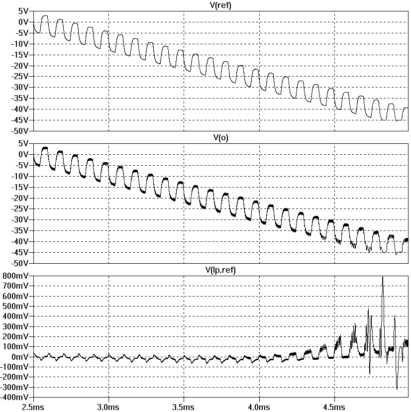

I inadvertently forgot to reduce the effective loop gain of the non switching amplifier reference standard in the above comparison.
The UcD design actually looks significantly better than indicated above. When I get the time for it I will repost the correct results plus some more interesting data.
Regards and apologies to Bruno & Co. -- analogspiceman

Originally posted by phase_accurate
How does the double-loop topology above simulate in terms of distortion ?
No idea ... yet. My first goal is to match the results of the original paper. 😀
Only then can I play with the circuit to figure out the fundamental, key characteristics to its function, after which I can design a simplified version that more directly expresses the essence of that function. This will serve both a proof of understanding and allow me to compare its idealized version to that of the UcD style design.
If the soren posting here is the original paper's author, I really hope he joins in the fun.
Here's a zipped version of the LTspice .asc schematic file:
Okay, gain has been reduced from 257 to 168 and the rest of the circuit is now exactly the same as the switching version (200ns delay back in and output zero lead network out).
Except near the rails, there is virtually no difference between the fully linear, non-switching amplifier and its UcD class-d brother.

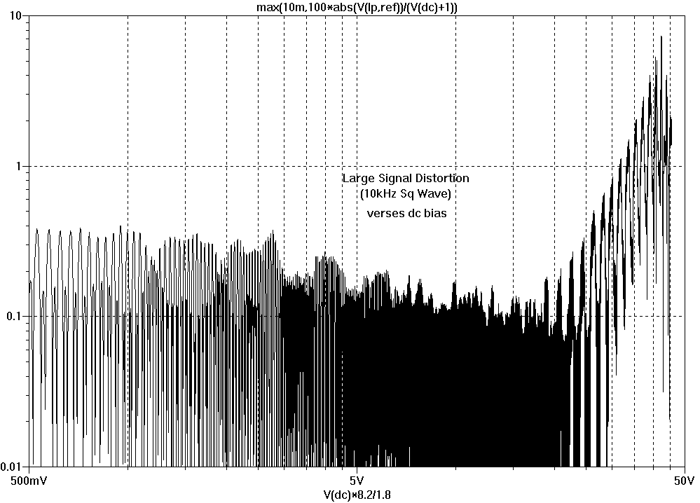

Just to show the value of the presentation of data, I have reformatted the above to resemble a THD vs. Power curve. "Distortion" is taken as the absolute value of the residual difference signal divided by the dc bias level (plus one volt because of the 1Vp squarewave) and dc bias is displayed against a logarithmic x-axis (to scale like power).
I wonder how this compares to the real UcD 180's small signal distortion curve at 10kHz?
Distortion plot attached ...

Below one could see the most basic implementation of the idea. It is a classic phase-shift oscillator with an inverting loop and a high- or low- passfilter as phase shifter. For our purpose a lowpass topology is advisible !😉
The gain-stage (Etable) has a gain of 100 and it saturates at + and - 1 Volt. The inversion is made with the subtracting stage - which is also used for the superposition of our audio signal.
Regards
Charles
Regards
Charles
