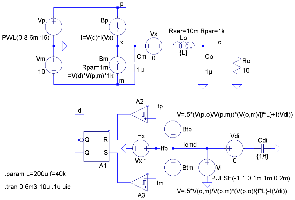

Nice simulation there analogspiceman. Is the AIM attachment from post #72 up to date (it's called aim1.zip)?
Regards
Kaspar
Regards
Kaspar
sovadk said:Nice simulation there analogspiceman. Is the AIM attachment from post #72 up to date (it's called aim1.zip)?
Yes, but be sure to read and make the changes mentioned in post #92.
By the way, here is the LTspice shematic that goes along with the frequency stabilized hysteresis plot from post #99.
Regards -- analogspiceman
