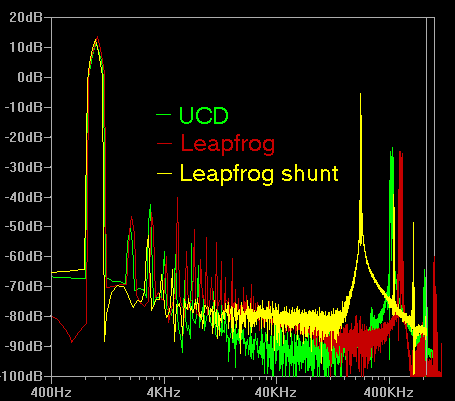

The shuted leapfrog does seam to have less distortion. The carrier frequency is lower however -> less distortion due from imperfect switching but also less feedback.
Immediately leapfrog shunted seams to outperform UCD in distortion.
The only problem is that you need to amplify the voltage across the current sense resistor, so an opamp with a very high GBW and low noise is needed.
As I said ealrier, I think that sensing the bootstrap current, comperator current .... in addition to the inductor current, is what causes the distortion in analogspicemans leapfrog implementation.

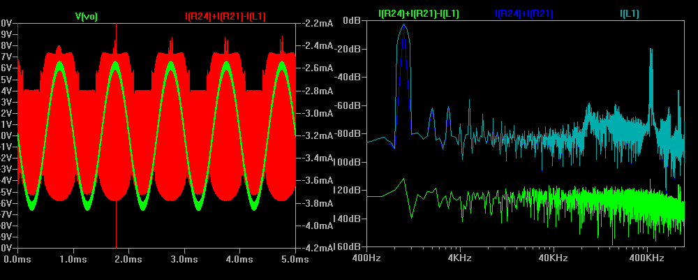

I might have to take that one back. Although the attachment shows a difference in the inductor current and the sum of the currents in R21 and R24 (the current sense resistors), the FFT plots shows no alerting frequency components.
I must be the current sense circuit that causes the additional distortion.
Simulation based on analogspicemans leapfrog curciut.
This can be the reason! ?
Yes, or one could use a small (R20) currenttransformer for Ic8!
Yes and also AS and think about , but...see Your next post...
.....I try it separately and get at 10kHz only 0.02% distortion...!
I put in one leg of the current-fb a 1MHz lowpass ("equivalent to C7") : it seems that the harmonics get a bit smaller,
may be You try it also with a deeper frequency cutoff?

Please, can You explain how to put 3 ffts to one pic?
Regards
Heinz!
Have you ever heard about Paint Shop Pro? 🙂 LTspice lacks some options. The fact that you can't import data from an old simulation is one. I also bothers me that you can't copy from one schematic to another.
I prefer Orcad PSpice for simulations.
You're right that simulation is slow and then it's not accurate even at small time steps. However you can do a relative comparison of the distortion, I think.
