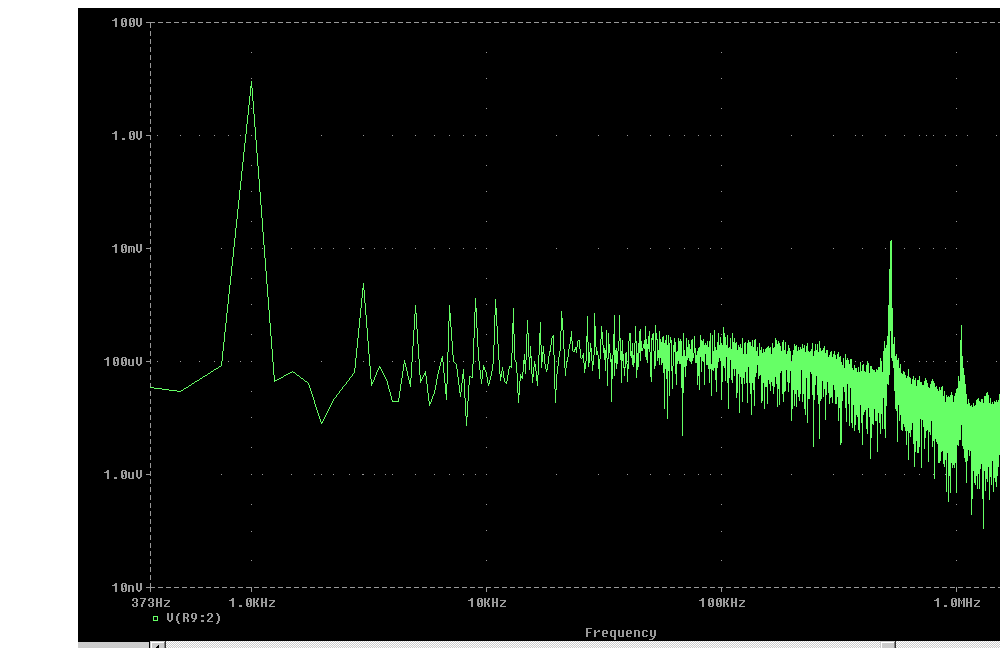

My memory must be playing tricks with me. I now "tested" the topology with a 2nd order allpass once again.
The carrier is indeed very stable (90 % modulation shown !) and k3 for instance is down by about 10 dB. But the spectral distribution of THD looks less nice than the lag filter version.
Regards
Charles

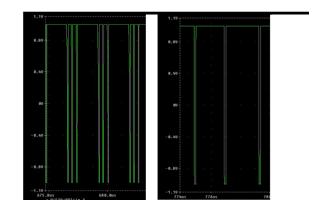

Had a closer look at the bahaviour of the amp with the allpass. While the average switching frequency stayed fairly stable there were some glitches at high modulation depth which I don't like that much.
So it might not be a too good idea to force an amp to switch at a constant frequency by all means.

Originally posted by Charles (phase_accurate)
Had a closer look at the bahaviour of the amp with the all-pass. While the average switching frequency stayed fairly stable there were some glitches at high modulation depth which I don't like that much.
After experimenting a bit with various feedback networks, I've been able to reproduce very nasty glitches at high modulation depth and, what's worse, a time dependent non linear gain characteristic even at relatively non large signals.  Clearly the choice of feedback poles and zeros and their Qs is critical to achieving a balance between distortion from this effect and distortion from frequency droop.  It seems the feedback filters should settle out very nearly within one cycle, something that, as far as I know, is at odds with the high Q networks required to achieve the rapid phase change necessary for minimum shift of the frequency of self oscillation.
This engineering dilemma could be a very interesting optimization problem.  I'm guessing that one could do better than the UcD in that regard (though not by much).
Regards -- analogspiceman
