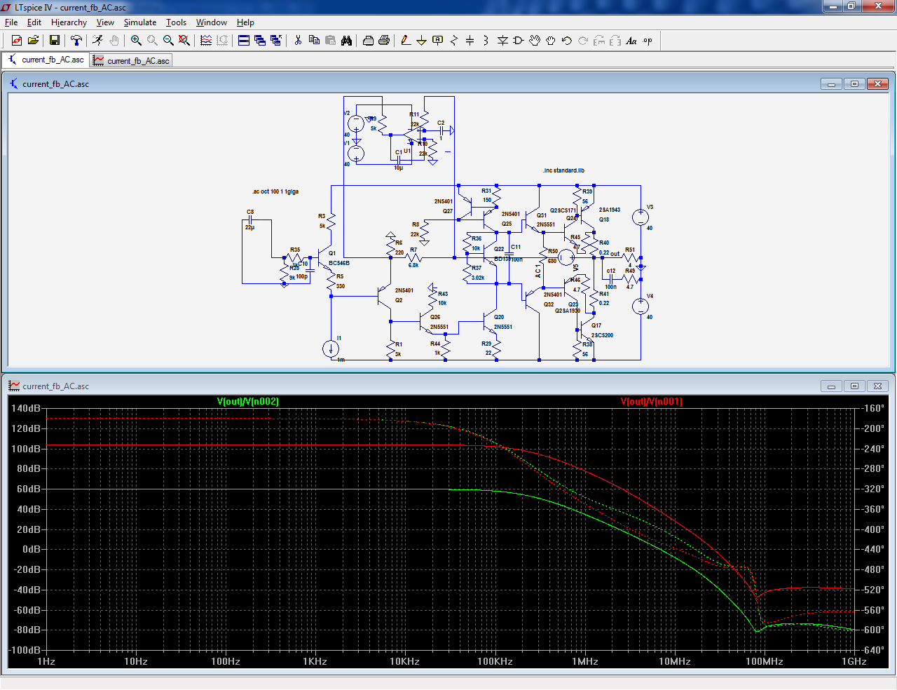

In order to make meaningful and fair comparisons, post the .asc of your CFB:
I will convert it into its exact VFB-dual image

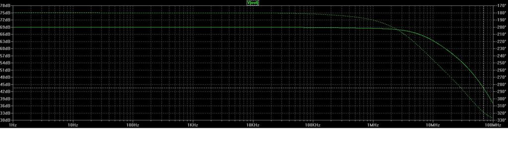

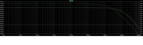

Wow, Catlin, the VFB graph is just wickedly bad compensation overdo, and the CFB is very slightly undercompensated but your RF filter or feedback cap could trim off that slight excess. At least with the CFB there is a tiny excess instead of a severe shortage.
In the case of the CFB, the amp is running faster than the outputs, and the simple fix to align matters is set the amp to match those two curves perfectly, or use a slightly faster output device. With MJL21194, 4mhz, I got Circlophone pushed to 3.5mhz Phase Linear, but any faster amp settings (compensation reductions = faster) made that "exceeding" graph like shown above with more treble in than out. If you don't those two lines on your graph perfectly, treble quality will suffer a bit. The exceeding is a lovely problem to have because the fix is so very simple. Please adjust to fell the amp before exceeding the outputs.
This is an unfair race what with one example having no brakes and the other with the parking brake on. In the case of the VFB, you've got the parking brake on. Some kind of heavy handed compensation overdo mistake on that one. The pre sections are actually trying, but the more it tries to amplify, the worse it gets? I'm not sure what that's for.
Can you say what you mean here ? I see that there are 55 degrees reserve .Minimum 45 are ok but not always the phase reserve it says things about the stability .Also it needs study with square wave response .
For example the "helpful " transitional Miller compensation does not add nothing at the phase reserve but will dramaticaly distort the square wave response with capacitive loading (1uF for example)
But here we are just talking about the CFB vs VFB and the pictures are just for the quality comparision .
And I don't understand why the curve with gain must be on the same place like the one with phase .Maybe you want to say another thing .

The duplicate models of 5401 and 5501 in your library seem to be corrupted, and I had to remove them before being able to run the sim.
Anyway, here are the results.
First, your frequency analysis measures the open loop gain under forced VFB conditions (and extreme ones), which is rather ironical from a CFB proponent.
I made the measurement in the less intrusive, normal way. For a VFB amplifier, it would make little difference, but for a CFB it is essential, otherwise it becomes completely meaningless.
I made the loop gain plot of the complete amplifier, as it is the way the amplifier is supposed to be used.
I also included yours, purely open-loop for reference and comparison (red trace), between the output and the (-) input.
It is obvious that the stability is inadequate, to say the least, but that's not our concern here, and we will not attempt to fix it.

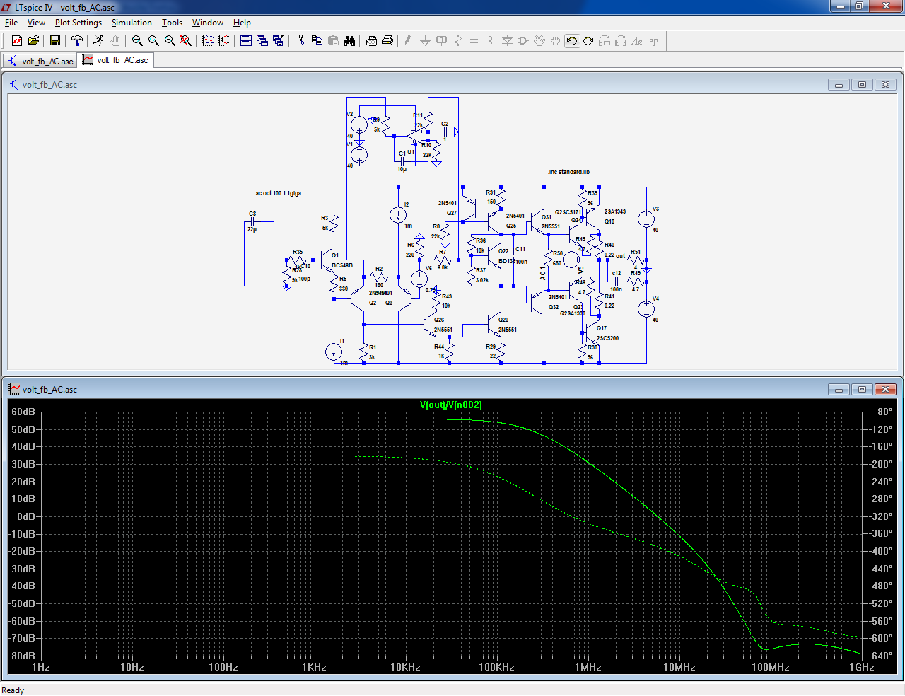

We will just compare the CFB circuit with an equivalent VFB one.
To make the conversion to VFB, we need to make the impedance of the (-) node ~=∞, and equalize the gain for a fair comparison.
That is done with a real follower (not a spice version), a common collector stage. Level shifting is included to compensate for the additional Vbe, but it changes nothing dynamically.
Basically, we see that the outlook is the same, the loop gain is slightly lower because the follower is not actually unity gain, but that is not essential.
Here, the VFB circuit has been tailored to be strictly equivalent to its CFB counterpart, and there is no advantage in doing so: it simply demonstrates the very close equivalence (save 1 or 2° of phase margin, which is already negative here anyway).
We could use the VFB stage to gain some advantage: increase the loop gain, like you did in your analysis, increase the impedance, tailor the compensation, etc.
In short, by degenerating VFB, you can always revert to CFB. But if you cleverly use the additional gain, you can increase the impedance levels, increase the loop gain, etc.
The supplement of gain could easily pose stability problems, but clever compensation techniques, like nesting, TMC, etc, can get you the best of both worlds: stability combined with the highest possible loop gain at all frequencies.

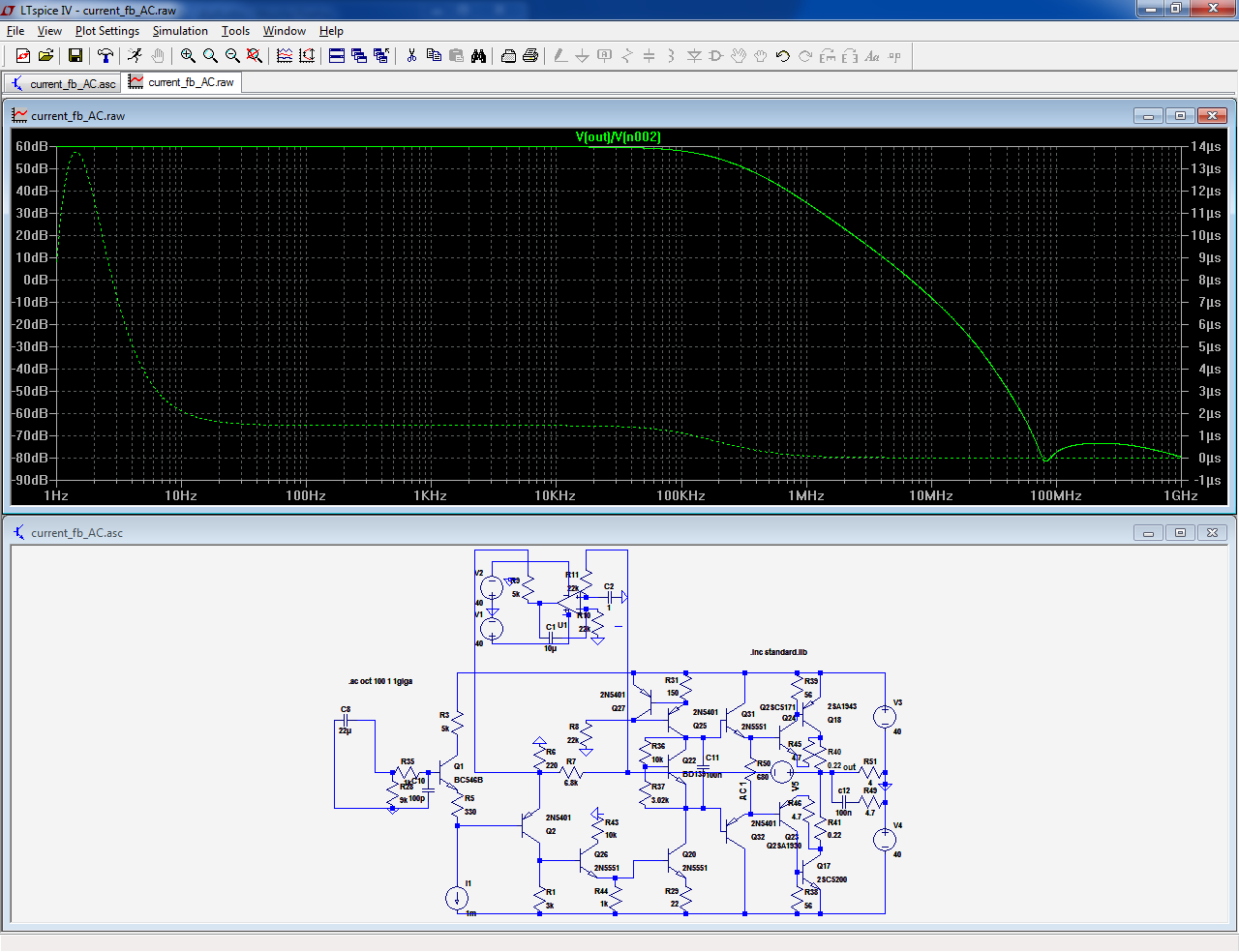

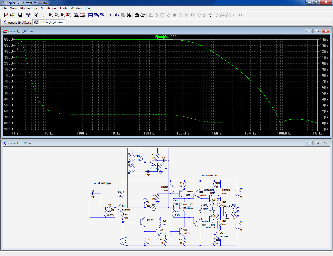

Let us now compare the group delays, since it seems to be the strong point of CFB.
These are the next two pics.
Here again, the values (~1.5µs in the audio band) of the model are copied almost unchanged in the VFB version.
This shows that both topologies can be close equivalents if one chooses to make them so, but it is also possible to use their differences to advantage, when needed

"First, your frequency analysis measures the open loop gain under forced VFB conditions (and extreme ones)" Can you explain ?
Elvee please excuse but your explanations are wrong .
Firstly you analyze the OLG with the AC signal between the output and the negative feedback .The reference for the negative input must be the GND beacuse we transform the voltage in current .If the negative reaction is in current then we should add a current generator but spice don't have such thing and then we shoul transform the V in I .
You missplaced wrong the current source for the differentail input in Vfb .This will do other impedances in the nodes and will give small AC modified behaviour which is wrong .
Also I can show you a real amp CFB schematic has linear phase (0 degrees until 1 MHZ) who has also good phase reserve but you can't show me a VFB with the same phase because it doesn't exist .The theory says so !
You need to compensate it !
Always a Vfb will have one pole at very low F ,even there are no discrete capacitors .But the parasitic/internal Miller capacitor will give the look of my OLG VFB picture . If you use the cascode stage like CFB has, than Miller is not matter anymore .
Can you show a vfb compensated with linear phase ?I guess not ..
The last 2 pictures are the same . Group delays will not be the same when you have a compensated VFB .
