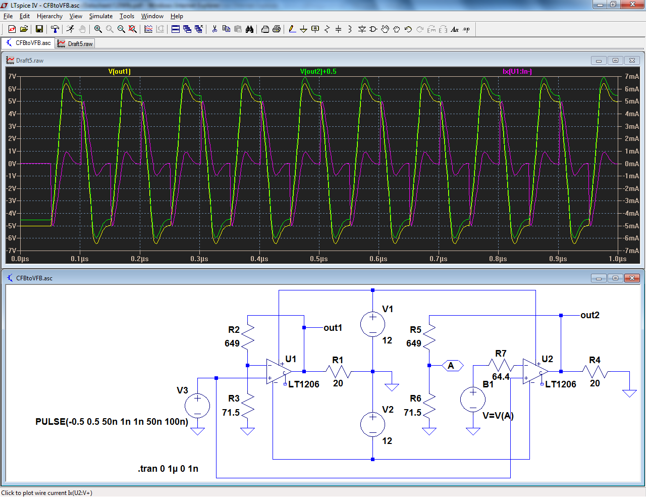

One option here is to take a wide band closed loop amplifier (a good fast opamp will do) and feed this through a low pass filter. It's very easy ten to set the RC time constant and hence slew rate independent of the amplier and to test the results both subjectively and quantitively.
In theory, any CFB amplifier can be converted into a VFB one having at least identical performances.
Could you post a schematic, I dont believe this can happen, at least not at same operating conditions as I mentioned in previous post.
Here is conceptually how you go about it:Could you post a schematic, I dont believe this can happen, at least not at same operating conditions as I mentioned in previous post.
On the left is a normal CFB amplifier having a gain of 20dB.
The yellow trace is the output voltage, and the red one the input current: it is clearly a genuine current mode amplifier.
On the right is the same circuit, converted to VFB. The green trace has voluntarily been shifted by 0.5V, otherwise they are perfectly overlaid and undistinguishable.
To make the C to V conversion, the voltage on the (-) input has been isolated, buffered and applied to the (-) input via a resistor equal to the Thevenin resistance of the feedback network.
The circuit therefore operates perfectly identically to the first one, but there is obviously no current into point A: it has become a VFB.
Of course, in this case the operation is useless, but it was done on purpose to show the equivalence.
Morever, with an integrated amplifier like the LT1206, it makes little sense anyway, but in a discrete circuit, this gives you one more degree of freedom: you can free yourself if you want of the effect of the input current.
