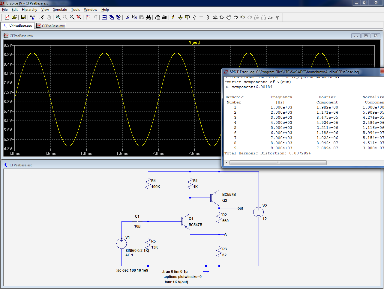

I would like to investigate about the actual/perceived/imagined superiority of current feedback, and possibly to pinpoint what exactly makes it superior (if indeed it actually is).
As a study subject, I propose to use a very simple, quasi-canonical form of a CFB amplifier, the CFP with gain.
The two first pics show the linearity and frequency performances of the circuit.
The interesting thing with the sim is that it allows the transformation of this ideal CFB amp into an identical ideal VFB stage.
That can be done with an arbitrary voltage source (the next two pics).
As could be expected, the linearity has improved thanks to to the increased loop gain, but somewhat more surprisingly the bandwidth also increases.

That is quite surprising: R1 does have a huge impact on many aspects of the circuit, the linearity, loop gain, slew rate etc.
For example if R1 is doubled in the example, from 560 ohm to 1K, the THD is reduced by a factor of ~3.
There are many tradeoffs of impedance, gain, bias currents etc in this circuit, and the value of R1 does have a pivotal role in them

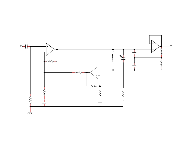

A thing that I have looked at for the LM7171 would look something like this.
This is intended to be a high q bandpass filter/buffer.
The first two devices are connected as a transconductance amplifier to provide high impedance drive to the filter, and the output device is connected as a q multiplier.

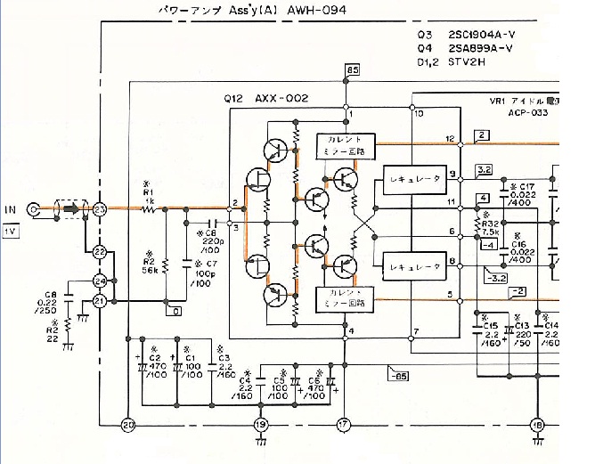

And now for some more interesting news on CFB topologies, hope elvee doesnt mind.
For years me and the world have been under the impression that comlinear was the developer of the famous CFB topology that uses the diamond buffer as input. They also were the first to patent it in 1985 if Im correct and hold more than 20 other patents regarding CFBs.
Yesterday I got proof of what I have been was suspecting for a while now, a Japanese company had a amp on sale in 1980 with that topology and quite surprisingly very advanced form of that topology. Take about two years for development and production and Id guess the topology dates from about 1977. This company is Pioneer. One has to wonder where comlinear got the idea whether themselves or ...... In those days circuit topologies were a sacred secret in japan and its very difficult to find schematics of their amps which were sold only in their homeland.
Here is a preview although I hope to get the rest of the schematic into electronic form.
