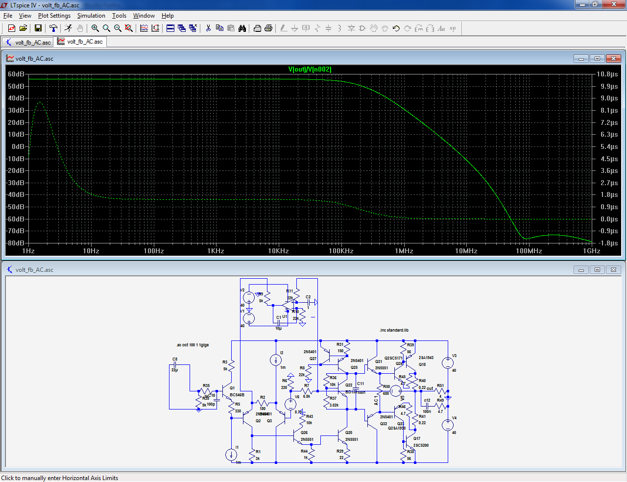

Who said a VFB amplifier must have a classical, non-degenerated LTP at the input?You missplaced wrong the current source for the differentail input in Vfb .This will do other impedances in the nodes and will give small AC modified behaviour which is wrong .
The amplifier has been converted to a VFB one, the (-) input impedance has been raised by a Hfe factor, and the impedance of the FB network has no more influence on the behavior of the amplifier (within reasonable limits).
You could convert the schematic to a more familiar looking one by splitting the 180 ohm into two 90 ohm, but this changes nothing.
The emitter follower could also be replaced by a diamond buffer, thus freeing the amplifier completely from bias current constraints. It would still remain a VFB.
Now the gain is set by the degeneration resistor, R2.
That is basically what I want to show: a CFB amplifier is essentially a degenerated amplifier, it is like adding emitter resistors in the input LTP; additionaly, the tail current can be split and manipulated to remove slew rate constraints
The amplifier you show is not stable without compensation.Also I can show you a real amp CFB schematic has linear phase (0 degrees until 1 MHZ) who has also good phase reserve but you can't show me a VFB with the same phase because it doesn't exist .The theory says so !
You need to compensate it !
Always a Vfb will have one pole at very low F ,even there are no discrete capacitors .But the parasitic/internal Miller capacitor will give the look of my OLG VFB picture . If you use the cascode stage like CFB has, than Miller is not matter anymore .
Can you show a vfb compensated with linear phase ?I guess not ..
0° phase at 1MHz means nothing: what counts is the variation of the group delay as a function of the frequency. We see on the plots that the group delay at 1MHz is indeed very small, but at medium frequencies it increases to 1.5µs. That behavior is worst than an amplifier having a flat group delay of 1.5µs from DC to 1MHz
I mixed up the pics. Here is the correct one.The last 2 pictures are the same . Group delays will not be the same when you have a compensated VFB .
The VFB version does not need more compensation than its CFB counterpart, because it has been designed to mimic exactly its behavior.
Elvee, can you show VFB that is phase linear to at least 1mhz? Now that would convince a few people.

Elvee, I didn't say that those pictures belong to this schematic .
So if you want to see a good CFP schematic with phase reserve I can show you .
The pictures was only to present the diferences between the topologies .
