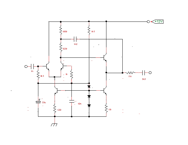

I have not simulated the circuit bellow but it works very well and is for a project that needs a buffer line driver in the 10-20MHz. region
The overall gain is enough just using the common base stage with local feedback and bootstrapping, thus avoiding the problems with common emitter amplifiers.
Since the input and output are emitter followers with current source loads you can look at it as having 100% voltage feedback in these two stages, and feedback across the common base stage base resistor.

The circuit I posted for instance uses a CA3083 transistor array and is currently buffering a 10MHz. crystal oscillator and driving a 50 Ohm line with 500mV. rms.
I could have used a current feedback op amp but I wanted to design a discrete circuit for old times sake, and had a CA3083 on hand.
