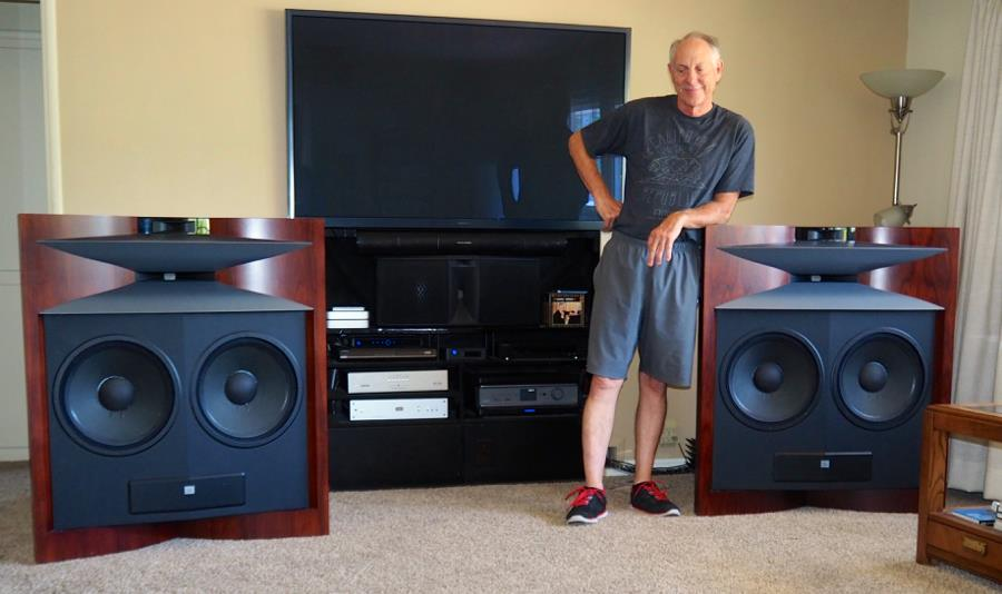

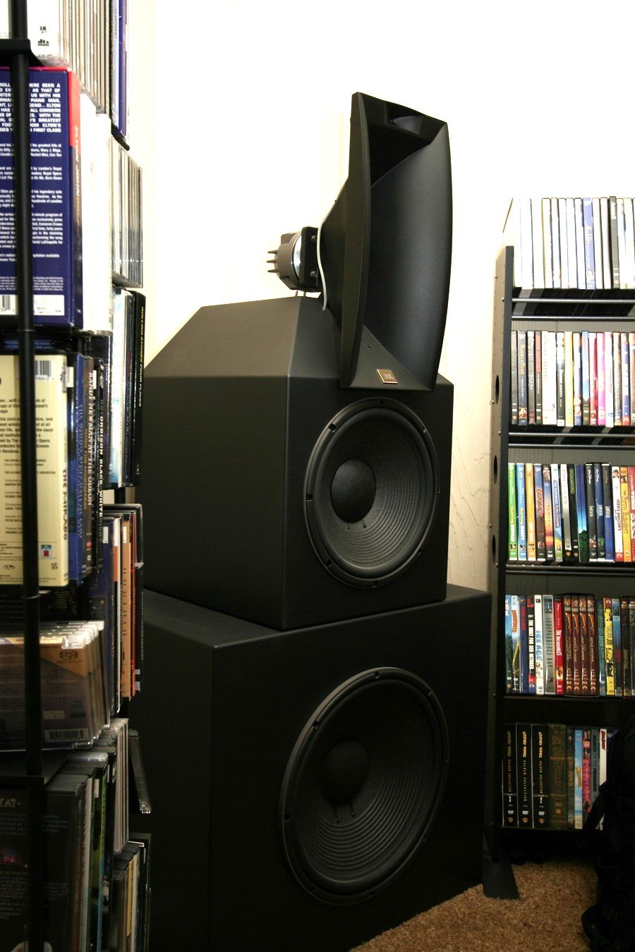

Greg Timbers:
"My system consists of two 15" Alnico woofers with 1" long voice coils in a 1.5" long magnetic gap. The cones are a foam core substrate with paper skins. The woofers are immensely linear and vanishing low in distortion. The HF compression driver uses a 4" Neodymium magnetic circuit with a one-piece 4" pure beryllium diaphragm and surround. The first breakup mode of this diaphragm is around 15 kHz. The UHF driver is a miniature version of the big driver. It uses a 1" diaphragm. Both horns are of the constant directivity nature meaning that their pattern is constant with frequency. The enclosure is around 280 litres and constructed of multiple layers of curved, cored out, and foam filled MDF. It is extensively braced and the upper front baffle actually forms two of the horn surfaces.
The two LF drivers are "combined" into a single driver with the outboard woofer having an active analog 6 dB crossover at about 180 Hz. The HDP4 treats this combination as a single LF driver. The crossovers are 48dB/octave linear-phase at 750 Hz and again at 12 kHz. The completed system has essentially flat response from 20 Hz up to a measured 40 kHz. It should go to about 60 kHz but I can't measure it and the digital signals quit around 48 kHz."
As far as I know he disconnected the tweeters, because he prefers the DD67000s in 2.5 way mode.

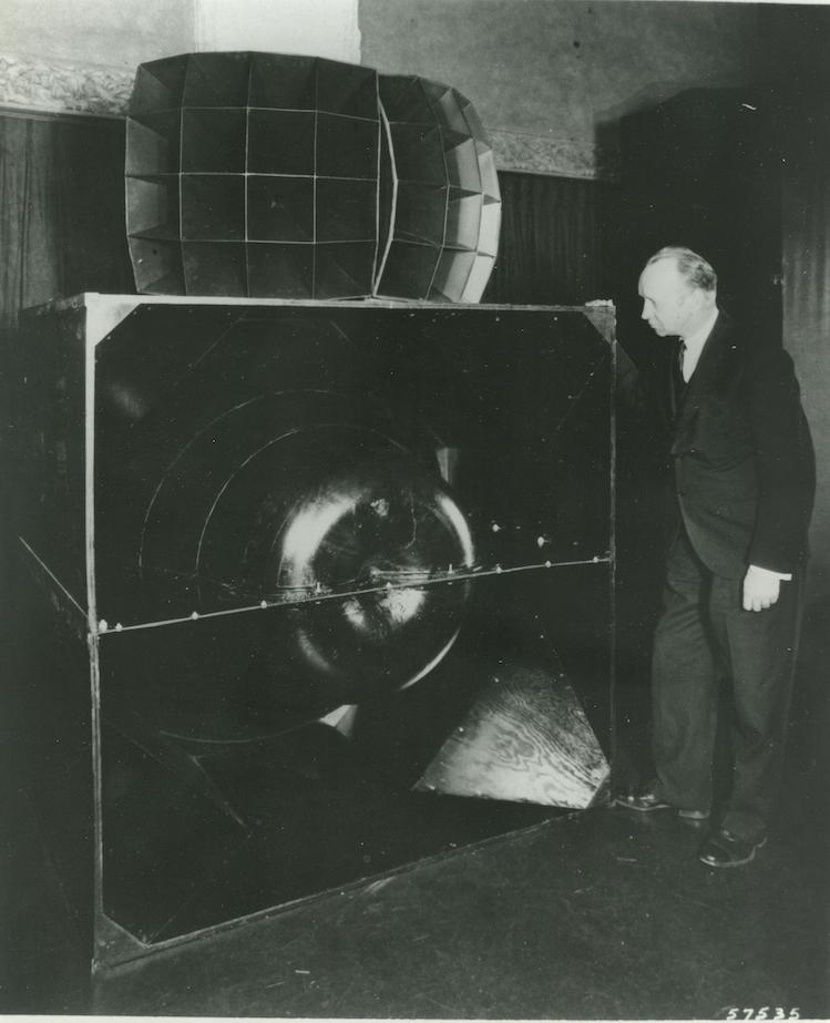

Even 90 years ago, the ojective of the thread title was almost achieved by the Fletcher system (35-15 kHz).
A limiter was used (around 100 dB) to protect the hearing of the audience, but the system could easily reach >120 dB.
View attachment 1440714View attachment 1440715
Re: Wente & Thuras 60° by 120° equal-loudness double-horn near-point-source
(my comments on the Fletcher et al. 1934 Symposium, just above this)
As far as i know, he took apart his DD67000 eventually.
As for running without the 045be in the DD6700 and the other top end JBL consumer products, notice how it is implemented also.
His own horn design, 2,5 way with woofers vertical in a slanted design ala 250ti etc., run through DEQX also.
See Erins audio corner interviews for some detail.

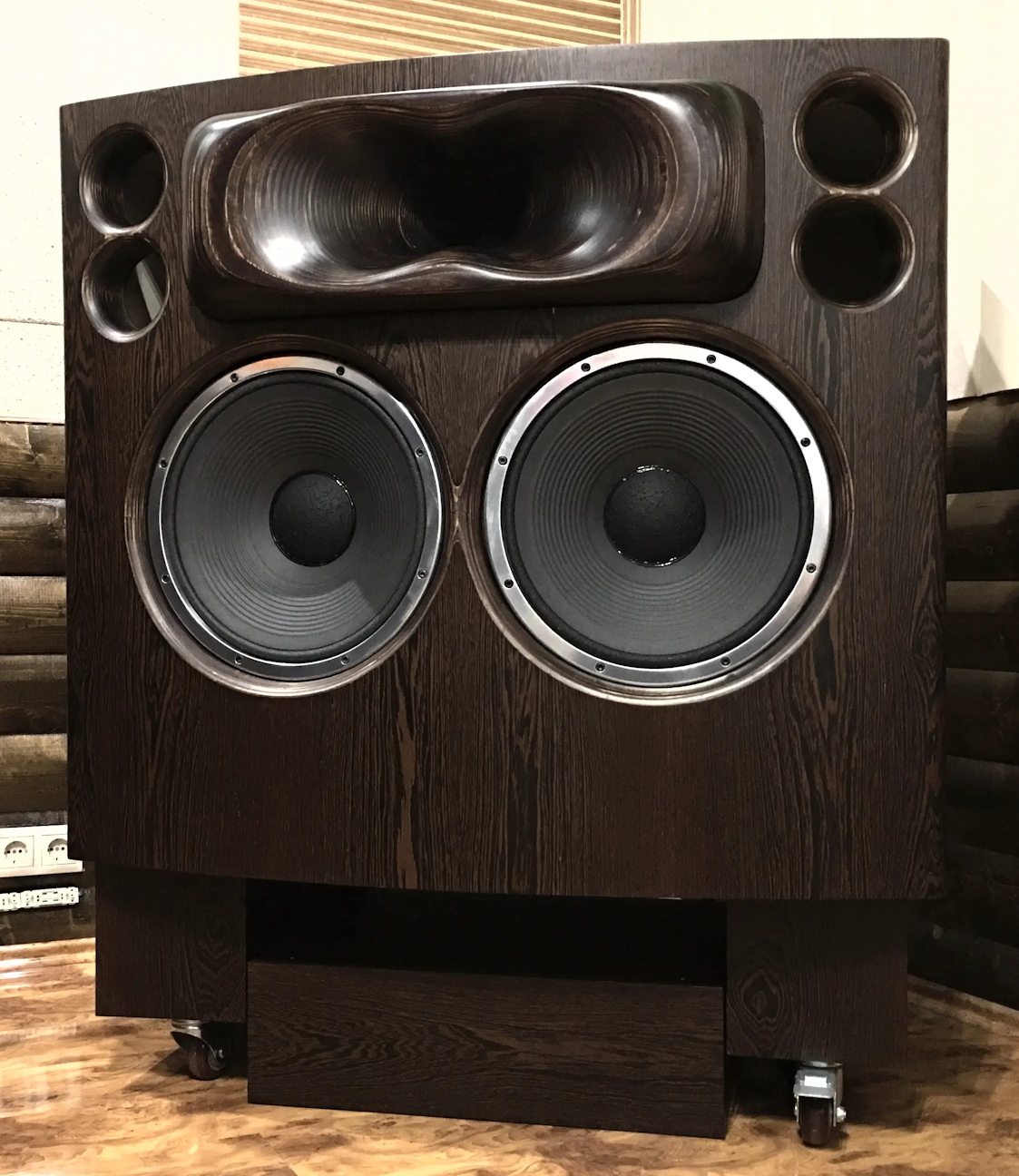

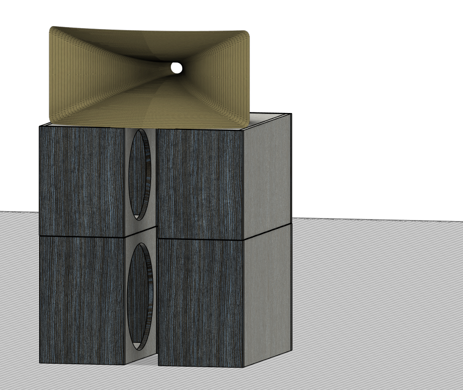

What horn is used in the rendering? It is similar to one of my designs.
The last time I was laid off (due to the credit crises in 2008), I was treated much more respectfully than Greg Timbers, who spent 43 years of his life at JBL.
I had only been with that specific company for 6 months (but received full salary for the rest of the year, including use of the company car).
It's a good ol' diffraction horn:

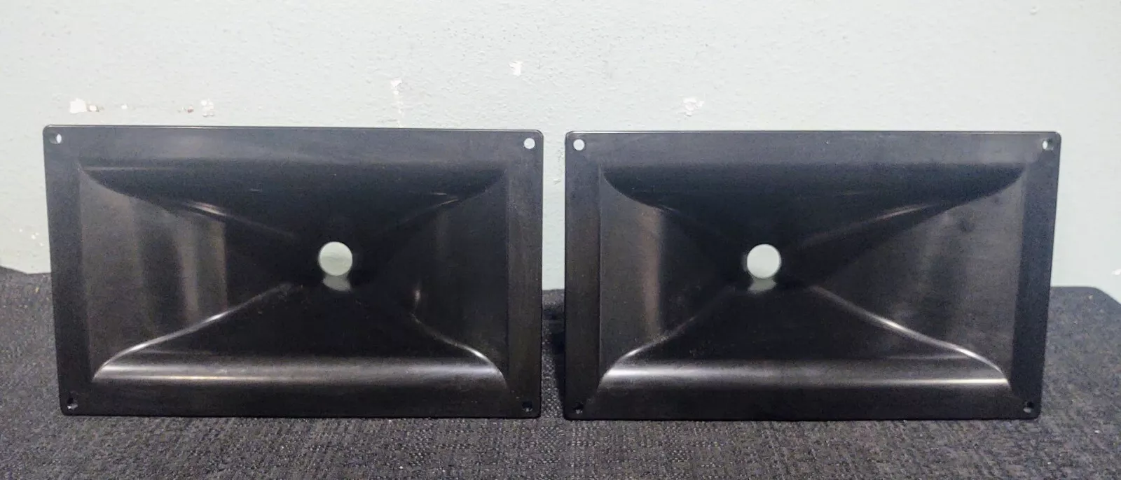

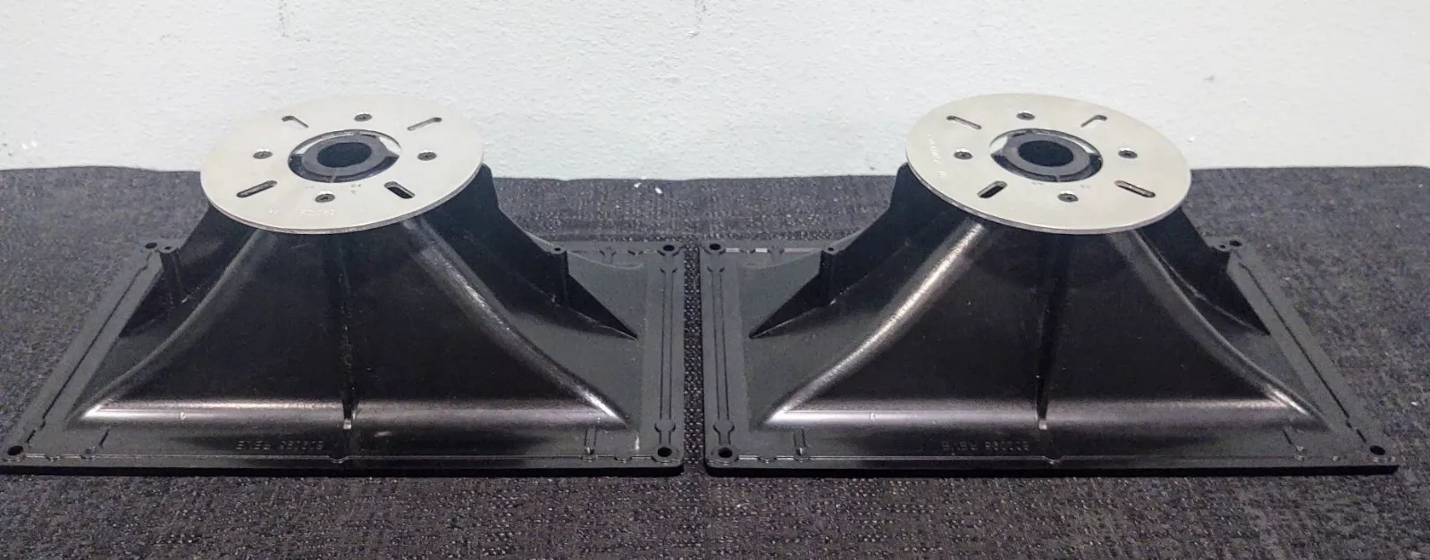

If anyone wants to build a similar TMM as Timbers' system - or possibly an MTM, but a bit smaller without the need for separate subs.
Someone sells these 1" EAW horns on 'the bay', which are very good.
Normally this horn is used in combination with a 12 or 15" woofer.
Instead, I would use 2x B&C 8NDL51, the 16 Ohm variant, for a BR cab of 120, but preferably 150 liters.
