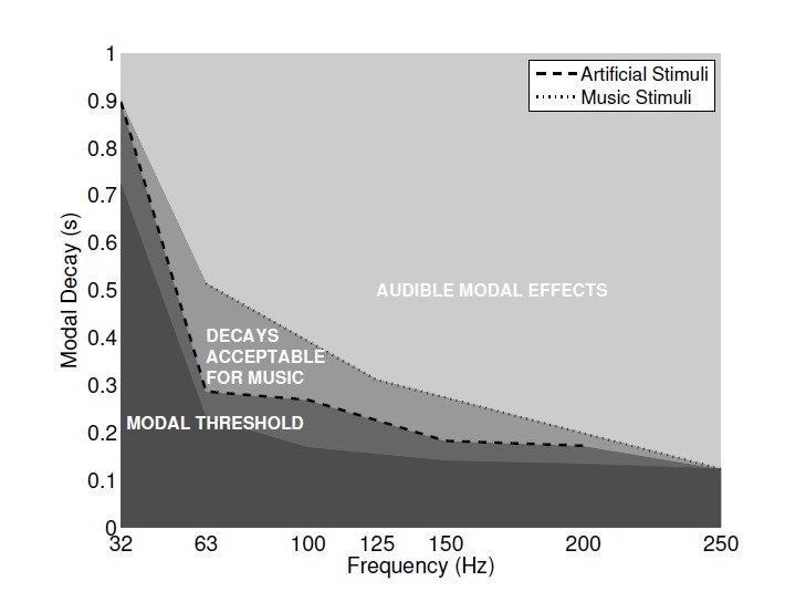

The "target" decay curve (attached below) was provided in : Fazenda, Bruno M., Stephenson, Matthew and Goldberg, Andrew (2015) Perceptual thresholds for the effects of room modes as a function of modal decay. The Journal of the Acoustical Society of America, 137 (3). pp. 1088-1098. ISSN 0001-4966

I think that because of short cycle time of HF, a balanced spectral decay MS wise, will lend to higher perception of the HF vs the LF. Any truth to this?
I should think the opposite (if you mean perceived sound level.) Psychoacoustics has shown that the perceived sound level will no longer increase once several periods have elapsed. This means that decreasing the decay rate will result in louder perceived LFs than high. But at some decay rate there will be no difference.

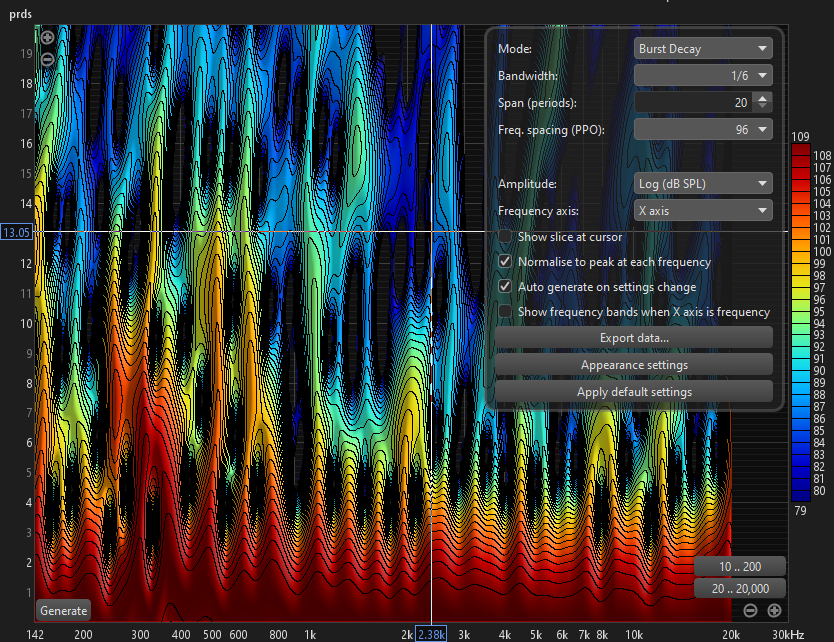

By Burst Decay I guess I should have said Period? One could judge decay by MS or by Periods. I think that because of short cycle time of HF, a balanced spectral decay MS wise, will lend to higher perception of the HF vs the LF. Any truth to this?
Periods/cycles is what is accurate. Same x value of periods 20-20khz, is what is truly uniform decay.
If its in ms, it is ever increasing delay by frequency according to the wavelengths in question, and therefore not uniform over the spectrum.

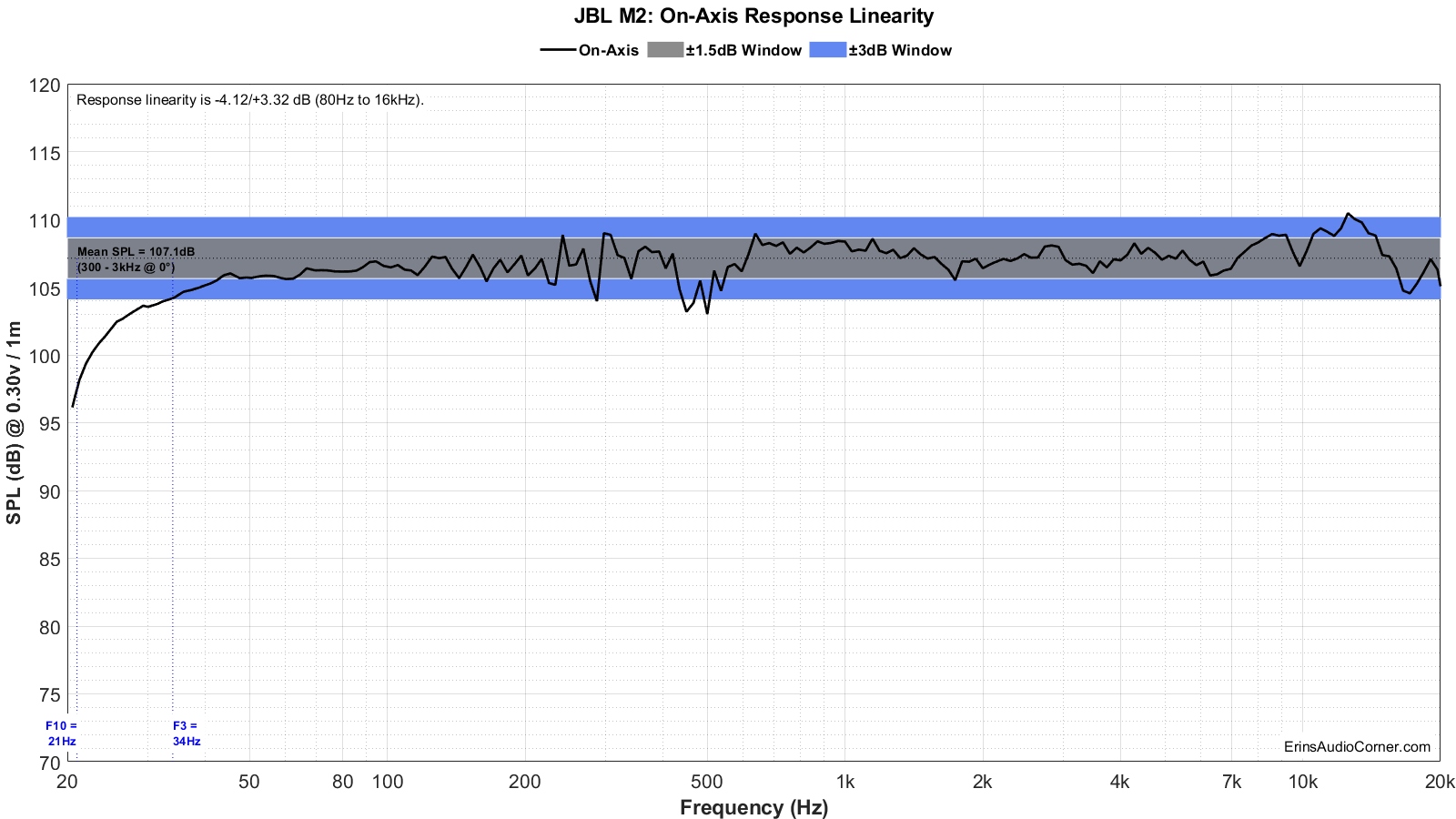

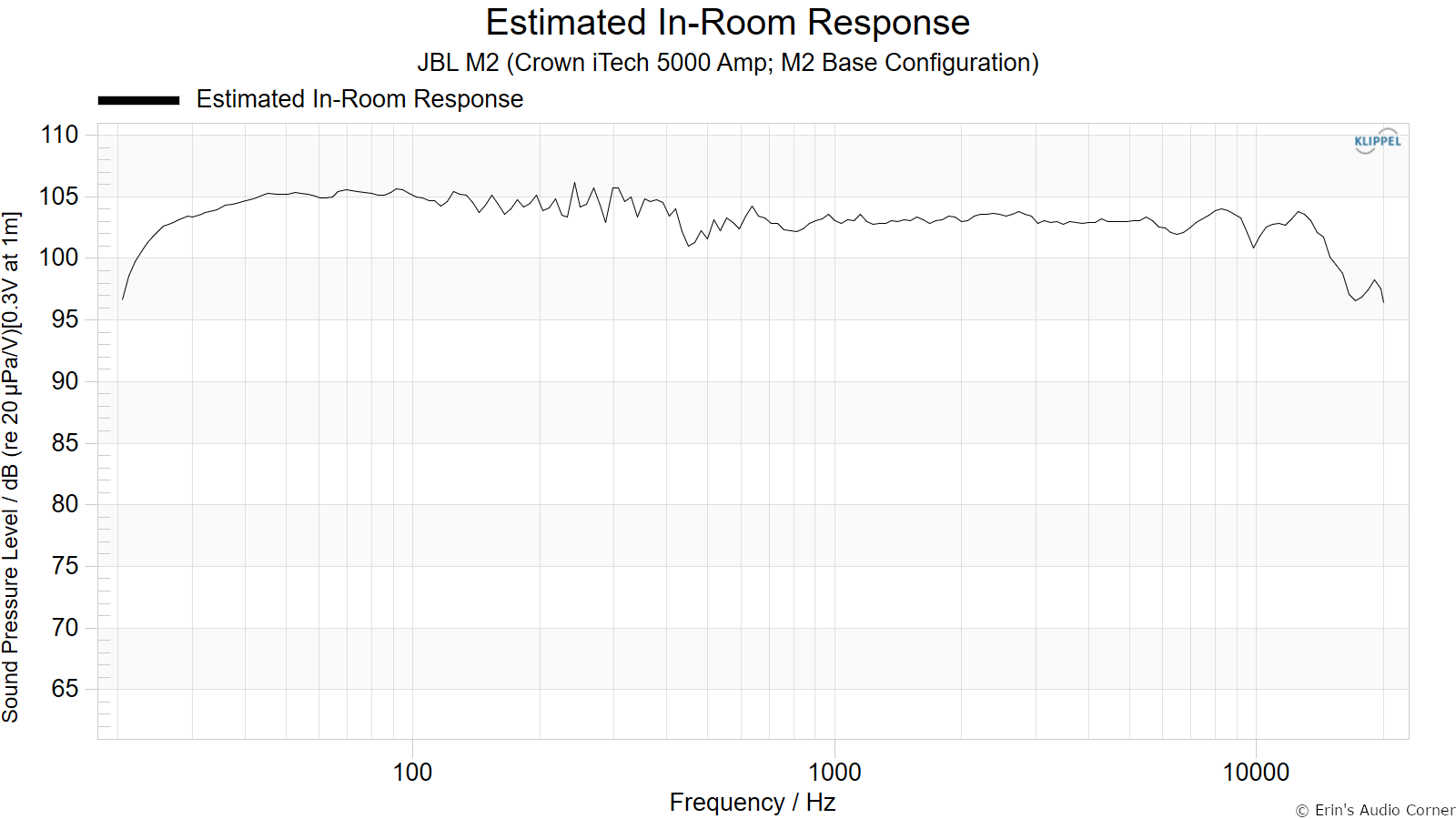

OK I see what you are saying looking at the on axis and in-room predicted on the M2 from Erin's measurements. There is a slight step but it's darn flat over the waveguide. You can see it drop up high where the directivity narrows. So if you had these in an HT wouldn't you use a sloped target curve? Won't these sound a bit bright as is depending on the room if you leave them flat.

Someone interested in a completely neutral response. I mean we are speaking preference. If you prefer a highly analytical sound a very neutral response is where its at. If the system can play down to 30hz or lower, when voiced flat it isn't going to sound bass-less at all.
Correct, many of the so called high end speakers sound 'bass heavy'.
