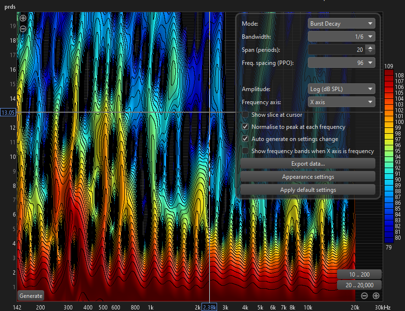

To clarify, you mean uniform by Milliseconds, or uniform in the eyes of Burst Decay. I forgot to bring up those two points of view, in the original question. I see what you mean about the modal versus the non modal region so maybe if we focus on just the non modal region, the philosophy will show itself.True for the non-modal region, but in a small room there should be more absorption and hence a faster decay. A uniform decay with frequency in the non-modal region is going to be the norm since most absorption is broadband even if not exactly flat.

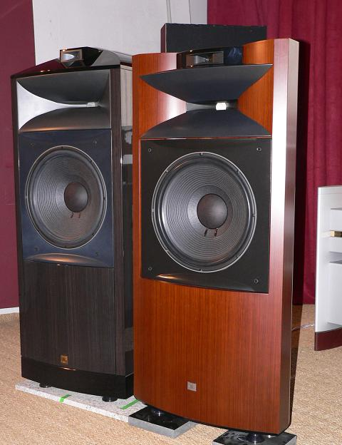

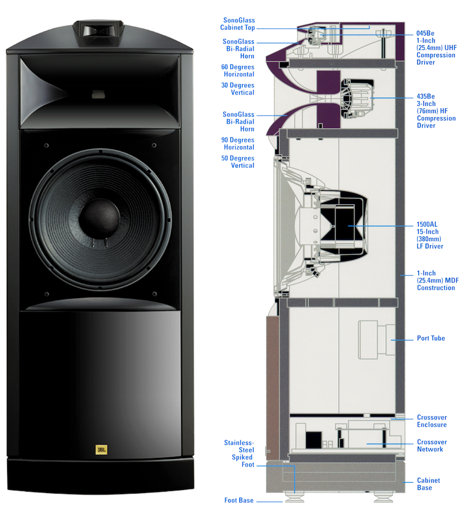

I've always assumed the 1400 horn is identical to the S9800, but vertically mounted.
The throat section of the S9900's mid horn is 'more open' (less contricted). For a reason I'd think.
I've only listened to the Array 1400 in a Synthesis setup, which sounded quite impressive.
HelloI've always assumed the 1400 horn is identical to the S9800, but vertically mounted.
No they are different the Array is 70x70 vs 60x30 for 9800/9900. Greg used modified 9800 vertical with 045Be mounted in it that morphed into the Array horn. Take a look at the photo.
Not sure unless you have them at the same height it's hard to tell. The contour looks different and as a later horn maybe an improvement? Hard to tell when part of the horn is the veneered side of the enclosure.

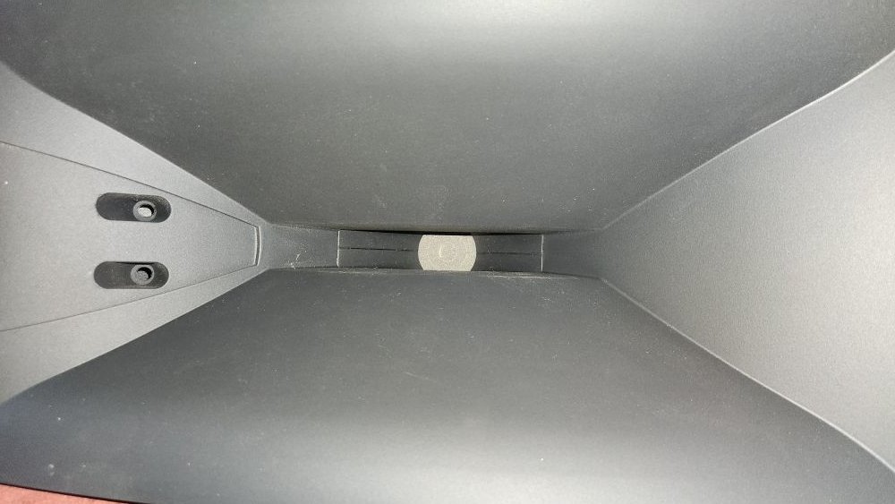

Here is a shot of the Array horn.

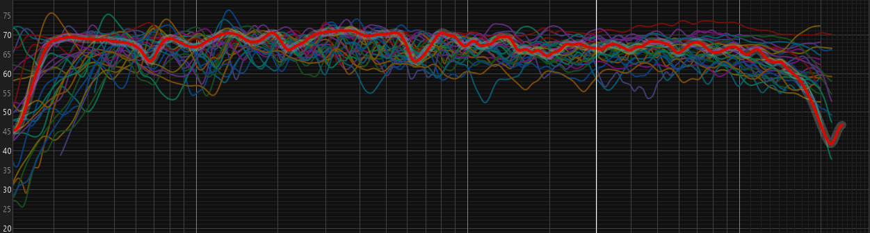

Those adjectives come from average people. In studio monitoring Flat or at least near flat, is a standard... In my 27 measurements of studio listening measurements, all you say are near flat measurements.
To a person who is used to listening to bass boosted FR, of course a near flat response sounds off... Its like a person coming from a dark room, no light, eyes adjusted... then walking outside into a full Sunlit day... Their eyes will be in pain... but is it too bright outside? No... Our ears work similar, it takes time to adjust... and even then it takes time for expectation of the sound coming out of the loudspeaker system to change.

I would use ms. since I don't know what you mean by "burst decay".To clarify, you mean uniform by Milliseconds, or uniform in the eyes of Burst Decay.

By Burst Decay I guess I should have said Period? One could judge decay by MS or by Periods. I think that because of short cycle time of HF, a balanced spectral decay MS wise, will lend to higher perception of the HF vs the LF. Any truth to this?I would use ms. since I don't know what you mean by "burst decay".
