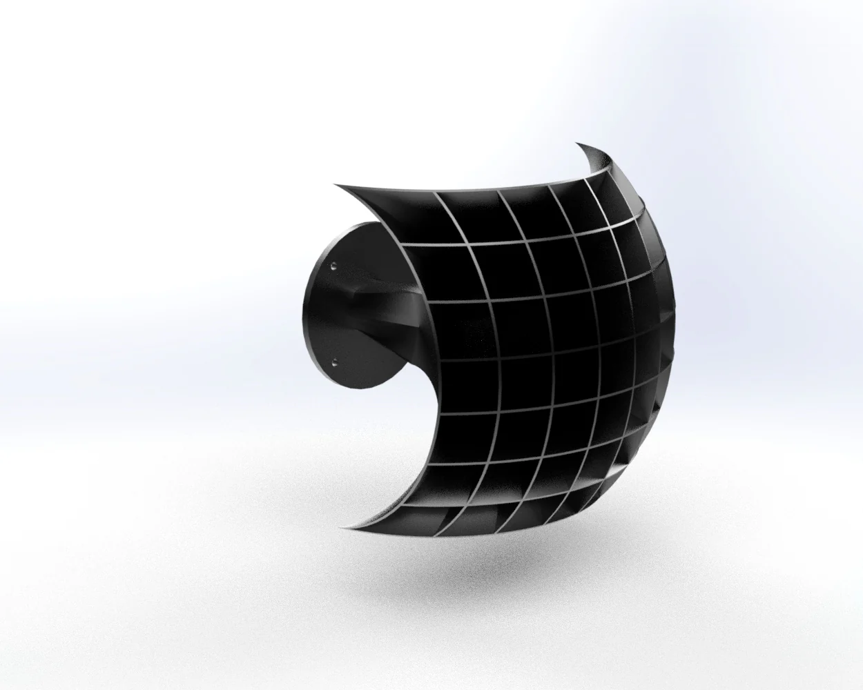

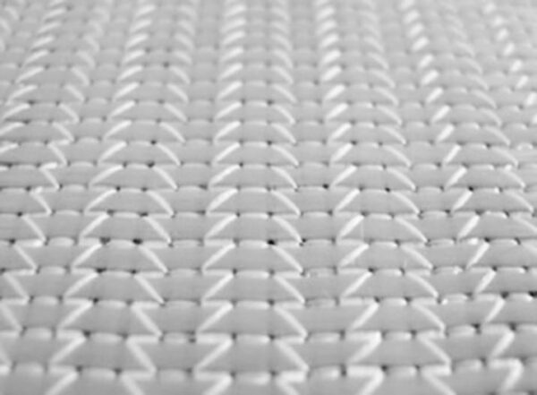

I got tired of speculating... First I went to the marine store to see what fiberglass fabric looked like in person... Then after looking multiple horribly recorded video of these types of products I concluded that I won't be able to decide unless my desired product is in my hand and I can visually inspect it.
I wanted a type of organic/oriental looking...thing. Maybe not the right adjectives but non the less this pattern is really attractive to me.... I don't even want a white enclosure in particular but I am not against it... and I don't want to have to apply anything to the outside to change the color... but it is what it is... Carbon Fiber is an acceptable color but the price of it for this pattern is outrageous. Fiberglass is much cheaper. Plus with the nylon stitching I'd be wise to cover it in something, to protect the threads anyway... The most popular weave for finishes is the twill weave and then satin and plain, as long as the weave is tight, uniformity can be expected. If the weave I've chosen is uniform, I will be very happy. Colored epoxy is the idea I have in my head... What color? Not sure yet...
I took a stroll through Sweetwater's monitor pages, and everything is somewhere between black, charcoal, and grey, with the exception of completely white. I dislike the Glossy products with the exception of texture + gloss, which is seen as black brushed aluminum. This is also before I pulled the trigger on the stuff above.. but the stuff above had been researched for some time already.
I am an artist, so don't expect it to make sense lol... texture and organic material is calling to me... In particular the repetitive patterns... I am also cheap so fiberglass checked all the boxes, but its to be seen if this pattern is uniform enough for a finish, since this aspect can vary between brands and weaves

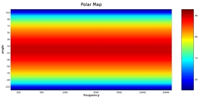

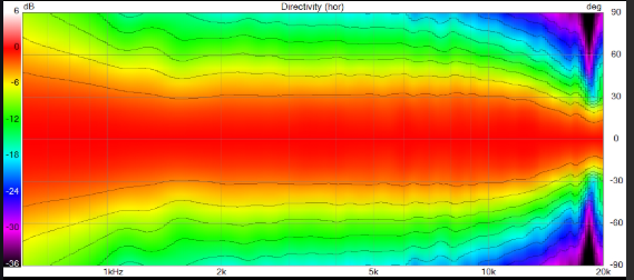

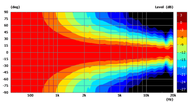

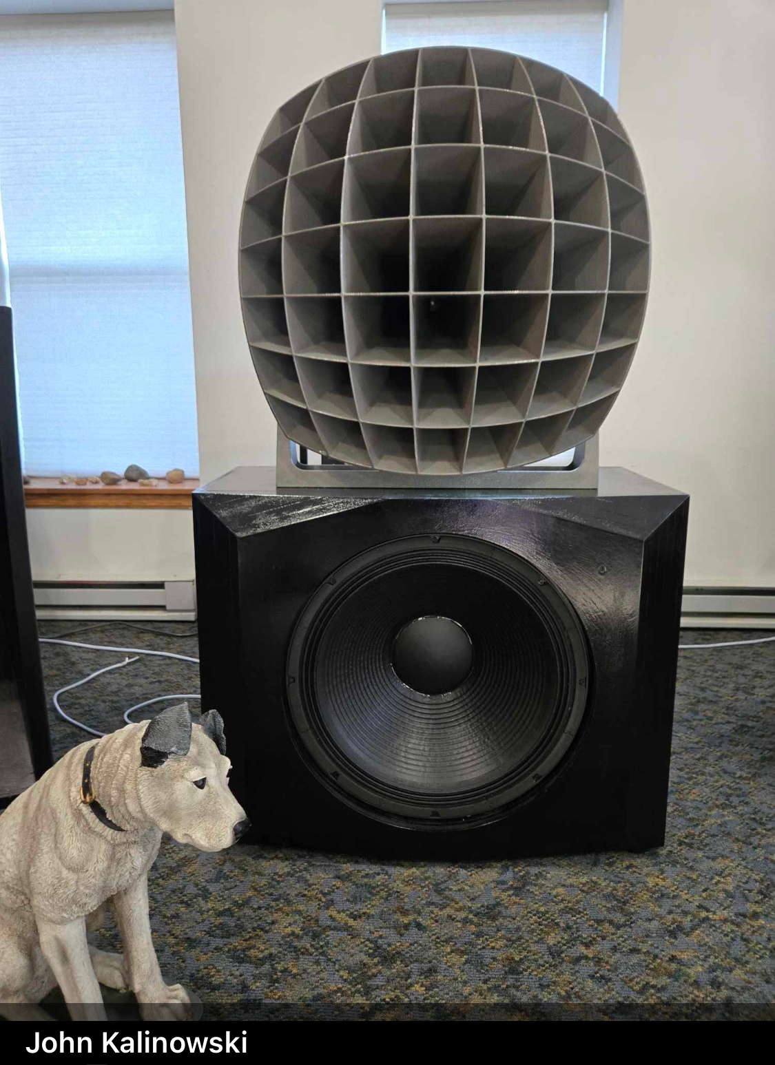

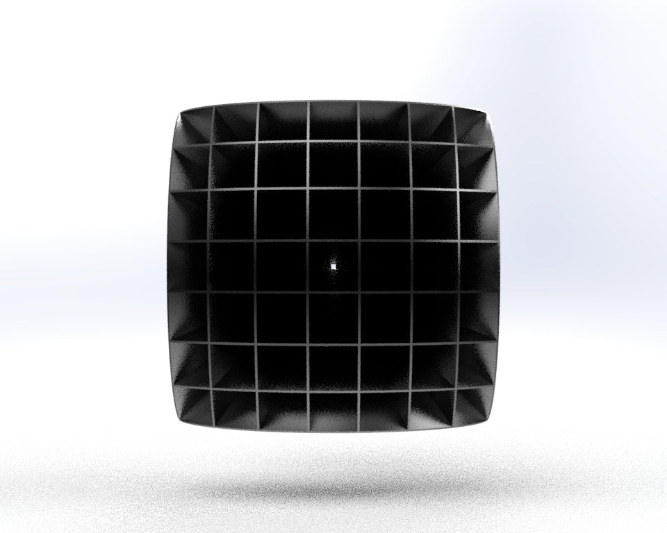

posting this here for reference, and spotlighting... We have talked about this before in this thread but I want to dig up those comments for my own personal reference and organization. This is a comment from another thread but now I have cataloged it here. Ty @mabat for helping provide clarity as usual.
https://audiohorn.net/constant-directivity/
"When a directivity is not constant, the device loose more and more coverage when the frequency goes up, the polar aka the energy in dB relative to the angle of radiation show us the problematic " I am not a fan any literature coming from the same place money is exchanged, but Why are posting a sentence that is just meaning to say that your sweet spot is limited to how wide the coverage is before -6db. They didn't even word it right, they are describing a horn with a rising DI, to which is not the only Non constant directivity horn.
This is a type of ideal, one of many. No reason that a 70 degree beamwidth should be chosen over one that is 45degrees or 55 or 65 etc etc.
That is essentially saying that having various beamwidths is ok and the smooth uncolored transition is the real prize...
Both of these styles of horns have a smooth off axis transition. One is less uniform to frequency. The smooth off axis transition starts sooner in the HF, slowly working its way down frequency.
@oltos I don't think you have a clue what you are looking at... I think you are faking it till you make it while trying to wait for someone to say the magic thing that will inspire you to finally jump... Until you can say what polar performance you prefer and why I will assume as much is true. You should really give one of the popular AI's a try... Its always there, always on, always has replies, and you can bounce ideas off it all day with immediate responses instead of waiting for a response here... Grok is the best in my opinion with Claude 3.5 and DeepSeep right behind it... I have to correct its answers at times, but at least you can come here after a while of debating with the AI and see if your new found ideas fly or not.
If the sweet spot is big enough, If it is, there is no reason why constant directivity should be chosen over rising DI. The room will sound different but I have discovered that in either cause you end up with a Power response that is sloping Anyway... I repeat... With a well built rising DI horn and a Constant DI horn, in a room that is considered acoustically very good... You still... end up... with a Sloping Power Response... because of how much more efficiency acoustic treatment is at eating HF energy over LF... In that cause, If you have two horns one with a rising DI and one with a constant DI, but the sweet spot is identical... They can result in almost identical listening conditions.... Why is this noteworthy, because one of the major sells on constant directivity approach is "balanced power response" when in actuality be only need it be smooth without dramatic changes... The concept of Smooth transition takes precedence, In On axis Fr, Off axis FR, Power Response, THD response, DI, and possible other areas, and if one wanted to, could come up with a maximum desirable transition rate for each axis. If I am not mistaken we concluded that DI is actually only final after in the room, Just like FR... and that DI tends to rise, in heavily damped rooms for the same reason that power response slopes. downward. I might be recalling that last big of information incorrectly but being corrected is usually what I am looking for so I tend to stick my kneck out anyway.
