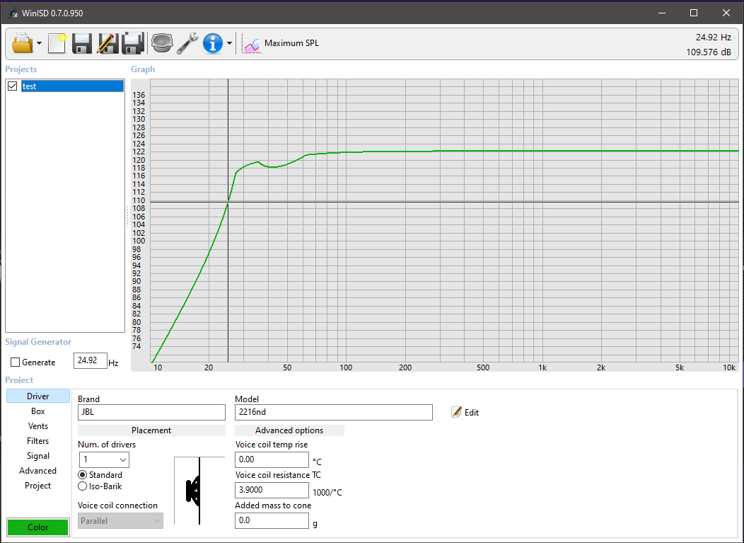

when i do a very quick sim with data i measured long ago from a JBL 2216ND with REW i get this:
it's true thtat 25Hz is 15dB down from 100hz, but 30Hz is 3db down (this both taking the xmax as limit). In reality the driver will go lower, but with heavy distortion if you push it to much because the physical limit is not xmax but xlim (that is higher). But 25hz has a max of 109dB here, louder than you ever will and almost where the OP want it. And that one dB that is lacking within Xmax limits, will be archiveble with a bit more distortion (something you won't hear at that frequency and volume).
So yes, this fits the OP's needs i think. And with a crossover at 700hz, you can match it with a lot of compression drivers in horn. The JBL D2430K driver itself is a dual driver CD altought (so no strickt 2 way), but if you use the Celestion Axi2050, you get a 2 way covering the whole band at low distortion at high volume. And there are other CD's also who can take that role of the (expensive) Axi2050...

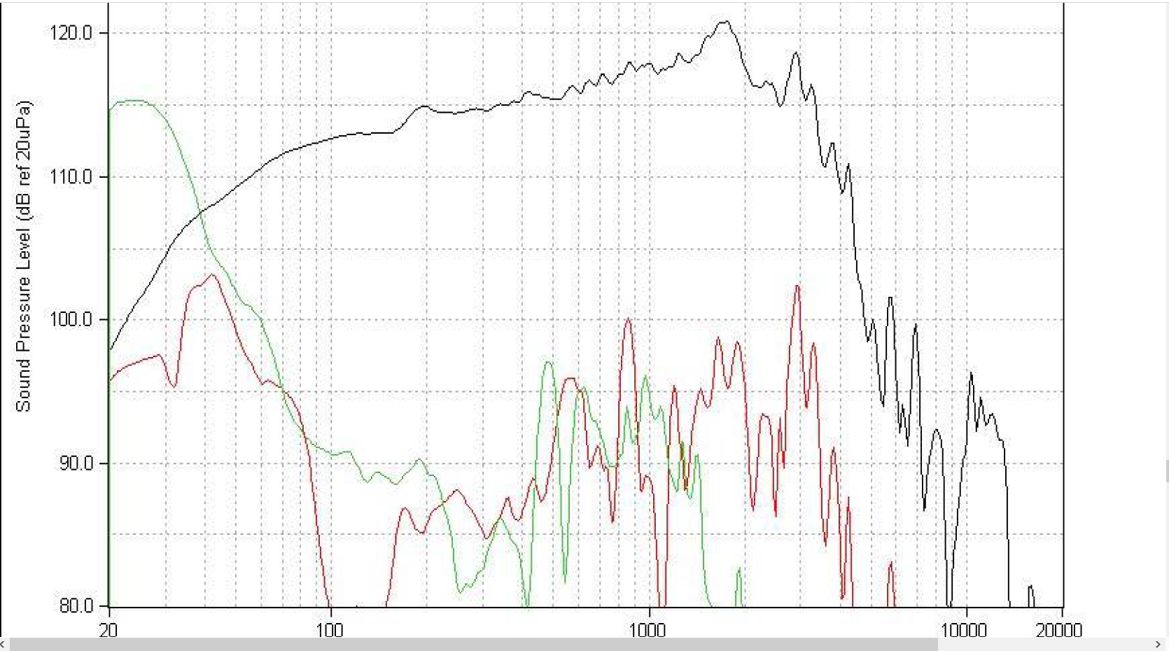

This is JBL 2216nd measured.
Where is the 117 dB you refers to?
25 hz?
25 hz?

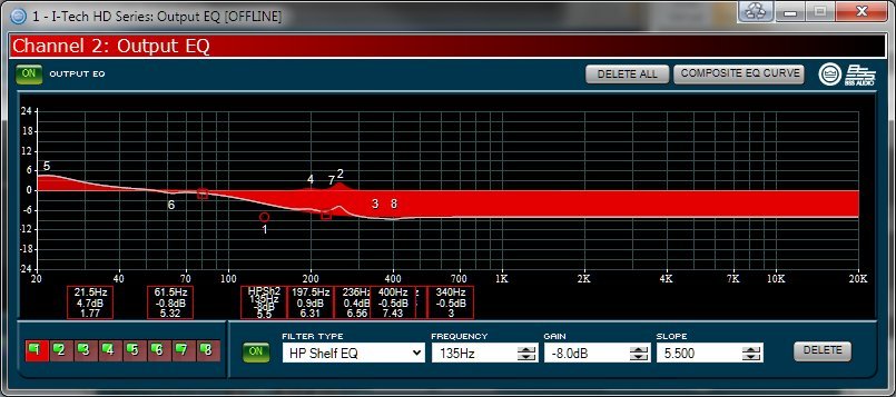

The 117 dB is for the M2 system and +/- 3 dB from 20 to 40K from JBL's spec sheet. You can't use an anechoic measurements of the 2216 driver where it's essentially measured as an infinite baffle and use that as your yard stick WRT using a driver in a reflex box not to mention any bass reinforcement from a listening room. Run the driver in a sim like the previous poster waxx did and I did to see what's up.
Your analysis is meaningless in the actual application of the driver or it's LF capability. You are completely ignoring the DSP used in the M2 to tailor the LF response of the driver in the system. JBL uses a bump filter @ 22Hz and bleeds off the HF rise using a tilted shelf filter.
Here is an independent review. DSP used to tailor the 2216Nd in an M2
https://www.erinsaudiocorner.com/loudspeakers/jbl_m2/

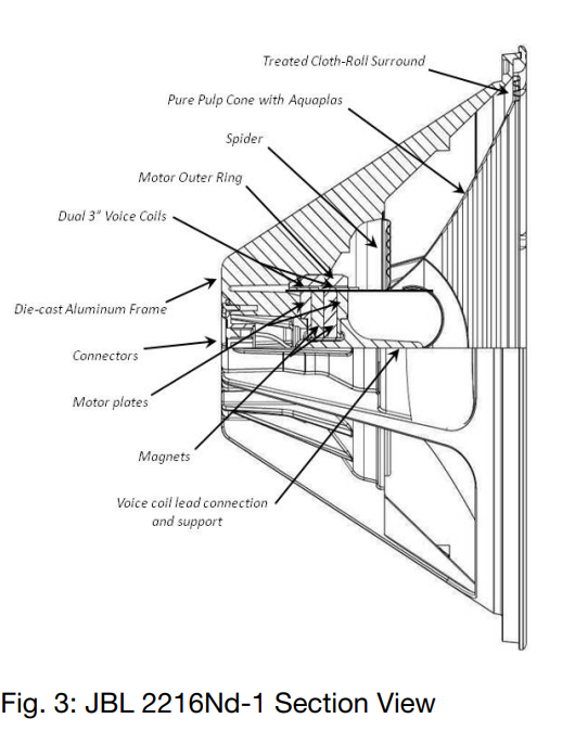

That's also why it goes lower than the 4367 that uses a similar cabinet and the same drivers, but with a passive crossover.
The 4367 uses the 2216ND-1, the cone/surrond edge has been treated with Aquaplas (helps suppress the resonance), mms is higher and suspension is more compliant so it has a lower FS, and slightly lower sensitivity.
More suited for a passive network.
