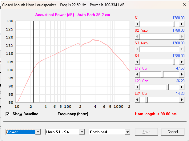

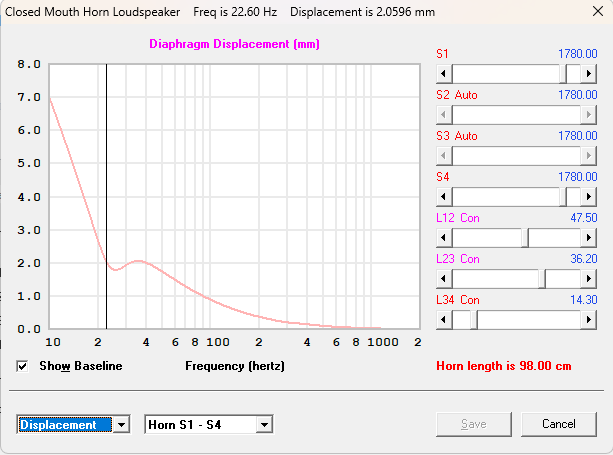

Its already been answered, and the answer is yes, its just not whats been practically done. I am trying to finish up my project, and it is looking 2-way at this point, The Axi2050 mated to 4 large woofers on each channel. Any two-way can do it if designed with this condition; Excursion kept under ~2mm at peak spl at lowest intended reproduced frequency. That is overkill, less efficiency would yield desirable results, Keeping excursion under 2mm at peak spl is better than most peoples systems period. The challenges are dispersion, LF extension of the tweeter, and woofer efficiency. The lower your tweeter can play, the less you have to worry about woofer excursion. The more efficient the woofer section, the less you have to worry about tweeter lf extension. TMM and MTM are the easiest ways to have a large 2 way for this application. A large 2 way with only 1 large woofer can it as well if we allow the definition of "whole spectrum" to "enough of the spectrum". 30hz cutoff is suitable for music playback and a large 2way can play this bandwidth at high spl/low distortion. Sub woofer systems are commonly seen as a separate application because multiple subs is and has been one of the status quos. Once multi subs are introduced LF goes up.

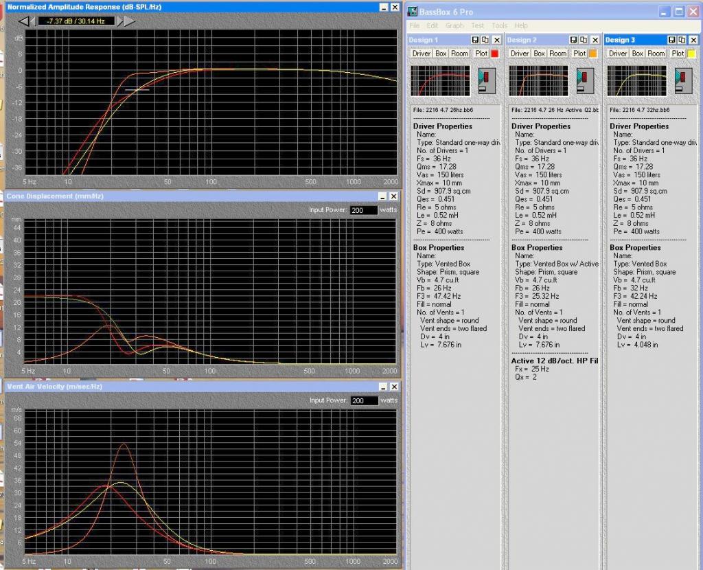

I'd like to know. I think the lowest among my mixed army of ten different 15-inchers, Fostex 15W300, is officially Fo25hz-3khz, though I haven't considered going lower. JBL 2226H Fo40hz should be able to cover 30hz-ish to 1.5khz (3-tweeter reflector point-source).

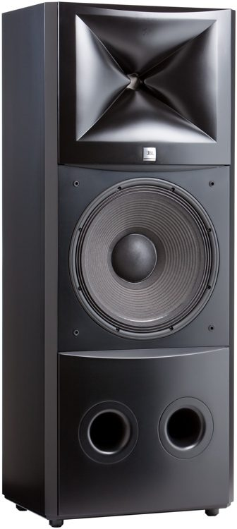

Yes, the "best" 15 inch i know of handling up too 800 hz is old JBL.
2215h, E-145 and maby some other.
But no near 20 hz there, and a driver thats "handle" around 20 hz will be "feed up" at 3-400 hz max.

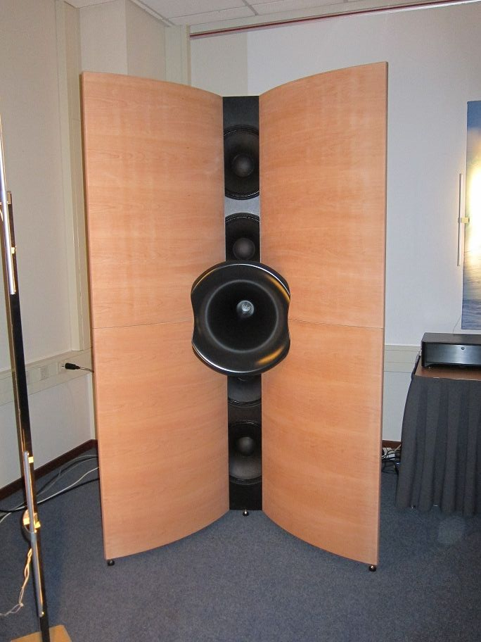

(Pictured) 45cm-CtC 2-way crossed high, even worse than usual WG+15 (which I don't like unless very far away).
I think it can with the right design, and probably a little damping material. Depending on the crossover one may not need to be so extreme, as trying to keep excursion limited to 2mm. The very last part of the last octave, is extreme. A tuning near 25hz helps alot. Truth be told I dunno any other way to get closer than basically what I am doing with the sets of PPSL woofers, totaling to 8,160cm². The 2mm or less goal is pretty ambitious like I said. Another person might argue that reasonably we should be able to trust a woofer to something closer to Xmax. With a 14mm Xmax I'd like to think that 7mm of that excursion is worthy of the best production if the woofer is one of high stature. Non the less, if we relax from 2mm to half Xmax, which is still being conservative, headroom might be considered much higher for these scenarios we are debating
