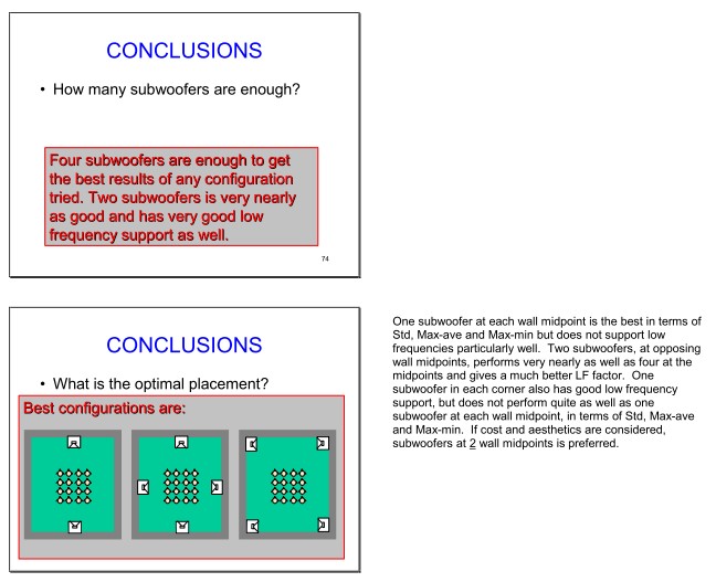

Anyone have any feeling towards or against using a room corner for boost and FR of a sub?

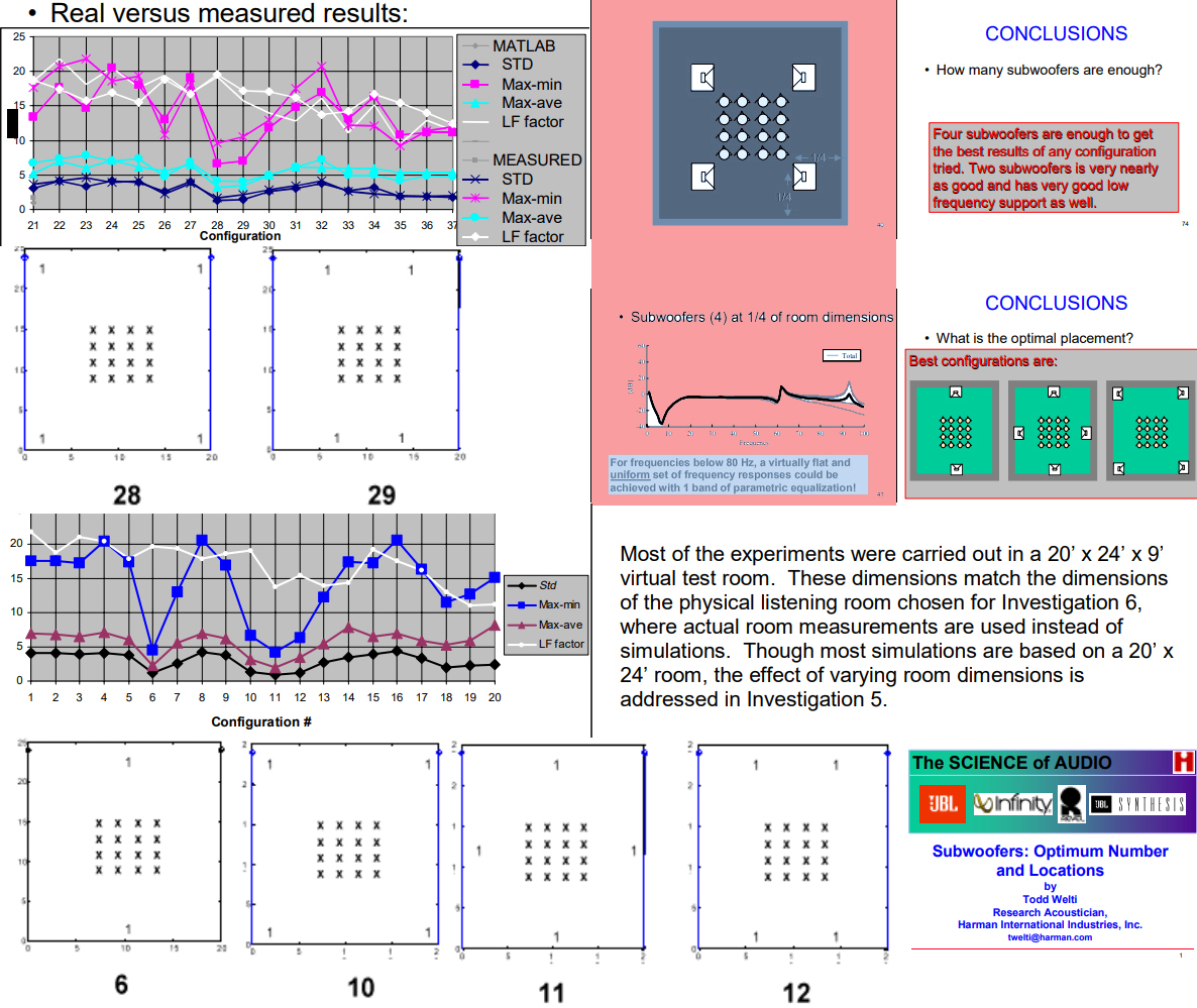

In my listening room I got best results with 1 woofer when positioned in the corner with the membrane close to the wall. But a multi sub setup was even better and more even through the room/listening zone.
Do you know the Harman multi sub paper? (multisubs_0.pdf). That's the conclusion of best positions:
This are just 4 subs playing, no delay etc. I also have good experience with the positioning for 2 subs.
Also pretty good (place 4 or 5) was subs at the position where they would be with a double array - 1/4 in from L/R and 1/2 room height.
So while you can get good results with one sub it's more consistent with more subs.
But next level is a double bass array where you can influence room acoustics! (Dirac ART should also do the trick)
Hi @IamJF. According to my recollection, 1/4 spacing from corners was the best performing position out of all the configurations in that study.. Being 1/2 distance between the ceiling, and the floor was not a part of the conditions, as I recall it.

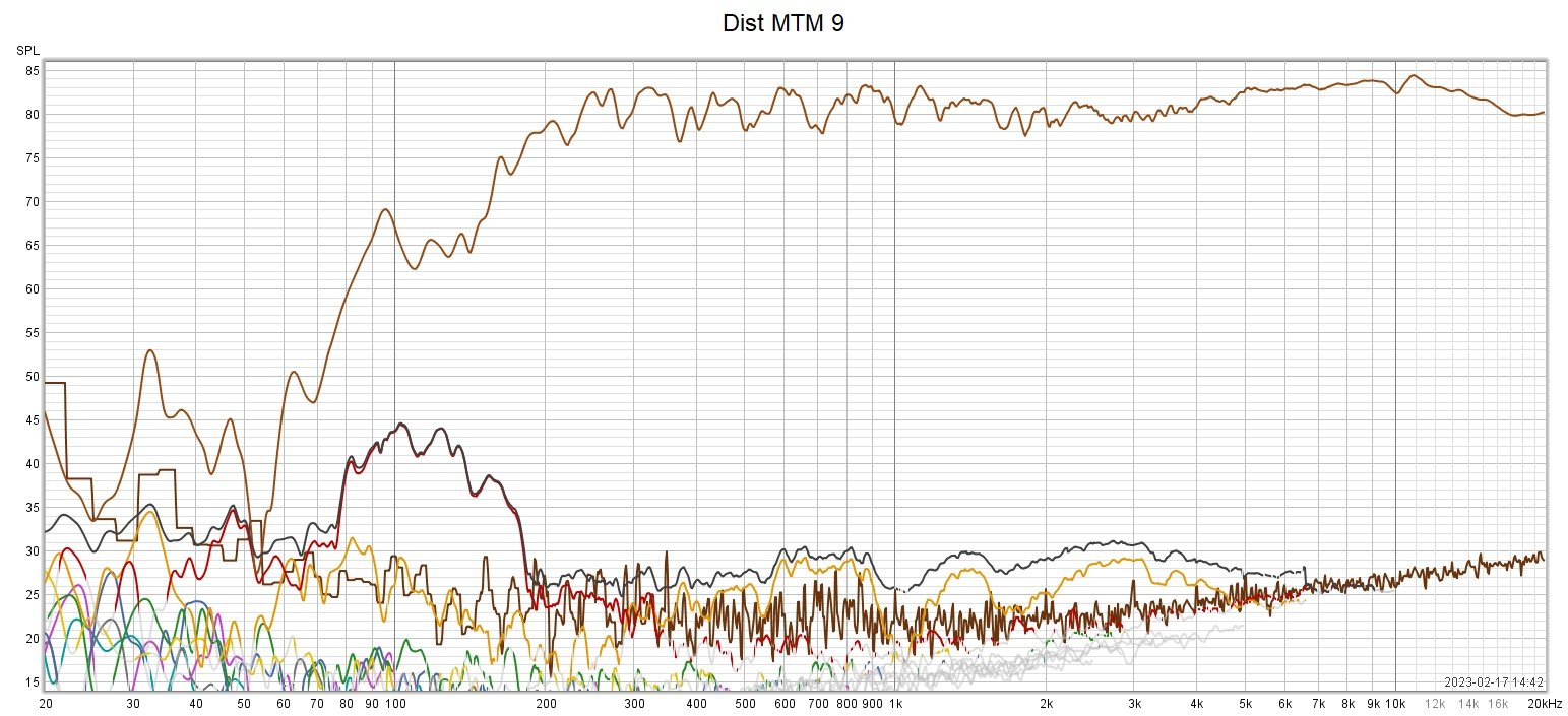

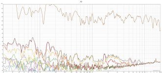

Have you measured distortion at peak spl?
I missed your question Camplo!
It was a long time ago & I have 1000s of different measurements on the computer (poorly organized), but found 2 early measurements.
One at normal volume without woofers & 1 with high volume where the microphone was at the listening position about 3.9 m from the speakers.
These measurements were at the beginning before the xovers were adjusted.
But making measurements is really a skill, and these was my first 6 month of learning measurements, think im better at it now 3 years later 👍
regards John

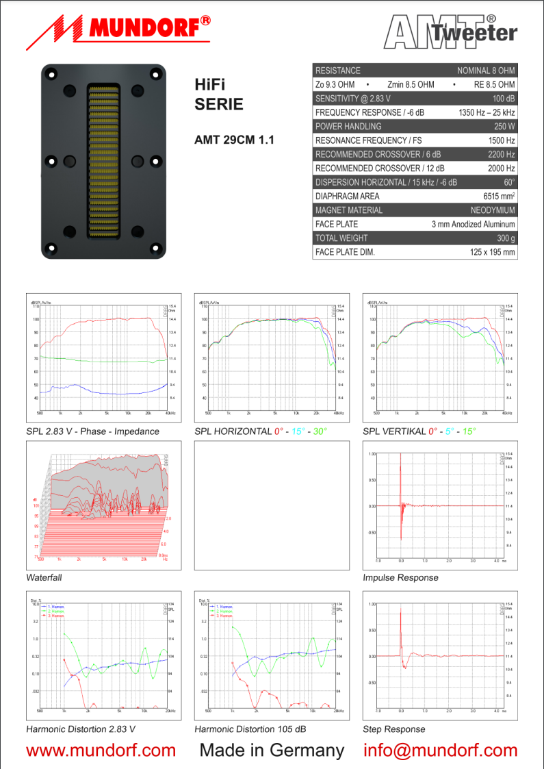

Mundorf AMT29CM1.1
That things a beast
AMT were my favorite until I can here and they showed me the power of the horn loaded compression driver. This ribbon competes with a compression driver, not winning on dynamics but winning on FR. As I said before the most potent factor of Accuracy given everything else is good, is Directivity. I think I would want a big waveguide on my AMT tweeter.
Reactions: jawen
