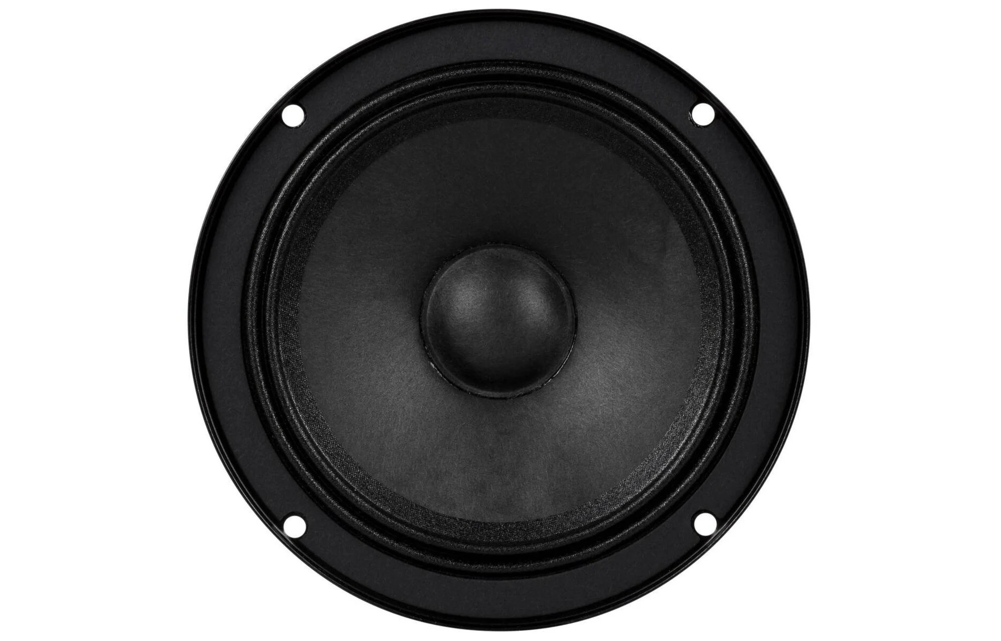

What is Re and what is Sd for this driver? And what driver is this?But for midrange only I'd pick this one (Bl: 6.23, Mms: 9g):
Btw my actual midrange choice have Bl = 11.7, Mms = 8.6g

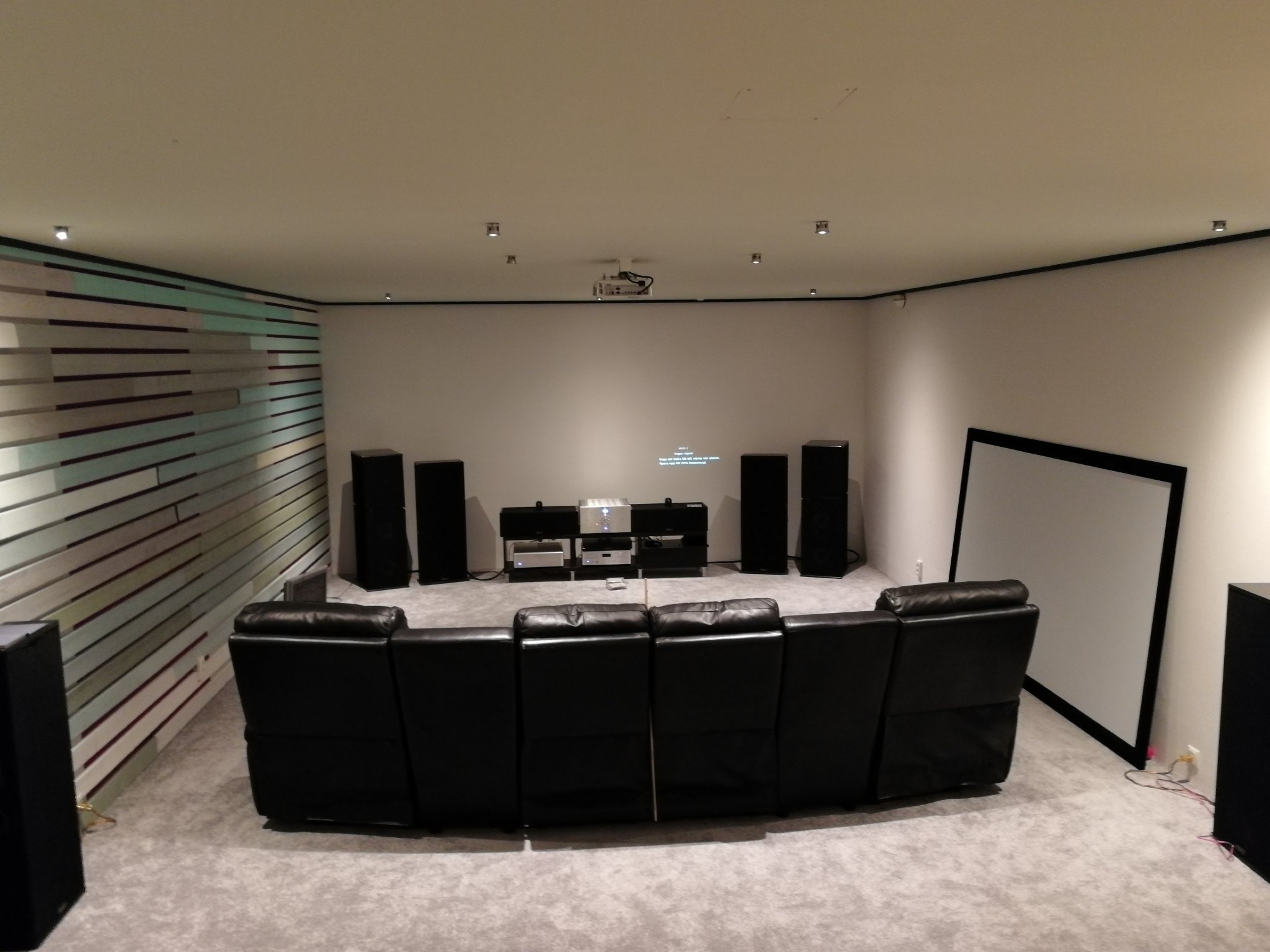

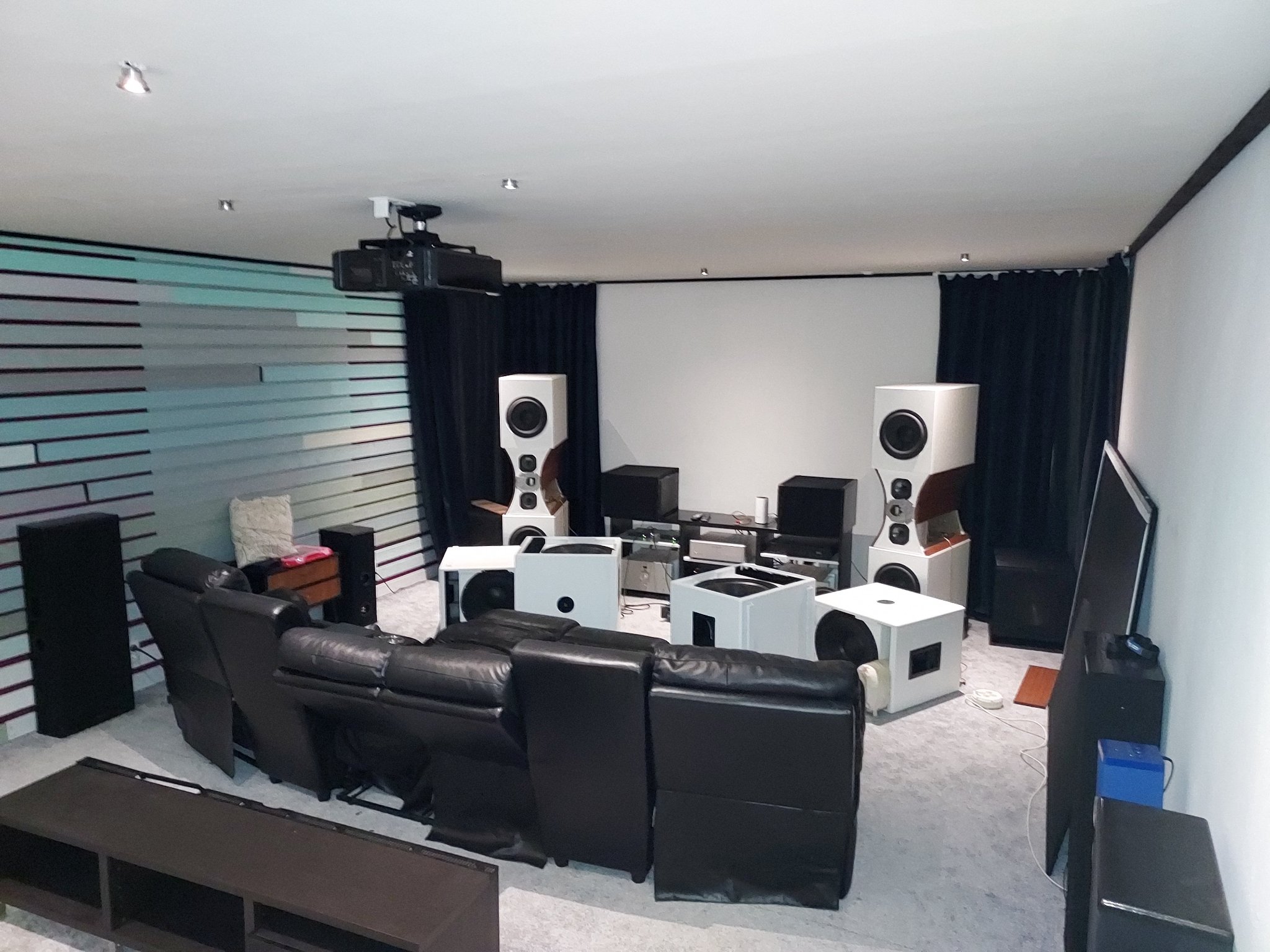

I actually have it in my sound room in the basement!I don't tink it's possible to reproduce a large orchestra in an average or even large room to scale, but one may approximate the illusion.
But it needed a lot of diaphragm surface & 100 dB sensitivity.
6 longtrow 12 inch woofer, 4 Audax 8 inch midranges and 2 very exensive Mundorf AMT tweeters.
In a good damped rum 5 by 10,5 meters airtight. (and much power to them)
Don´t have good photos on just them (you know diyérs, always "on the run")Jawen, would you mind to share some pics.?
But this was the concept, and how it "in the end" had to be. (after had blow 5-6 Audax 5,25 inch midranges)
215 kilo each
Woofers in ca 105 liter netto ported up to ca 340 hz active filter, MTM everyting over 340 hz from active filter with a passive filter at 1850 hz to AMT.
Ask questions if you like
regards John

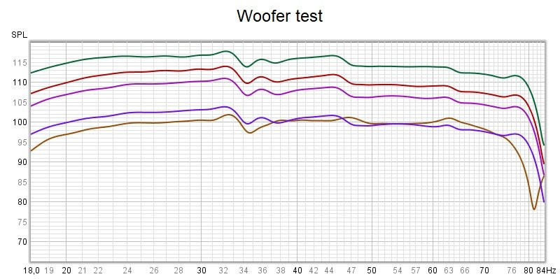

It´s 6 Peerlees 830847. (Sadly Peerlees don´t sell them sinse 2007-08)Can you be more specific?
FS is 21,8 hz, QTS is 0,36, VAS 144,2, BL 10,2 Tm, Mms 110,9 gram, Cms 0,48
AND incedible 92 dB in sensivty an a linjear xmax +-12,5 mm.
Driver have dubble 8 ohm 51 mm coils, connected in series to 16 ohm, and i have 3 per side in parallel outside the box to 5,66 ohm.
Mounted in 25 mm MDF box (baffle 50 mm) reinforced/staged, port 102 mm inside 33 cm long (if my memory is right) Filling is stonewool by ca 30% of internal space wrapt in textile to not get dust from it in the lungs.

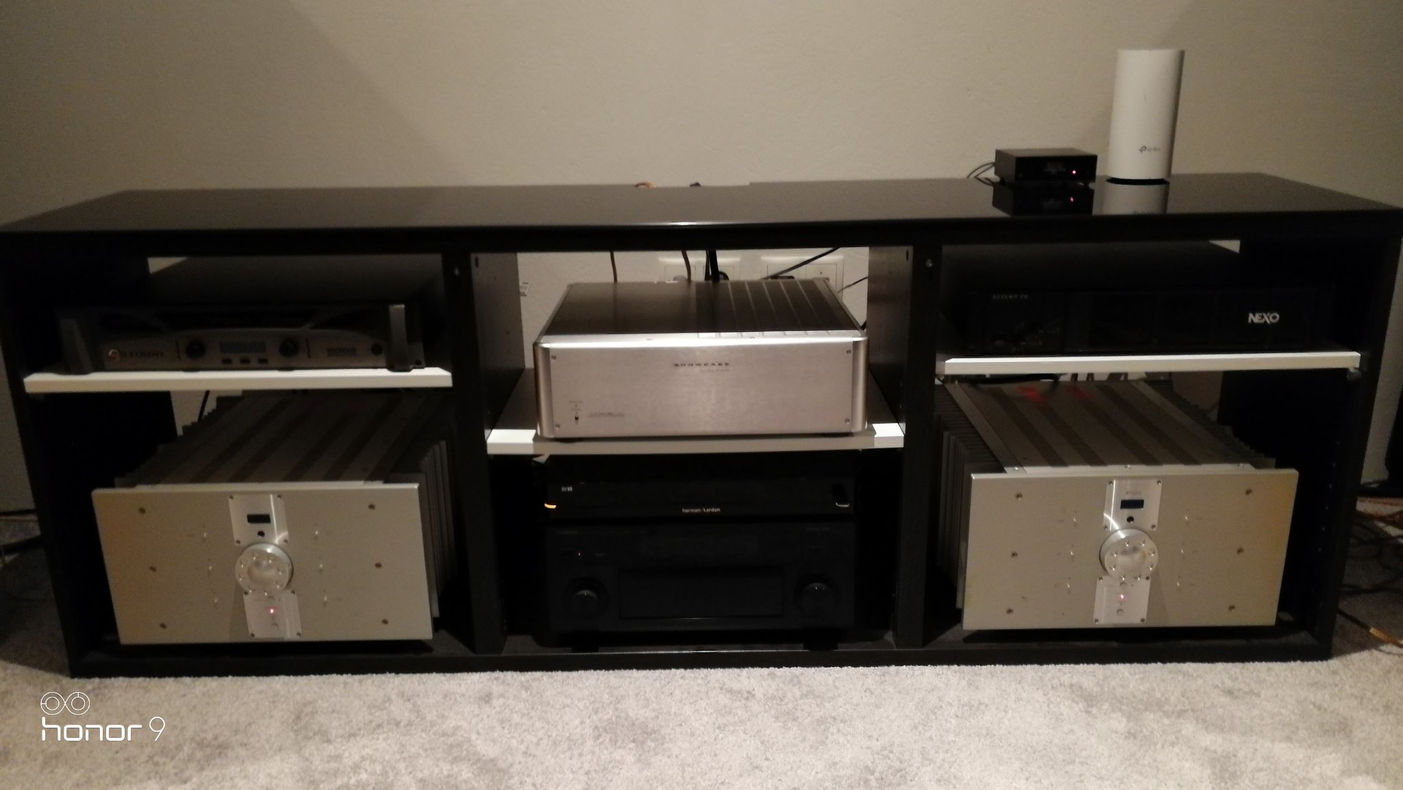

Driven by a Krell f.b.i stereo amp intg (that Stereophile measured to 2 X 430 W/8 ohm), one channel per side, so ca 225 Watt each in 6 ohm
Plays flat to 20 hz around 120 dB, port give much to 15 hz.
Ask more if i missed something 👍
