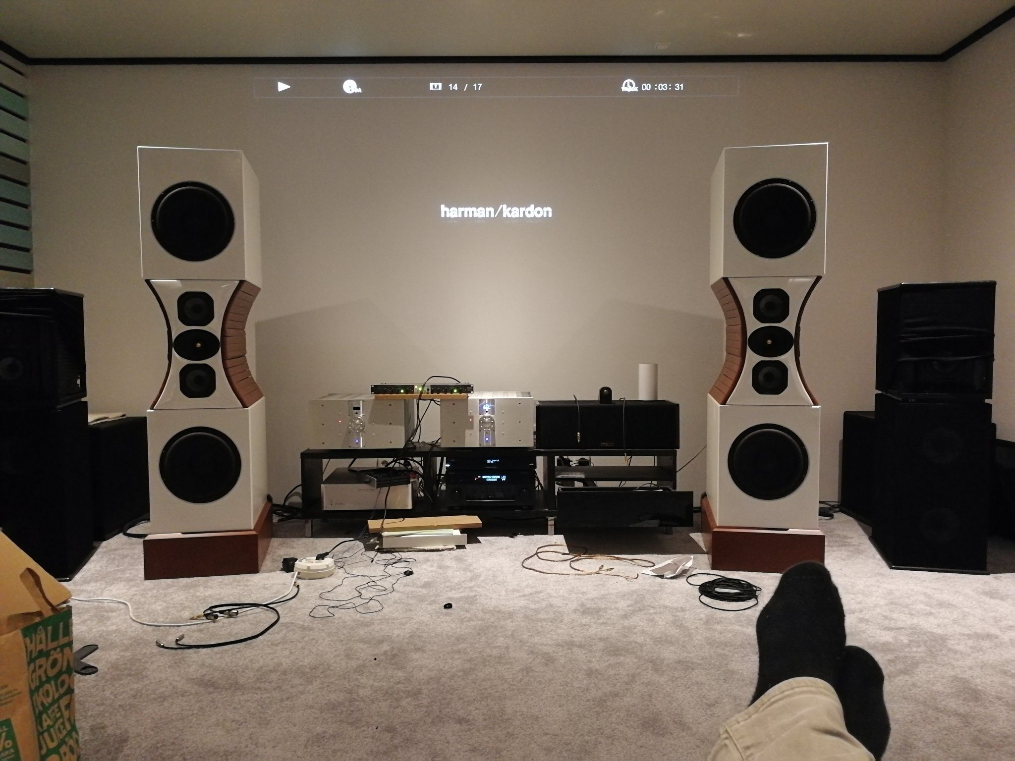

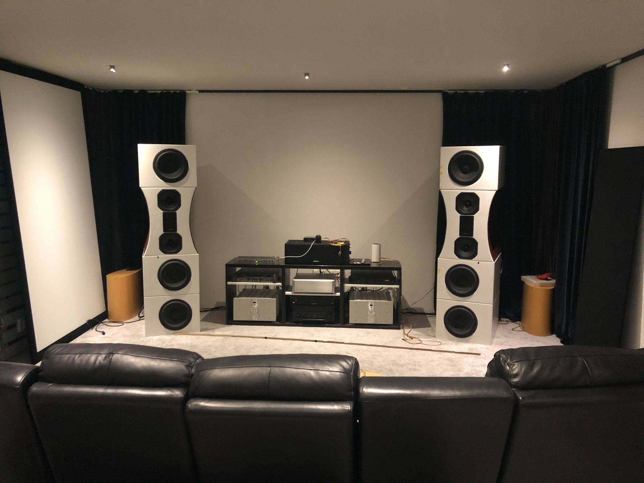

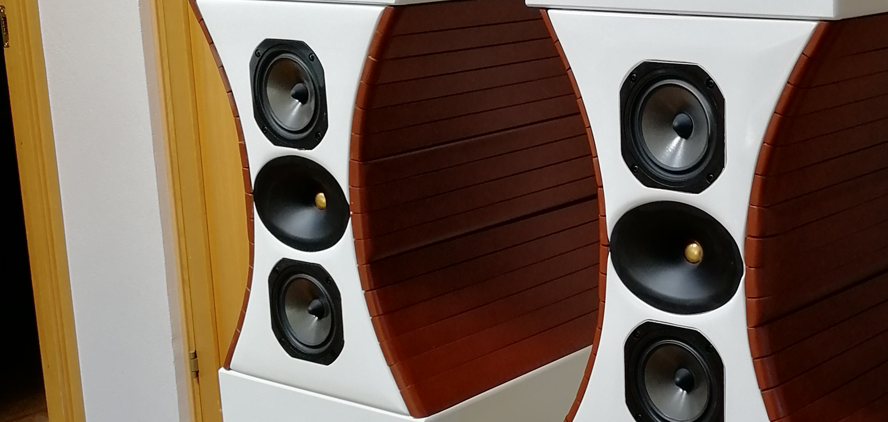

That was my first real diy speaker and it really sounded excellent, but diddent life-like reproduce a large orchestra more then 5-10 minutes before i blow the midranges, and missed some deep fundamental bass.
My favorite midrange Audax hm130z0 and a Audax TW025A28 in a waveguide from Pellegrino in USA.
The crossing was att 250 and 2800 hz.
But the speakers midrange ,had to play at maximum all the time, so sadly i blow them all the time.
And after about 6 blown midranges even if i raised crossing to 300-320 hz, i had to do something.
Tested "big brother" 8 inch Audax hm210z10 with the Audax TW025A28 in a waveguide for a while.
Audax hm130z0 have a 25 mm coil and Audax hm210z10 have 40 mm, so quite big heat-issues differenses.
Also at 99 dB against 92 dB, so more output.
Liked the Audax hm130z0 "a little more", but had to do something because my high listeninglevels.
Audax hm210z10 starts beaming at ca 2-2100 hz and thats to low for Audax TW025A28 with my listeninglevels, so also needed to come up with another tweeter.
Ended up with Mundorf AMT29CM1.1 (after selling my kidney)
And also them could cross the Audax hm210z10 at 1850 hz (12 dB) to the Mundorf.
MTM to give me headroom!
Working on makeing them "more" attractive, but hard with so big speakers.
So last photo with 3 woofers per side is todays setup.

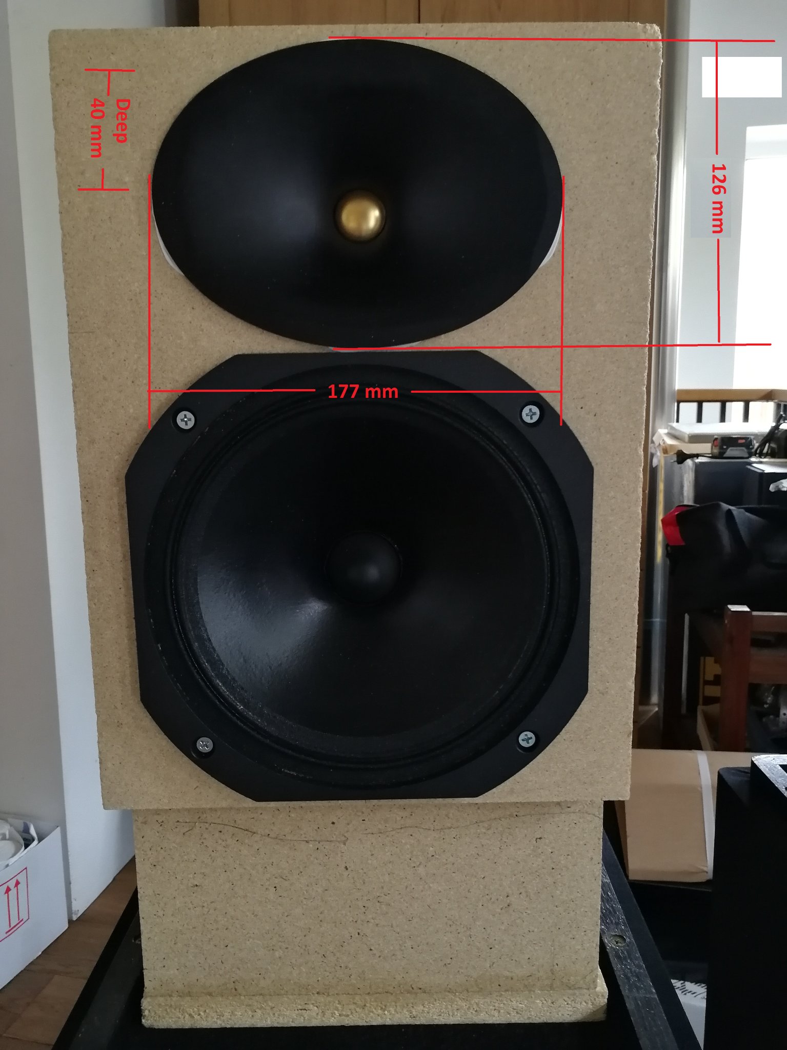

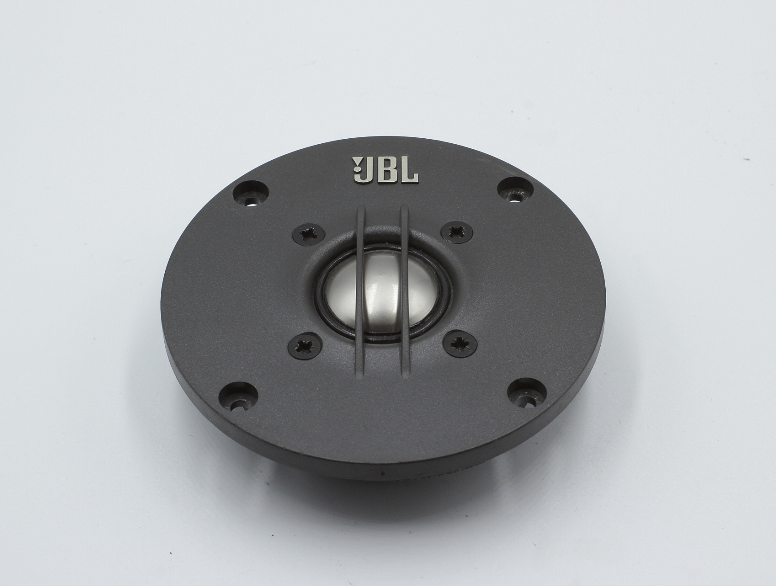

I've had quite a bit of experience with the cheaper brother of the Audax Gold dome, made by Audax (then owned by Harman Group) and used in the European JBL Xti-series:
Reactions: decramer and jawen
It's this one.
Parameters of the actual version:
Effective Piston Area Sd: 113 cm2
Moving Mass Mms: 7.11 g
Motor Force Factor Bl: 6.32 Tm
I'd choose this driver for (alternative) hi-fi 3-way systems > higher than average sensitivity and simple crossovers.
I bought one for testing. Actually 3. Linear as advertised. Quality very good for the money.

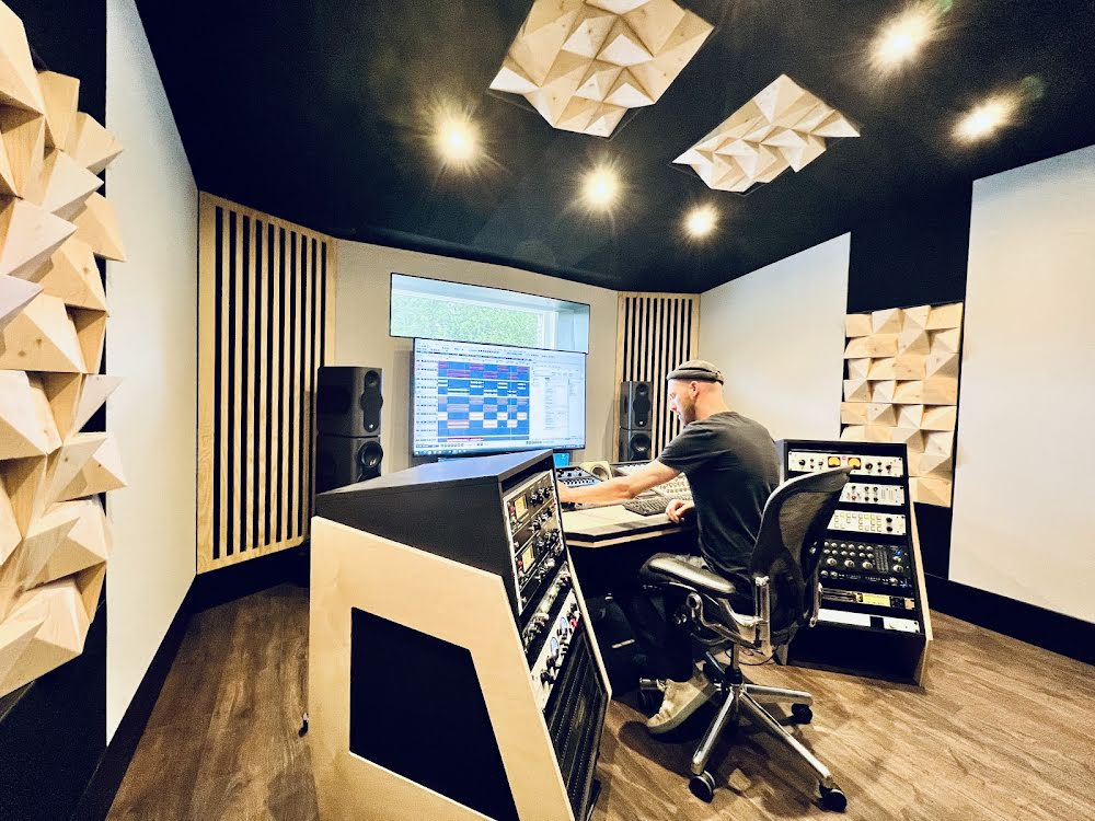

Based on my experiences with the Kii Three and SEVEN in which this cheap driver accounts for approximately 60-80% of the spectrum, a hint of harshness was noticeable during a demo of the (nonsensical) Kii Three BXT System at higher output levels.
"What the BXT does, is add real 'quality bass'. The addition of 8 extra woofers, each with a 250 Watt amp and with built-in DACs and DSP."
Those 8 additional woofers are pure overkill and simply pointless imo, since the midrange is still reproduced by a single Peerless FSL-0512R01-08.
The balance is completely lost here.
"A system has a chain-link logic when it's performance is limited by it's weakest subunit, or 'link'. When there is a weak link it is not made stronger by strengthening the other links"
The Kii speakers are not high power systems, they are nearfield monitors in the first place, used for mixing and mastering (and very popular for the latter). The hifi part is more an afterthought. The 8 woofers of the BXT are needed to make the cardioid response, where a big part of the signal (the ones that are not cardioid) are cancelled out by other woofers. So you need a lot of power and woofers to get bass volume. Therefor the BXT is not pointless i think. The secret sauce is the advanced dsp programming that makes the speaker neutral and carioid, not expensive esotheric parts (all are off the shelf OEM drivers, Peerless and Seas made).
But if you need high volume, other speakers do it better, that is certainly true. The drivers are just to small for that and it's not made for that. Most that i know who use this speaker use it in a mixing or mastering studio as nearfield monitor (even with BXT extentions) like here (Jerboa Mastering in Gent, Belgium)

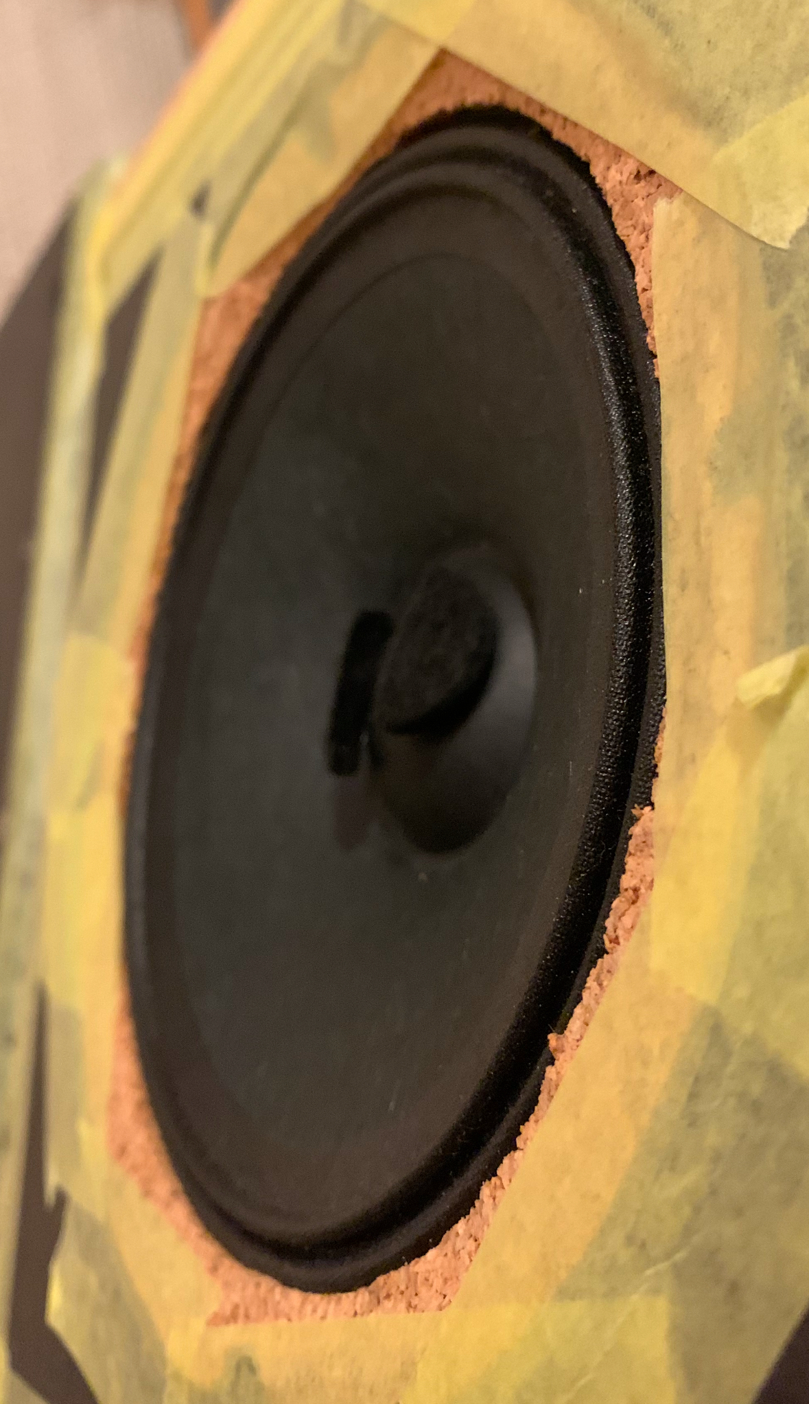

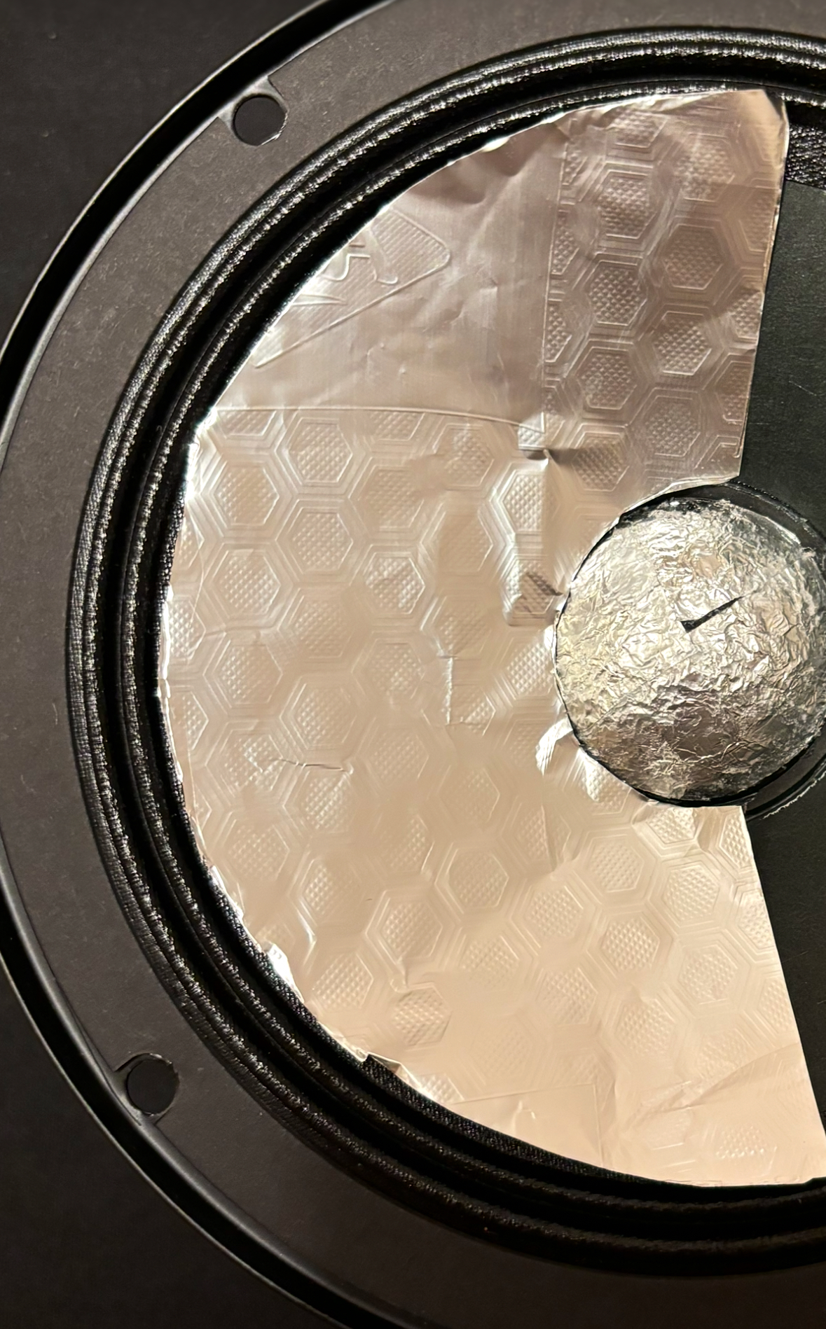

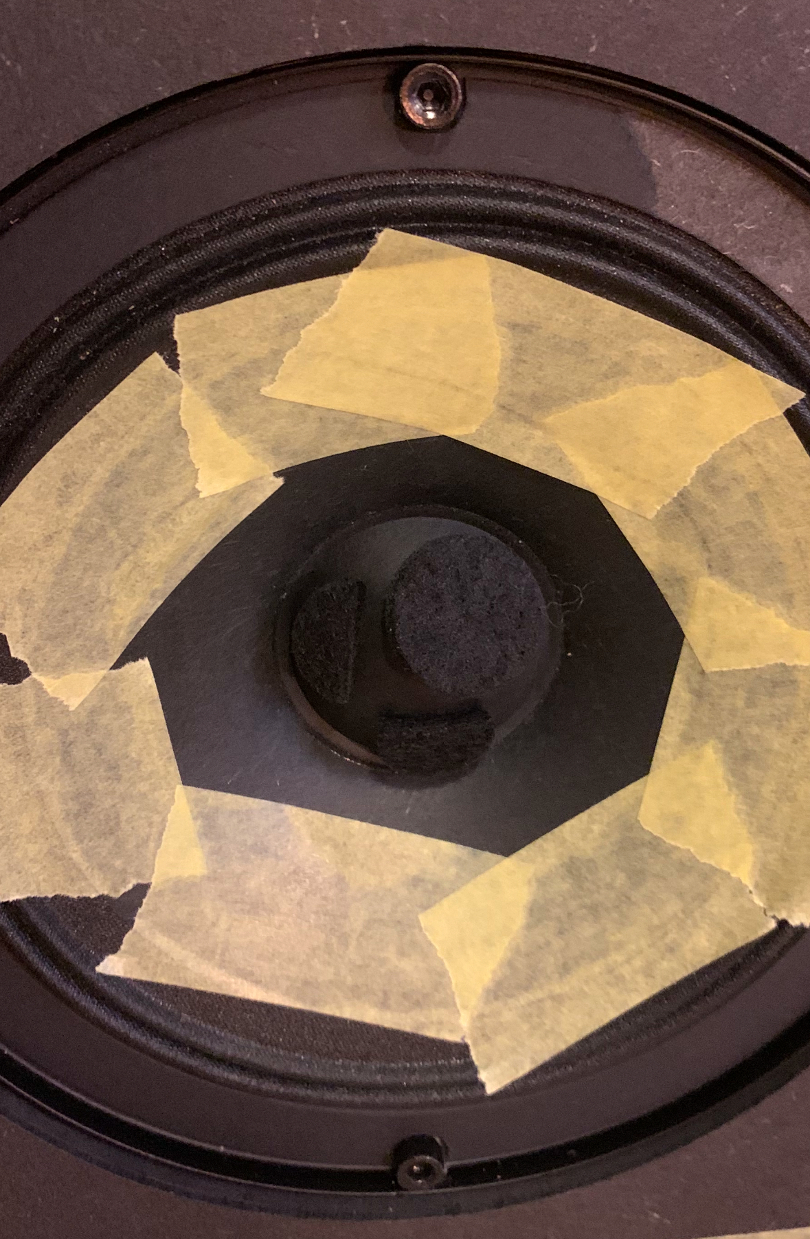

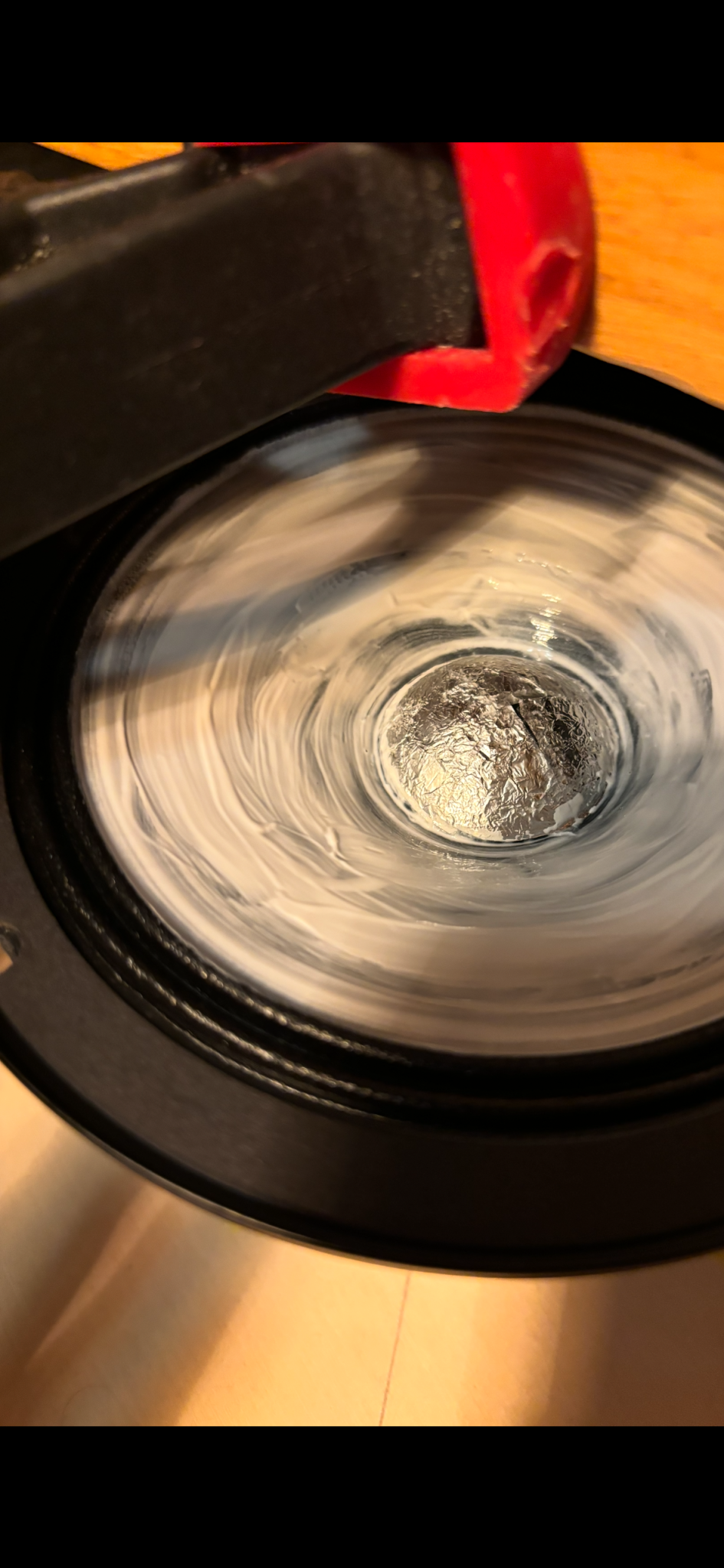

I experimented quite a bit with the Peerless FSL-0512R01-08
Even doing/learning some of the mods posted by @Freedom666
Painters tape (Tesa of course) and felt dots at dust cap is maybe all needed to improve that driver. Mounting flat give best dispersion. Ie NOT small WG in front ala kef.
Maybe cut off dust cap and install massive oak phase plug?
I guess also the lack of free ventilation around the driver is not good for best possible performance.
Again really wanted to like this driver. Also think it has its use cases.
Reactions: Ro808 and jawen

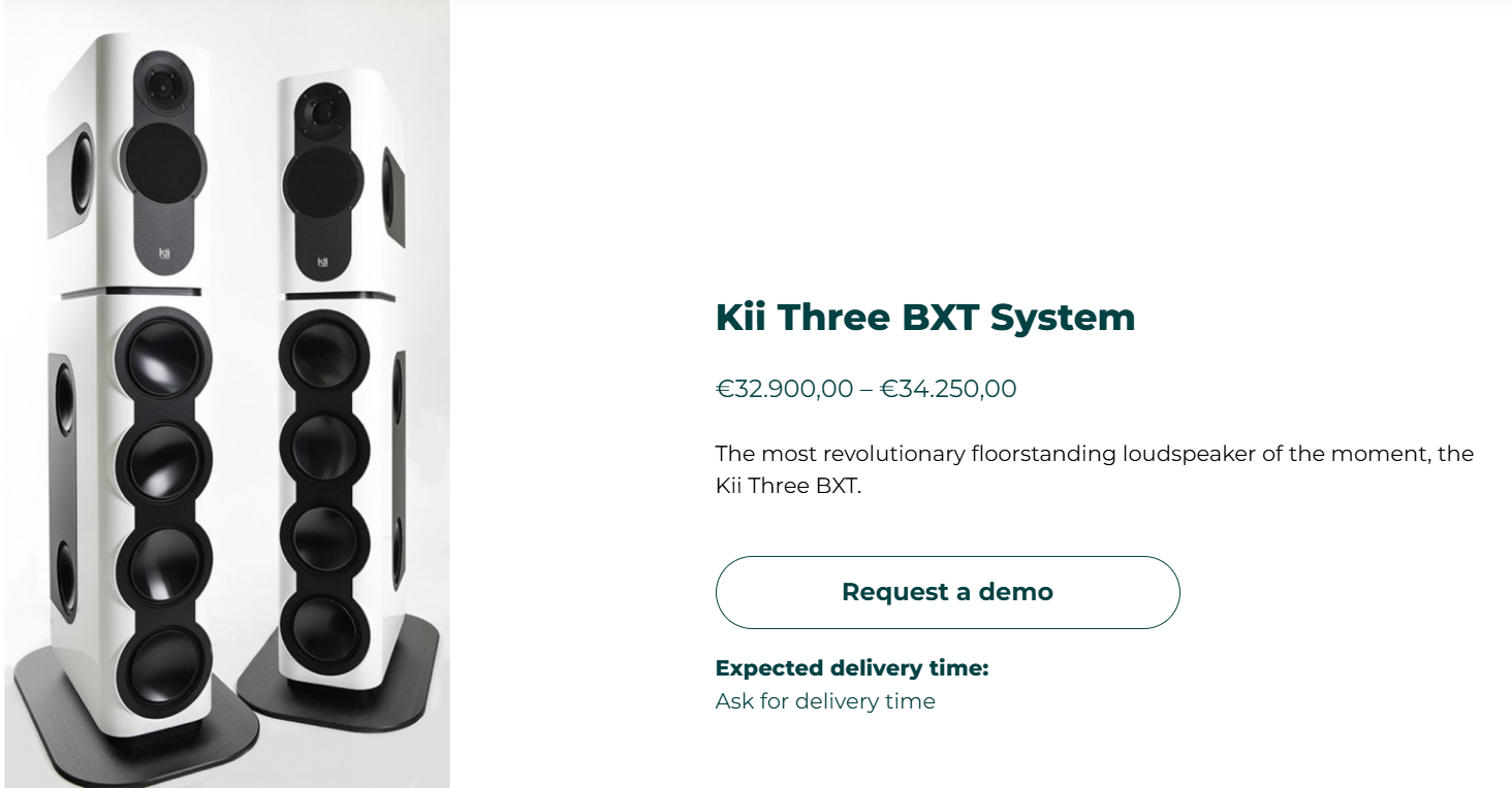

..."not expensive esotheric parts"...
That's true, because the wholesale price of the mid (~still the main driver of the complete BXT system) is €10.
In that respect, the retail price of that complete BXT system is 'substantial'.
