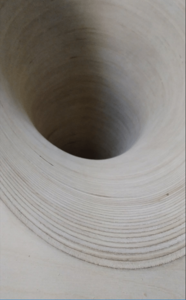

I've done a lot of while bleaching and I am very happy with the results. Let me know if you want sone pointers.My only hindsight, so far, is that I wish I had of put some effort into bleaching the horns whiter.
I probably won't bleach it now that I've started the staining process but a whiter wood would have provided even more contrast to the color scheme...
I was able to find a guy who gave me some really good tips on staining. His approach was to thin the stain with an agent, and then multiple coats.... 25/75, 50/50, 75/25 were the types of ratios thought of but I put my own spin on it.... My mix has been 2 teaspoons of stain to 3 cups turpentine.... first application was by brush. Used only 4 teaspoons of stain. Today I did several applications by sprayer, which uses significantly much less material due to a 0.6mm tip and it is awesome. The highly diluted stain, in combination with the small tip size, in combo with running about 10psi, create a very fine mist and subtle application.
The stain color is minwax aged barrel, and its giving a weathered look with the subtle application I've chosen. At the moment, I have some steel wool soaking in white vinegar, as I prepare for an application tomorrow. This stain recipe is used for a weathered look as well and will hopefully compliment aged/weathered look, I am going for.
I have to figure out if I want to add a black tea pre stain to add additional tannins to the Birch wood which interact with the vinegar solution to create color in the wood.

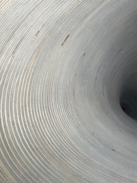

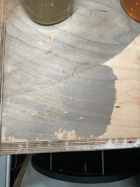

Middle, is the horns currently, after the several, very light, applications, there are hues of blue, red, and green, that I do like. It may look like an uneven application but the surface is not consistent in texture, leading to absorption rates that are not the same, or, almost, if not, non existent. Particularly, on 4 different lines from, beginning to the end, if looking into the horn, I can see something like a burst pattern, I think its related to machining. Looks fine from an artistical view if I can pull it off, I mean its symmetrical, so thats good lol, The major, looks blotchy, but in a natural way? It appears as shading, to me.
All the way to the right is the test results of the vinegar stain. In top most left of that pic you can see a bit of brownish/reddish....That's the undiluted concoction (white vinegar and steel wool, filled to the top, no lid) after 12 hours of periodic double boiler style heating and resting in their canning jars... The other 2 colors are the results of different dilution ratios with tap water...1:3 and 1:6 to be exact. I am hoping the consistency of this type of stain will, help bring all the colors together. Everything is going in the direction that I agree with so far, if the iron acetate brings the colors I like to the horn, that will be a plus.... the finish will change everything, once again.

just tried this today the tea definitely makes a less blotchy outcome my vinega stain came out dark grey . nor what I was trying for but it's quite niceI probably won't bleach it now that I've started the staining process but a whiter wood would have provided even more contrast to the color scheme...
