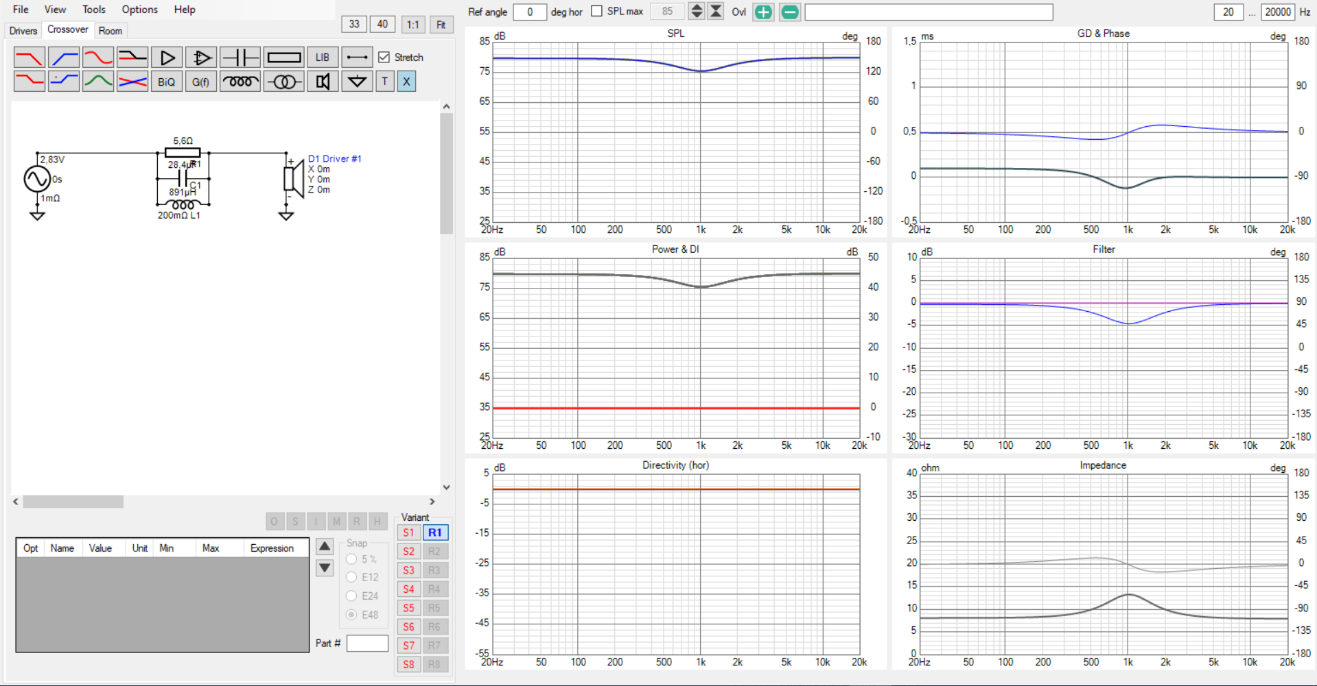

It's exactly what I ment, because series notch in parallel with driver filter doesn't work 😀 The impedance must increase in series with voice coil, so the notch filter components are hooked up in parallel with each other, but in series with the driver 😉 If only series or parallel is mentioned, it is easy to confuse which one it is 😀
To illustrate what they look like:
Parallel notch is name of this filter, it's in series with the driver.
Here filter whose name is series notch, but it is in parallel with the driver. This does not work, because amplifier short circuits it if you analyze the circuit from driver perspective.

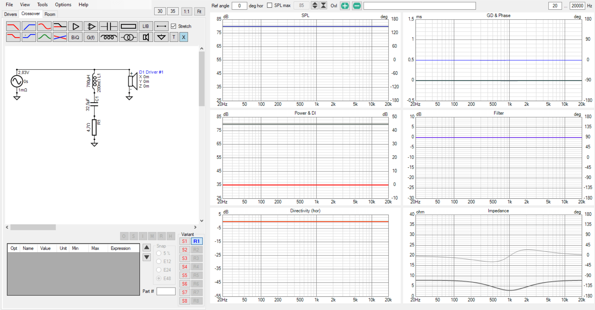

Draw simple circuit consisting of power amplifier with low output impedance, and then a woofer connected to it. Now, add another voltage source next to the driver, backEMF through which some of the driver motor distortion mechanisms affect! Now, using thevenin equivalent and replace the power amplifier with a short (or very low impedance). Now you have circuit with distortion voltage source in series with driver. You can add series impedance any point in the circuit to reduce current from the distortion voltage source, but if you have the series notch in parallel it does nothing as it is shorted (through power amplifier very low output impedance you replaced with a short).
It is the distortion mechanisms that make back EMF voltage that are affected by all this. The voltage gets varied as the driver moves, which immediately appear as current over what ever impedamce there is which immediately affects force what makes cone move and you measure acoustic distortion.
Breakup does its thing like always, but we've just reduced all current in the circuit by addin parallel notch in series 🙂 you could use current control amp instead of voltage amp, doing the same analysis again you'd see the circuit impedance for back EMF is already high and distortion is reduced. But also electrical damping is gone for woofers resonance. You could lower impedance by adding series notch to allow electrical damping at the driver resonance, if you wish 😉
But yeah its just explanations without proof, but this is how it appears to work. It is quite easy concept in a way, easy to utilize with what ever project, just analyze circuit impedance from driver perspective, driver as voltage source.
I am familiair what lumped circuits are, thanks (I even showed one couple of posts back).
It's obvious that we are talking about a parallel notch in series.
No idea why there is confusion about this even, this was already clear from de beginning?
As far as I am aware there is not even another way of making a passive NOTCH filter
It's all about impedance, so as @markbakk rightfully wondered, this would also work with an high(er) order passive filter.
Since you're blocking the same things, as well as a CC amplifier, since it does the same thing as well.
(thevenin equivalent would be open instead of a short)
You literately describe this in your explanation.
The mechanism behind it is and was already very clear.
The ins- and outs of it, investigated with practical measurements, are not.
Didn't notice this was my quote."But since a series notch works on a very similar way (seen from a current point of view)",
This i do not understand. The study of Purifi shows a different result. So help me understand this statement.
Purifi doesn't show a different result, so I don't get the question?
With series notch I mean parallel notch filter in series with the woofer.
Which is in short a series notch filter.
In a passive filters you can either have a series notch or parallel notch (which requires an addition series impedance or resistance).
Otherwise it's not a notch but a (very small) bandpass.

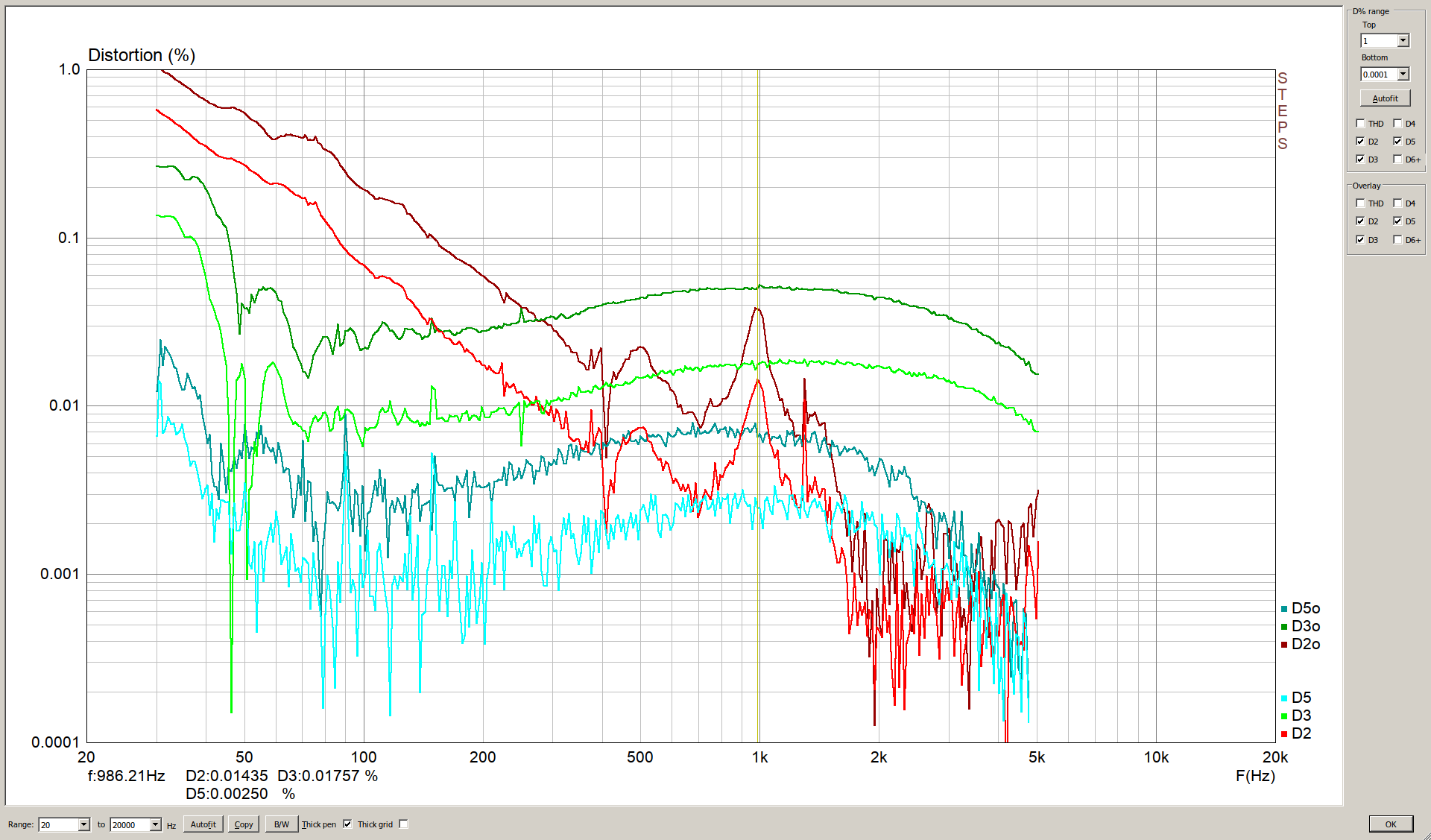

edit. I've got woofer in use with quite serious breakup peak. Currently having series inductor with it and impedance is quite high already and not sure if I hear any of it with or without. Ordered some more parts to try a notch for fun. Parts should arrive soon but I'm not sure when I have chance to measure. I need to record how they sound, in order to AB, gonna use dynamic directional mic.
I did measure distortion with or without the series inductor and later on noticed the distortion was mostly below noise floor haha, not a successful experiment. Well, it's rare to have everyone out the house to take such measurements.
If you don't mind, I'd like you to explain to me what the D2 does at 1kHz, pleasecurrent control is eliminating all distortion from dynamic modulation of Le. But not distortion from modulation of Bl or distortion coming from the mechanical domain

I guess your amplitude response has a peak at 4 kHz, does it ?
Regards
Charles
Edit: Wrong conclusion of mine - I was staring at the 1 khz peak.

probably some cone breakup distortion reflected back electrically. Was the amplifier drive voltage the same in the first plot and the overlay with 20 ohms in series?If you don't mind, I'd like you to explain to me what the D2 does at 1kHz, pleaseView attachment 1207822
Background:
https://www.diyaudio.com/community/threads/drive-current-distortion-measurement.402566/#post-7434990
That is my best guess too.probably some cone breakup distortion reflected back electrically.
Vice versa ;-)Was the amplifier drive voltage the same in the first plot and the overlay with 20 ohms in series?
No, the measured current was about the same.
When I finally had the plots on the screen, I just thought: That's very interesting.
