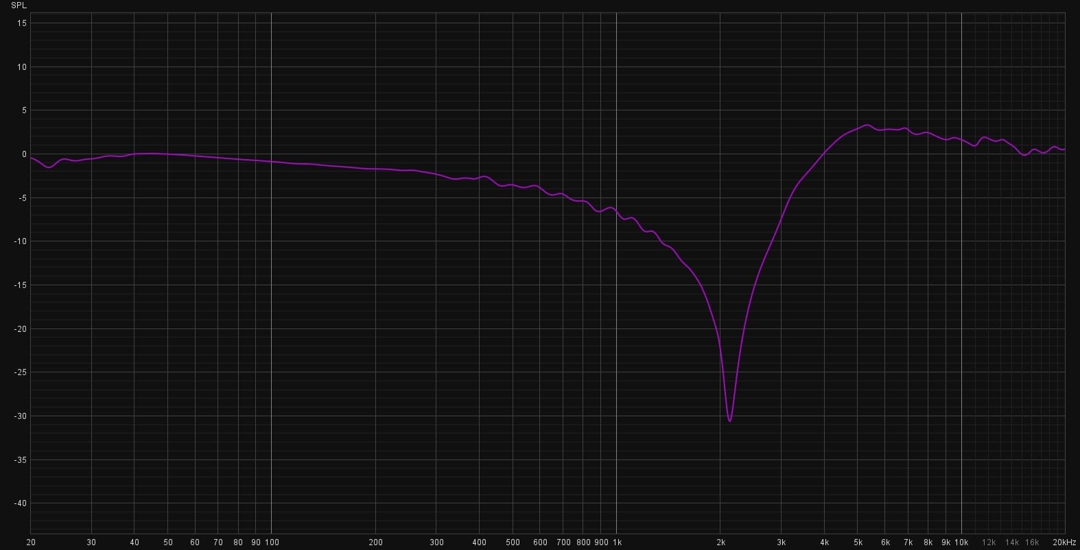

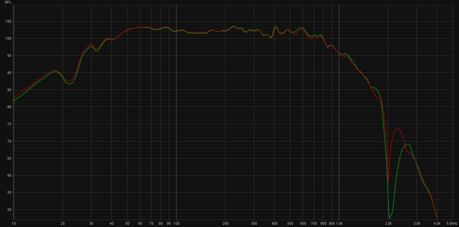

After starting to look at how passive notch filters can reduce harmonic distortion at subharmonic frequencies below cone breakup peaks in active setups, I've been particularly interested in seeing what this new bag of tricks might do for the lovely set of Dayton RSS315HF-4 I have sitting idle in my shed. This is an excellent "hifi" subwoofer with a 12" aluminum cone and a low-distortion motor. However, it has a pair of very severe cone breakups at ~1765 Hz and ~2660 Hz with a sharp cancellation in between.
I spent some time investigating various filter configurations yesterday, but will just share the final one I settled on: I ended up with a single, fairly deep notch filter centered between the two breakup peaks, pulling both of them down by about 15 dB. The filter consists of a 1.5 mH air core inductor and a 3.63 uF capacitor (made from 3.3 and 0.33 plastic caps in parallel).

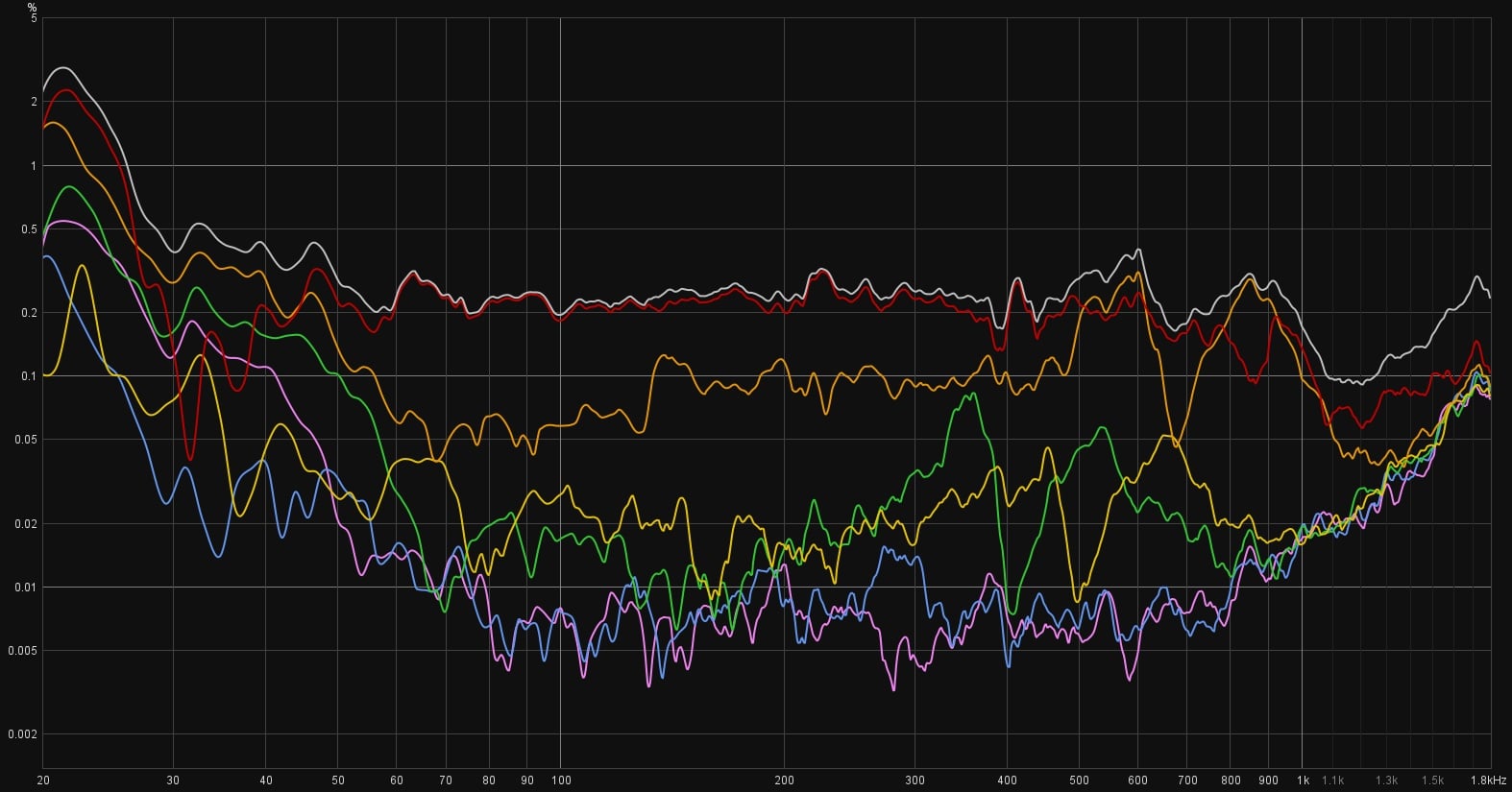

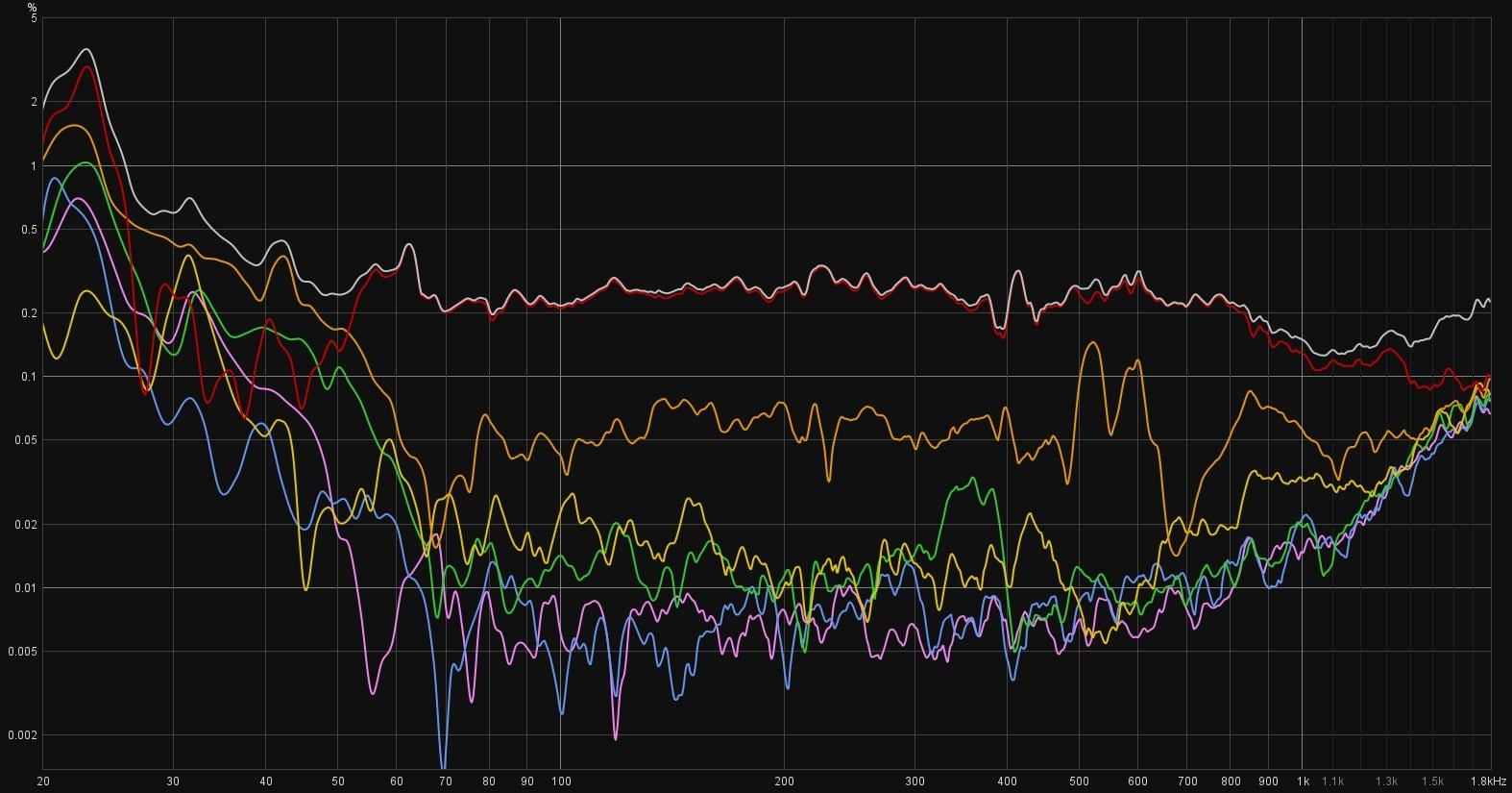

To simulate a somewhat realistic use case, I added an active 4th order (24 dB/octave) Linkwitz-Riley low-pass filter at 1000 Hz.
The resulting curves show a significant reduction of all higher order harmonic distortion components in the range between 200 Hz and 1000 Hz, especially at the subharmonics of the two breakup peaks. In effect, the passive notch makes this driver perfectly usable in the mid bass & lower midrange (assuming you match directivity), which is quite a feat in my mind.
Just listening to the driver running "full range" but EQ'd flat with and without the passive notch, the difference in clarity / distortion is striking.

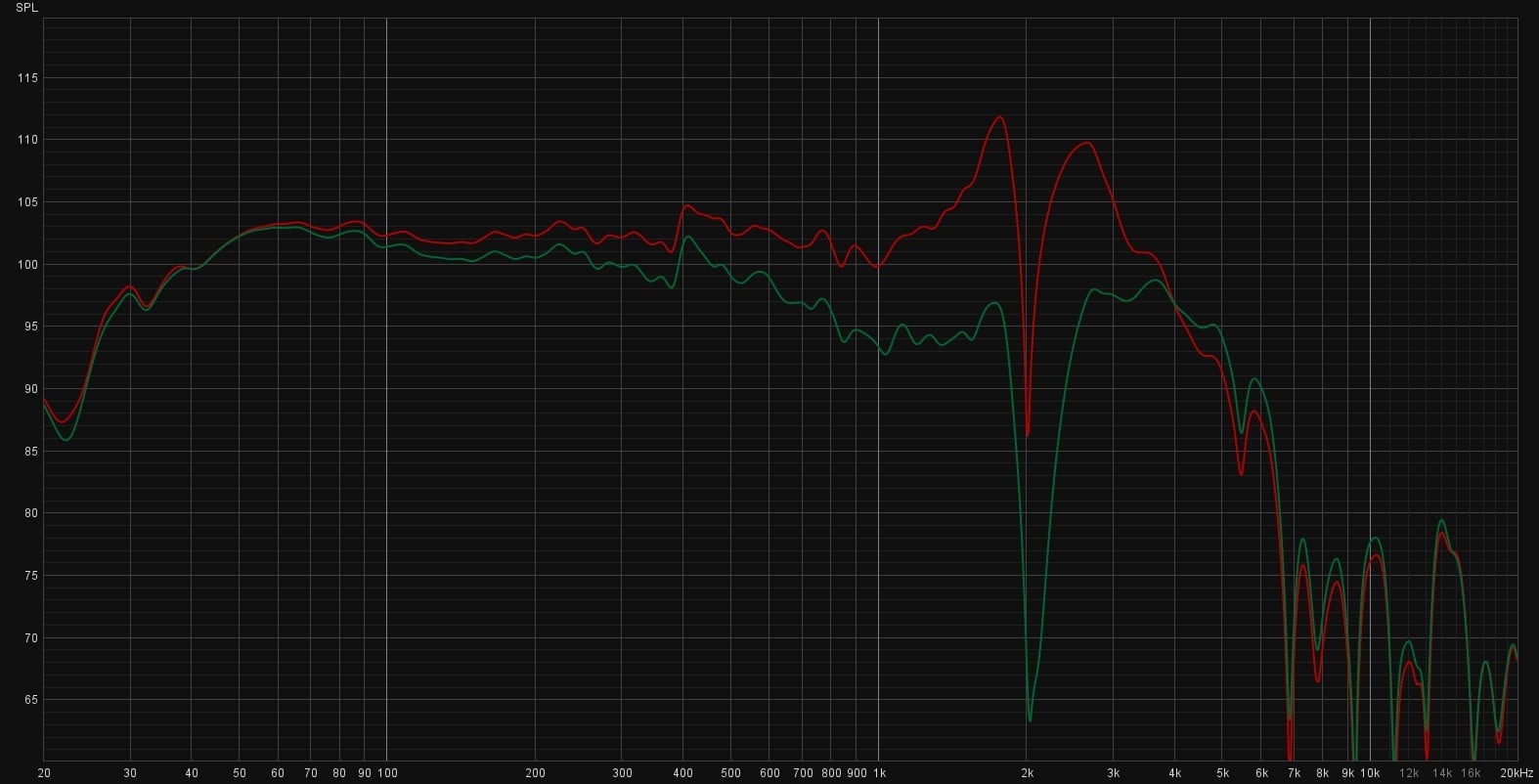

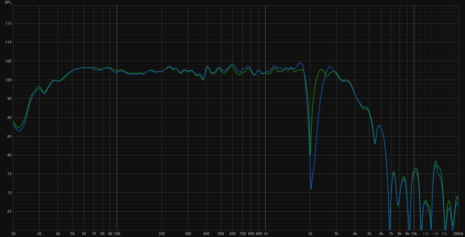

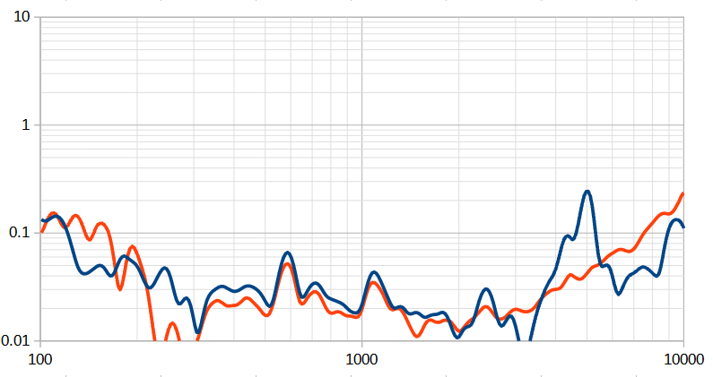

Also, I don't understand why some of you keep distortion in absolute numbers.
Which can be hard but mostly annoying to read, counting dB differences.....
So here are the Purifi results given in percentages (can also to in relative dB).
I had to trace the curves, so there are some artifacts.
Also resolution in the lower dB region isn't great this way.
Blue = no passive filter and notch
Red/Orange = with passive filter and notch.

Not really an "artifact". Think of it this way, the signal goes through a nonlinear transfer characteristic and out comes the distorted signal - harmonics, etc. Then this distorted signal passes through a filter which can accentuate or decrease the harmonics (and fundamental) as they pass through the peaks and dips in this secondary filter. The filter changes the harmonic and fundamental levels thus changing the %THD, but the harmonics haven't really changed after the nonlinearity, its the system FR that changed.So you're saying as well, that this is just a measuring artifact basically?

A proper comparison would be to apply the passive notch AND eq the peak back actively to its original level. So much for Facebook?

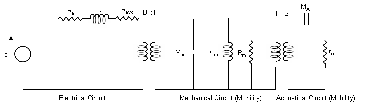

The distortion reduction we get from a notch in series with the driver: the signal gets distorted by the motor and the distortion can be modelled as a back EMF signal (dynamically varying inductance from position dependent and hysteresis). For example, a 1kHz signal results in a 3kHz back EMF which results in a 3kHz current that gets transformed into driving force. If the notch filter increases the loop impedance at 3kHz we reduce the 3rd harmonic current which directly maps to reduced 3rd harmonic in the acoustic output (assuming this is dominant). If we have a mechanics/acoustical resonance at 3kHz we will se a distortion peak around 1kHz since the 3rd harmonic gets amplified by the resonances in the mechanical domain. The notch can then both EQ the response of the fundamental (dip the 3k current to force response) AND attempt by hate the harmonic at 3k generated by the 1k signal. This will thus flatten the distortion peak around 1k.
the BL ‘transformer’ is of course transmitting energy both ways. This is surely mapping distortion from the mechanical domain back to the electrical domain. however, this mechanism is predominant around fs where the velocity peaks and drops off fast with rising frequency as the driver gets into the mass controlled range. below fs, the distortion of the current can exceed the distortion of the acoustic output. reason: around fs the high electrical damping from the strong high BL motor acts as a motional servo which can suppress distortion from the suspension. This requires that the current is distorted to compensate.
Gets amplified by resonances? Sorry, I don't follow that.If we have a mechanics/acoustical resonance at 3kHz we will se a distortion peak around 1kHz since the 3rd harmonic gets amplified by the resonances in the mechanical domain.
In either case the peaks we are talking about, are always mechanical (cone) resonances?
So happening in the mechanical circuit.
Never electrical or acoustic resonances.
The BL at these frequencies is constant, we are (very) far from Fs (no BL(X) ), so I am a bit confused why you're mentioning it?
