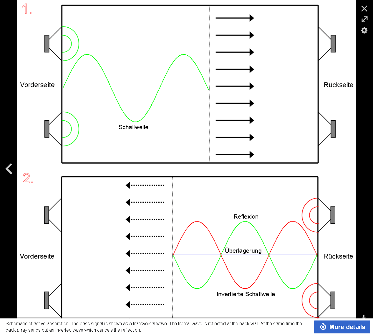

I'm using simle normal DBA https://www.diyaudio.com/community/threads/my-double-bass-array-with-low-q-subs.392998/; none of the EQs was hurtfrom @Flaesh... He describes
Thx for link
Does that include using peak eq on the rears to tailor the response?I'm using simle normal DBA
Isn't "simple normal" having all speakers in phase at the listening point where as you use your rears to cancel the impulse as it comes from the front?
Nope.Does that include using peak eq on the rears to tailor the response?
Rears are delayed (delay=room lenght) and slightly attenuated, thats all in my case now. See DBA treads 🙂
