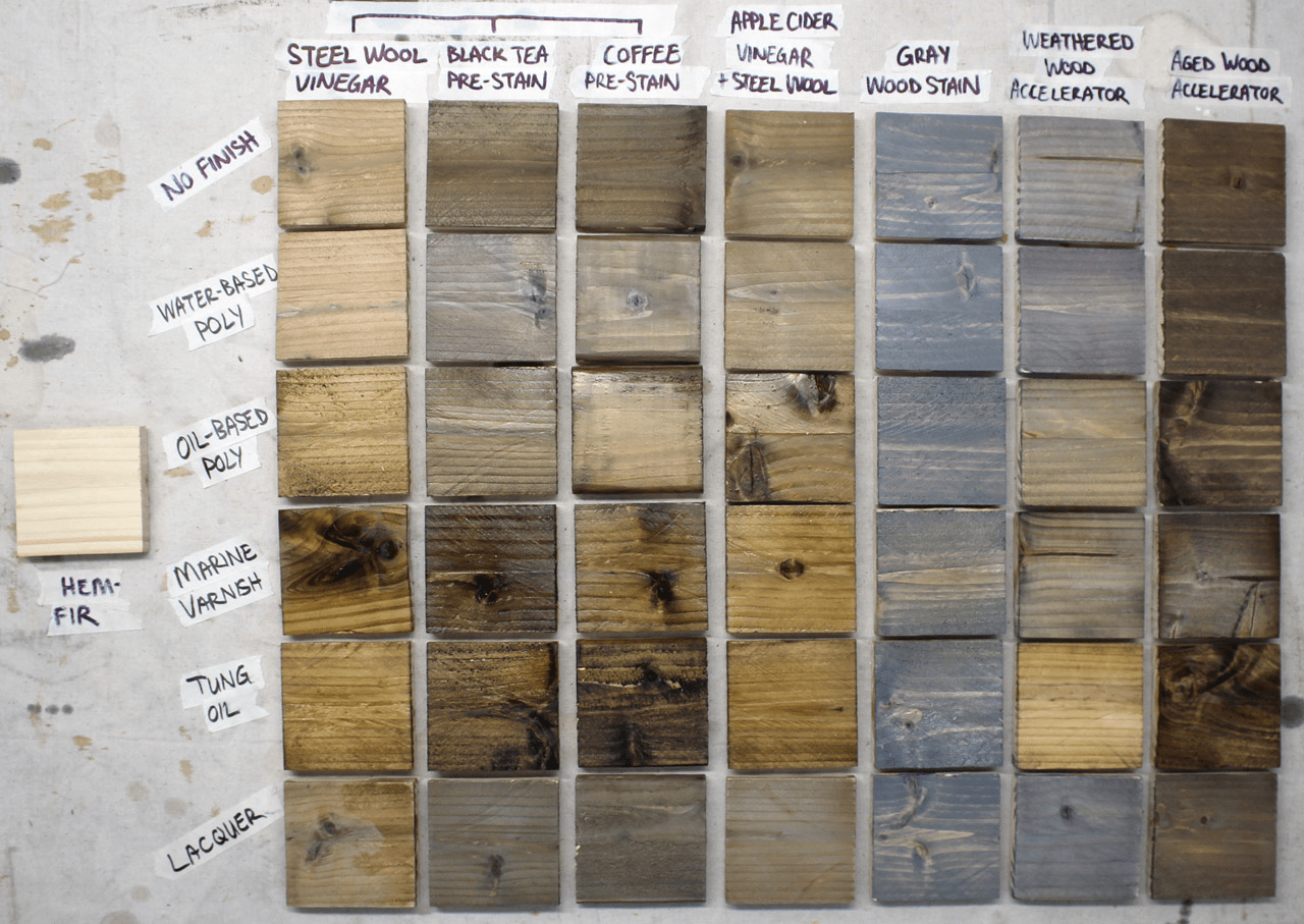

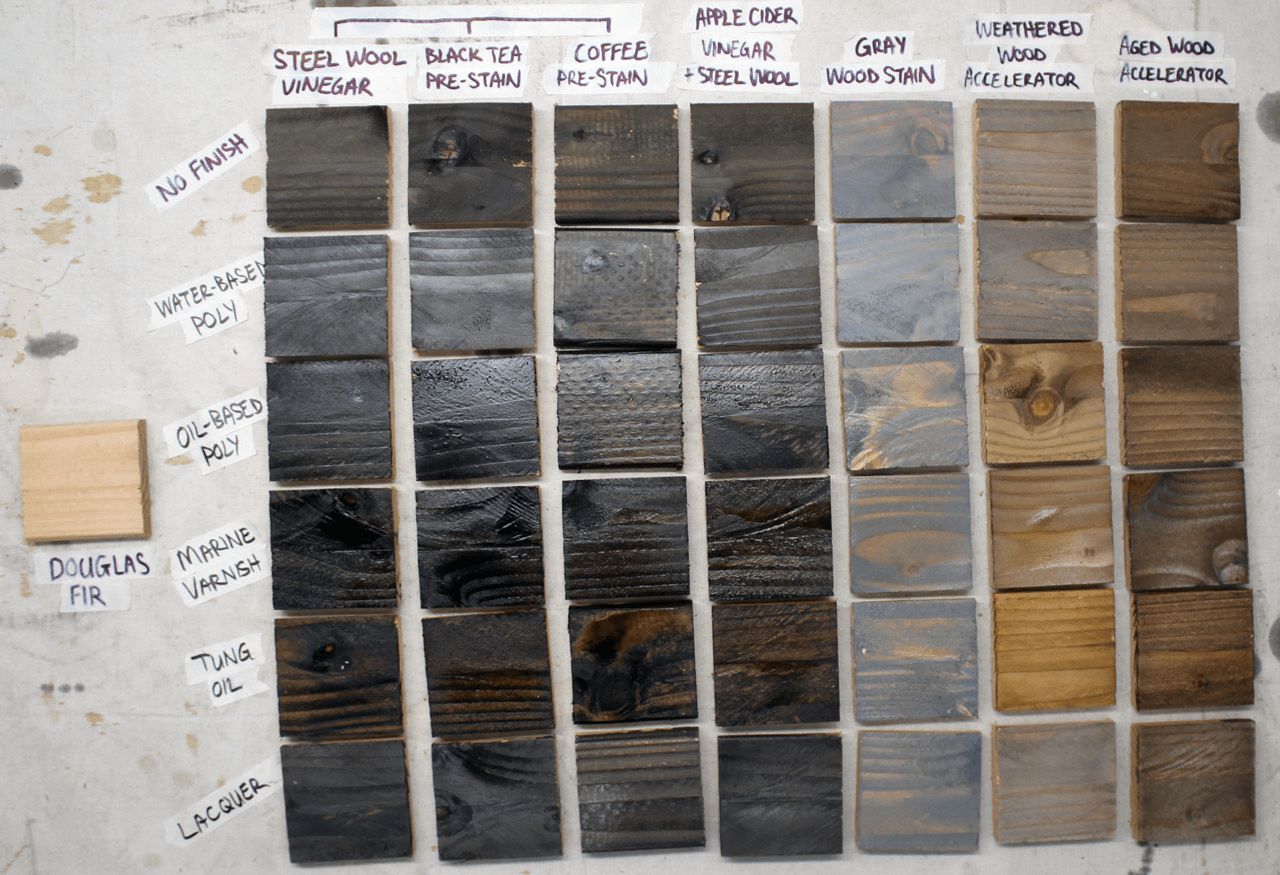

This is the result after googling...
https://www.google.com/search?q=sol...ACBBiAYBkAYK&sclient=gws-wiz-serp&bshm=rimc/1
The best "wet look" finishes come from the two part paints like used in automotive. They are also the most durable.This is what I mean by "wet look". The oil based finishes are more glossy.

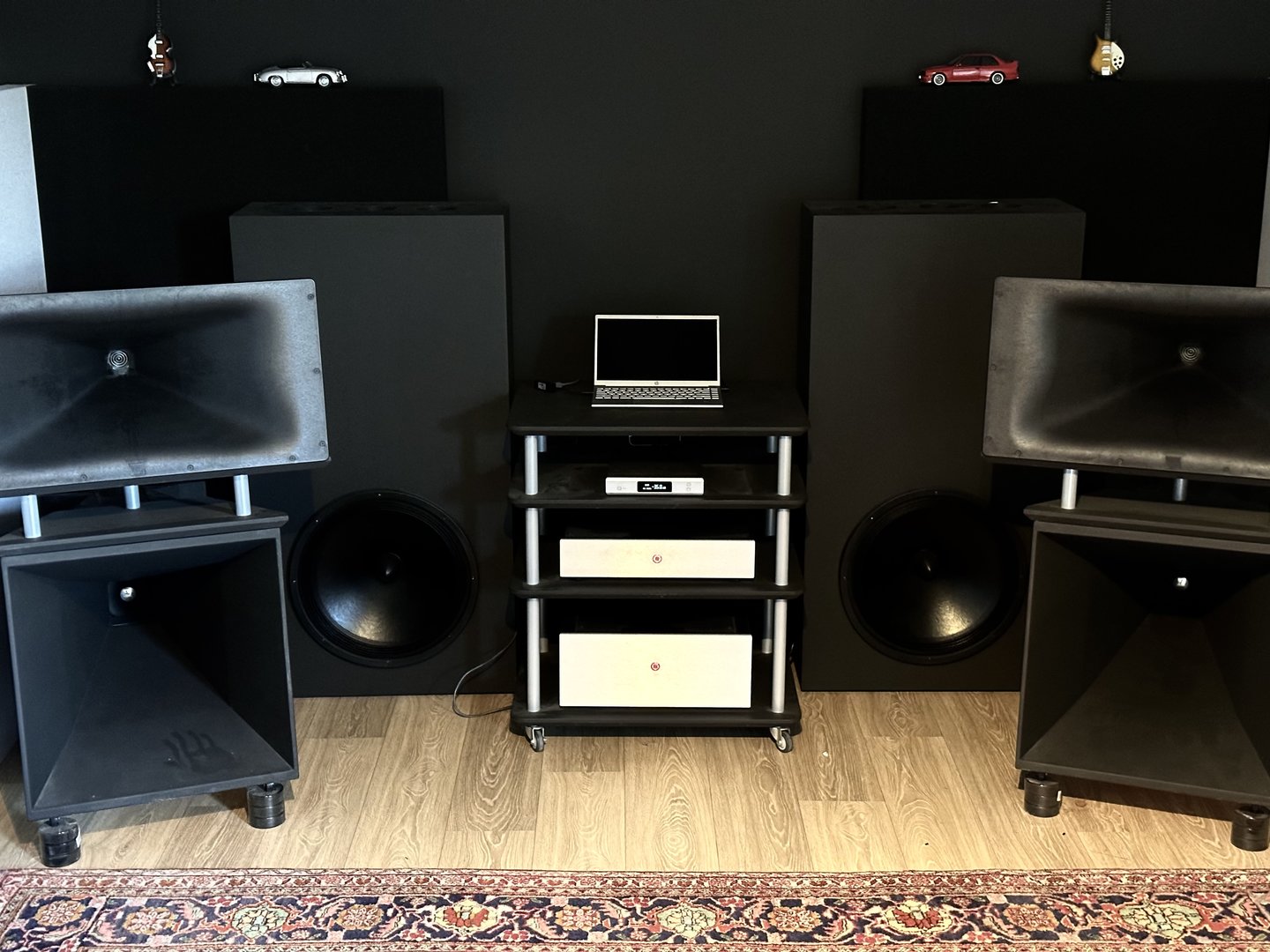

I need to make a more compact system and wonder if i can «downscale» with existing components to TD18 in a closed cabinet with JBL2451 Truextent beryllium on top. Simple two way.
Today i have TD18 in 155 vented, front loaded midbas horn (110 cm long) and JBL 2384 horn on top:

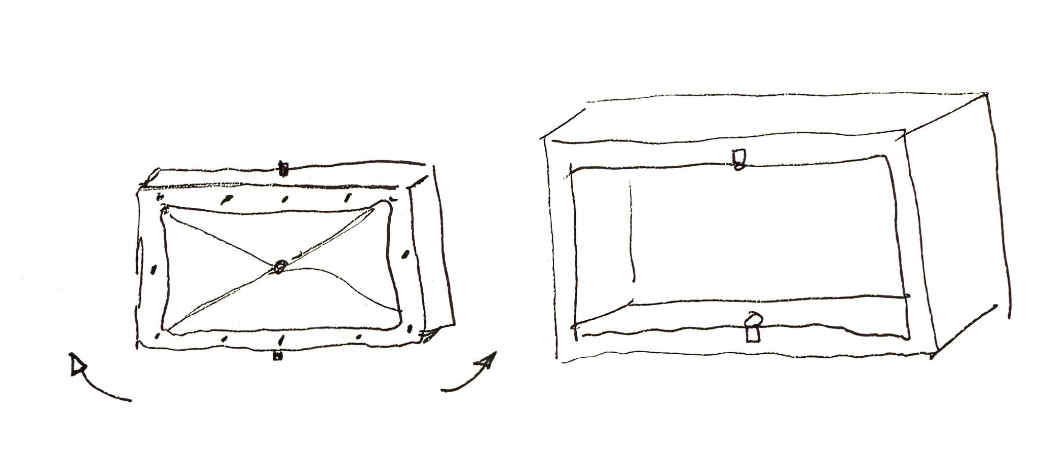

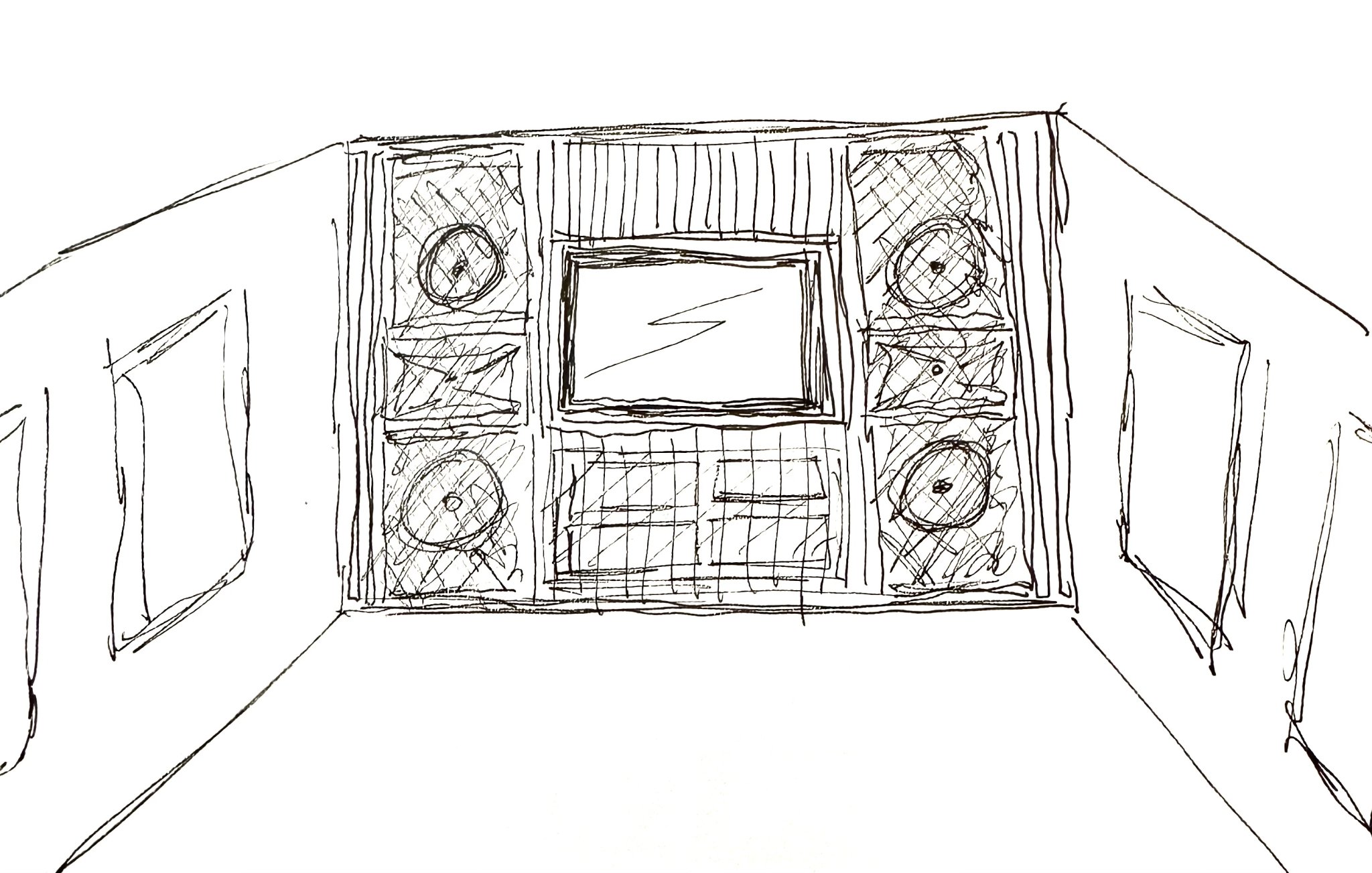

One option for me is to keep the JBL2384/2451 beryllium and build a two way completely hidden inwall system with JBL 2216nd. The 2384 horns kan be mounted in a small frame in a niche for a slightly toe in:
