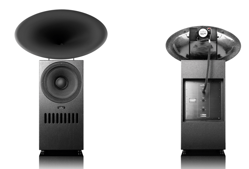

Ascendo Black Swan. Simple 2way, not sure where its crossed over, or the dimensions of the horn, along with the fc. I guess I'm not the only one in like an elliptical horn. The article on Rectangle horns with rounded corners is intriguing. I think @docali showed us some designs of rectangle horns with rounded corners in the past, but I would not have known to appreciate them at that time. Still, I think an elliptical horn is a good middle ground in between round and rectangle.
Well, it's not new design. I've not seen this one before but my first thoughts when i saw the picture was: looks like Red Spade audio PSE144, without the MEH part.

I had built a prototype of an elliptical OS with a 15" driver back some 15 years ago. It worked well, but not well enough to have beaten a round OS waveguide, but the later was much easier to make. So I did not go forward.

What size are the woofers, and what is their power drive ?
