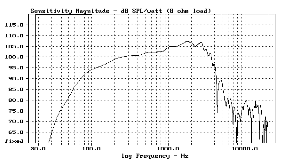

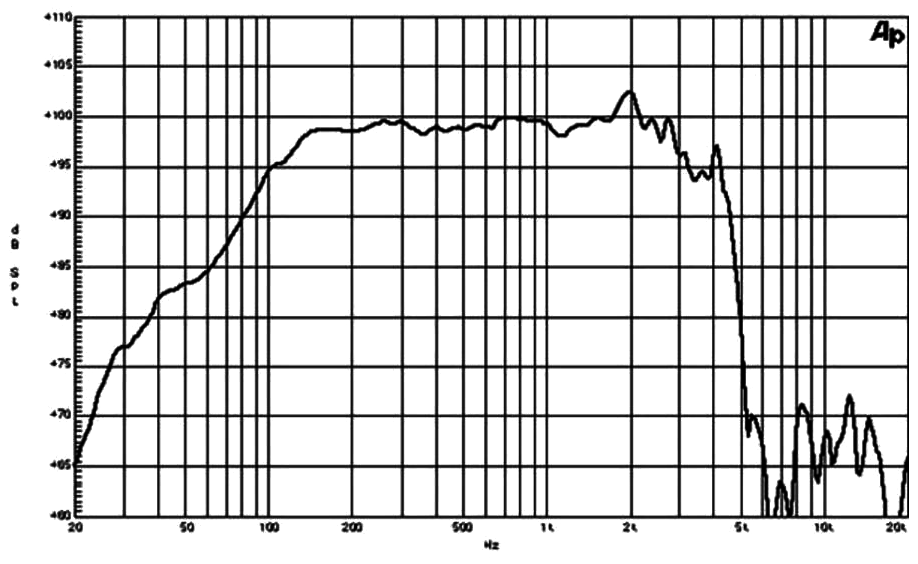

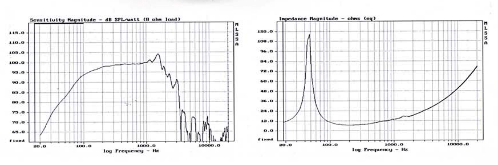

The response of this woofer is about as linear as it gets. It was available just before the emergence of class H and D amplification.
B&C is a performance/technology based company and does not brag about subjective matters, except in this case:
"Best sound reproduction, excellent flat response to 3kHz."
The response of the modern equivalent:

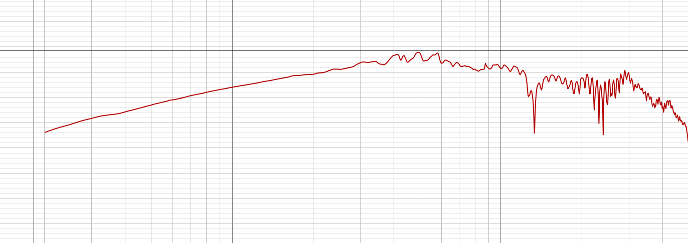

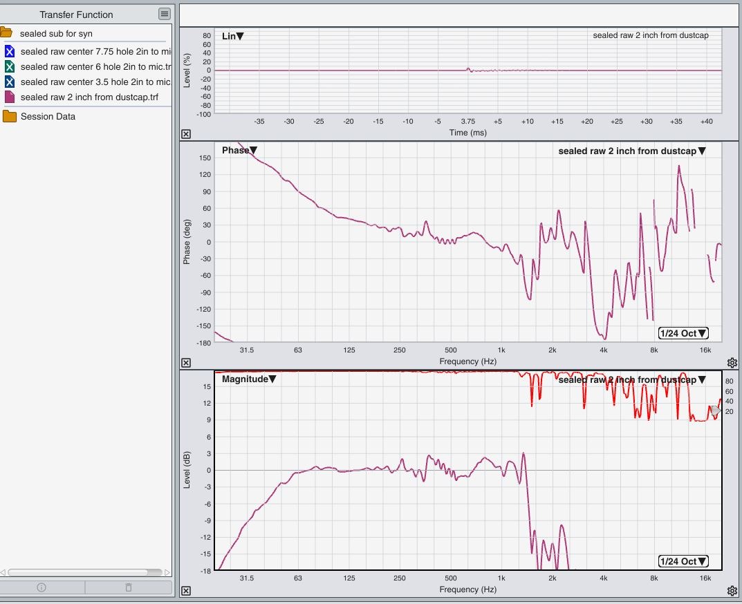

Here's the 18n862 in a sealed box, that's close to a 21" cube external.
No stuffing, driver isn't bolted in... lol .
Raw, no filters.
Sub is on floor pointing up, with mic 2-3" from dust cap....
Measurement made moments ago...smooth sucker, huh?!
( I'm in the process of seeing how well the driver might work playing thru ports ala a synergy. I lay plates on top the driver with various ports cut into them)
Reactions: 3 users
It's probably the standard measurement protocol. Perhaps Dr. Geddes knows.
While it may seem overly smooth, B&C isn't known for dressing up, contrary to some other companies.

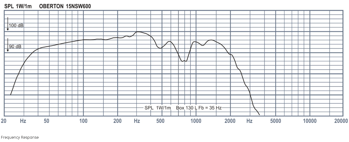

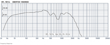

This is another 15" driver from the same era.

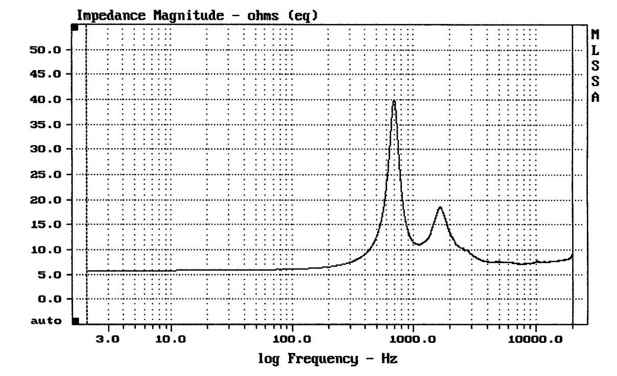

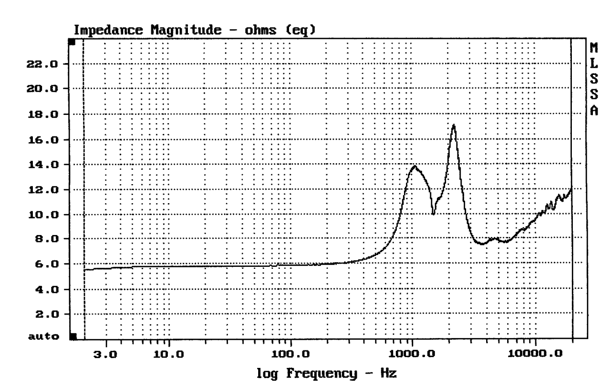

This is an independent imp. plot of a B&C DE500 compression driver behind a short waveguide. Also fairly smooth.
Same waveguide + B&C DE250 (different scaling):
Same waveguide + my RCF driver (different scaling):

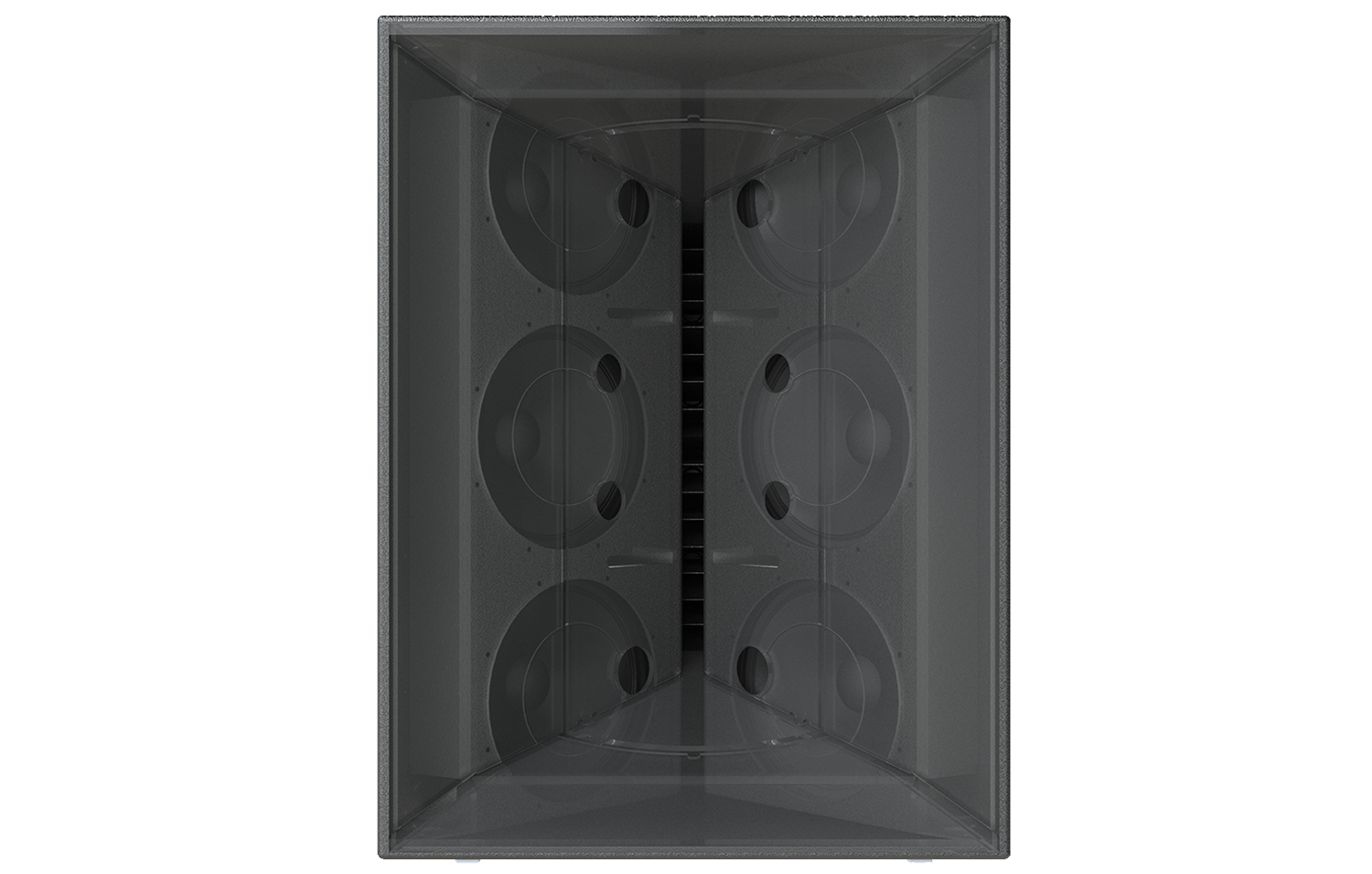

A Jericho J1-94 clone? ;) (Still my favorite Danley Product).
I believe a stripped down redesign could potentially make it a very capable hi-fi or studio speaker. A single BMS 4594Nd + 4x 4" or 6" + 4x 15" or 18" should suffice. And while it works, I'd rather get rid of the combiner and instead optimize the throat section and possibly add curvature to the horns.
I'd probably also convert the low section to this; remove 2 and bring the remaining 4 closer together:
Reactions: 2 users
I'd probably also convert the low section to this; remove 2 and bring the remaining 4 closer together: View attachment 1111323

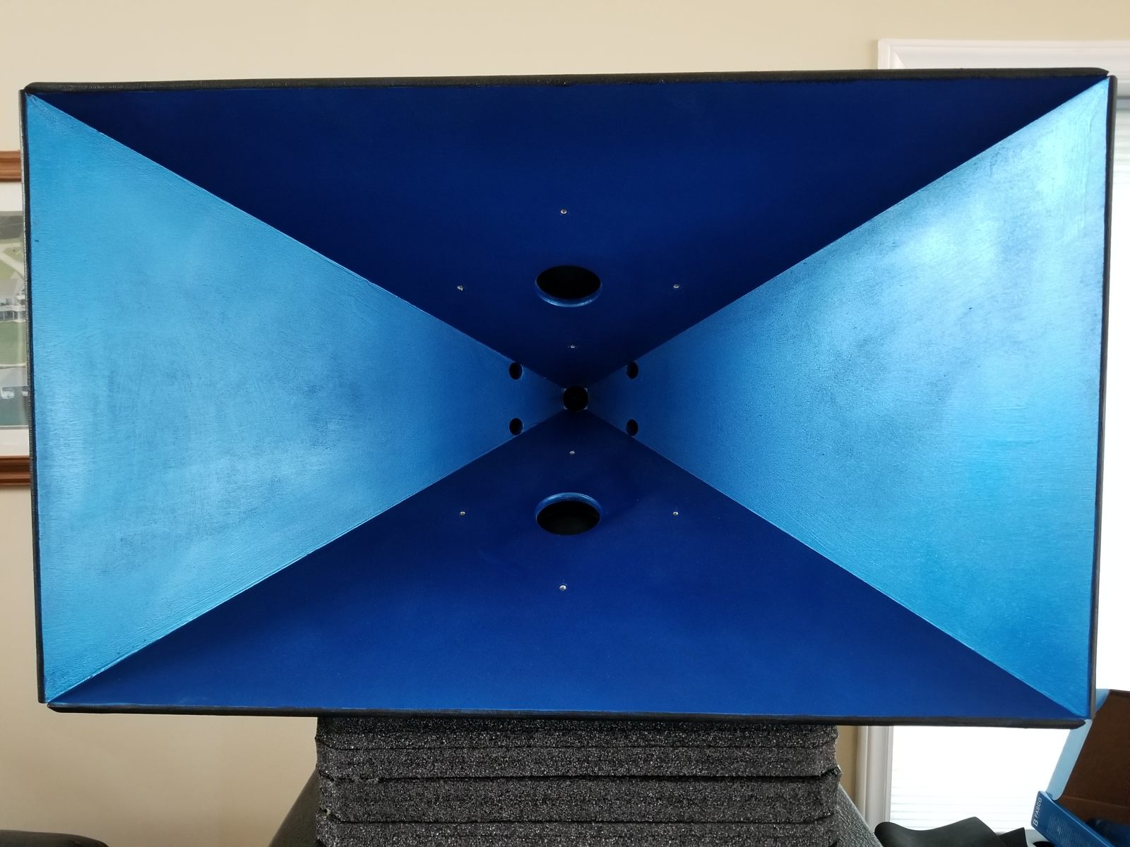

I'm toying with the idea of adding two 18"s onto the sides of the synergies as i now make them. They would need to be a little larger than this 36"x22" mouth size, and I'd have to enclose the 18"s...so it would be a heavy immobile beast. @ncbluetj's BASH thread has me all fired up.
The idea for now is use the same drivers, and the same 90x60 horn: BMS 4594HE, four B&C 4NDF34", two 10"s or 12"s (not which sure yet), and two non-vented 18n862's.
I like syns at ear height when standing (did away with a listening chair 20 years ago lol).
They currently sit on top 48" tall, dual 18 push-push reflex subs.
If i use the dual 18"s in the new syns, I lose the stands ...big bummer. Guess I'll need to set them on either a Labhorn or JTR Orbitshifter (never could bring myself to sell the PA subs) But that brings the speaker up to a 6-way...yikes and ugh.....
On the positive side however, that would solve/eliminate any potential need to vent the 18"s mounted in the synergy (for trying to keep full linear SPL down to 30Hz)
