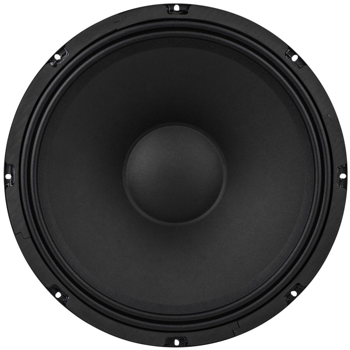

Very nice driver, but not exactly cheap (€468.88 each, if you buy 4, excl. shipping).Yeah I had my eyes on these Oberton 18NSW700
Can't find them for sale...
This one's 212,33 Euro. Admittedly, it's not as efficient.
Efficiency (2.83 V / 1 m.) - 98 dB
Resonant frequency - 30 Hz
Coil resistance - 5.0 Ohms
Qms - 4.40
Qes - 0.29
Qts - 0.27
Cms - 0.12mm/N
mms - 235 g
BL - 27.6 Tm
Vas - 269 L
L 1kHz - 2.56mH
L 10kHz - 1.05mH
SD - 0.1260 m 2
Eta - 2.43%
Coil diameter - 100 mm
Maximum linear working range of the coil - 22 mm (pp)
Maximum deflection without damage - 50 mm (pp).

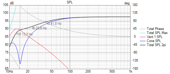

Not so much dislike as I just don't see any advantages. With multiple subs, headroom is seldom an issue unless very low power subs are used, so excursion limiting isn't a big advantage. Closed boxes can operate below Fs, ported can't. and closed boxes are so easy to design and assemble. What's not to like?With the filter knee able to be placed so low, why do you not like ported subs again?

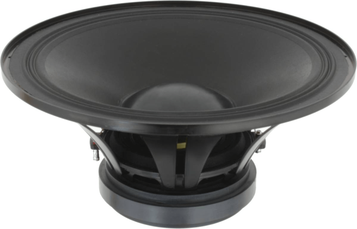

At $67 each, this thing goes low, albeit in a huge cab.
I wouldn't cross it high though.
Which driver is this, please? Thanks. Glenn.
That was the 4 Ohm version.
Don't let the price fool you. Every Tymphany driver I've used has far exceeded my expectations.

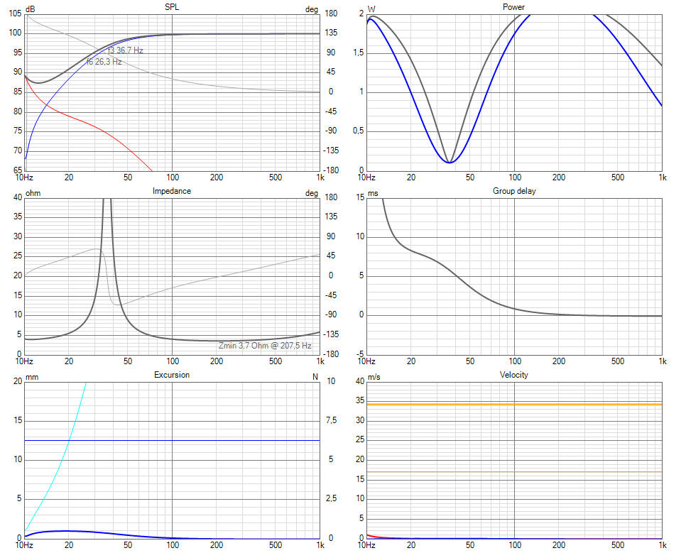

If tuned very low in a giant cab the sim naturally tends towards the impedance, excursion and GD of sealed. This is 2x (parallel) in 2000l @ 10 Hz.

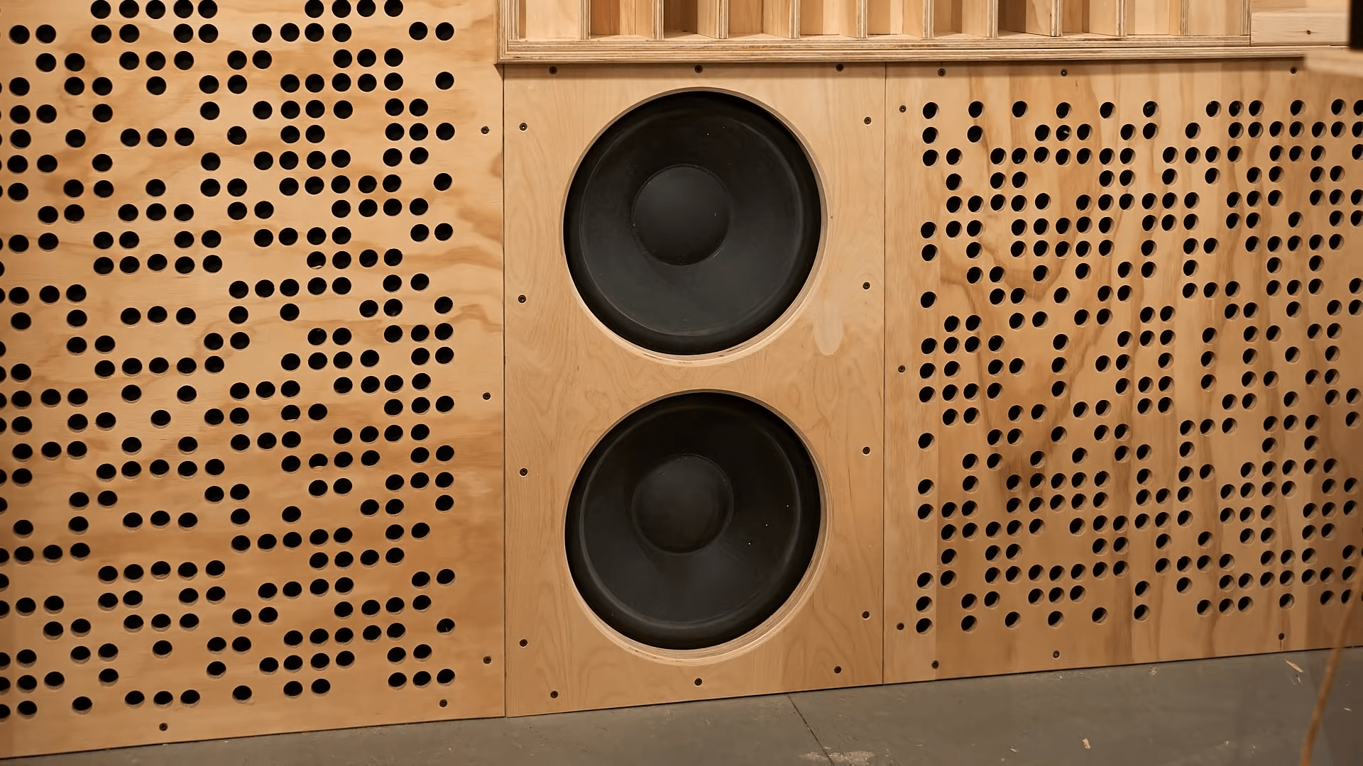

I love bang for the buck setups, even though I flirt with dropping bigger money on state of the art setups. The Peerless drivers that were in my vintage system were impressive, compared to other same era systems. If the enclosure size isn't a deal breaker, I could be pretty happy with a distributed setup with a couple of those for dirt cheap. The plywood would be drastically more expensive than the drivers!
Yep, the huge price increase was foreseeable 5 years ago and it was certainly worth stocking up at the time, provided you have storage space.The plywood would be drastically more expensive than the drivers!
Any pics of the cabs to share?Ere's the lates test of a two way using AE TD15S in 170ltr 30hz box with JBL 2431 on 90 horn crossed at around 900hz. This is measured at the listening position 9 feet away. A 4430 type of speaker.
Even better would be a vented infinite baffle, where a retaining wall can be made of OSB and/or underlayment. 4 woofers with the horns protruding between them, possibly in 2.5 configuration.

What did you aim for, concerning system F... and how much linear headroom did you aim for?Not so much dislike as I just don't see any advantages. With multiple subs, headroom is seldom an issue unless very low power subs are used, so excursion limiting isn't a big advantage. Closed boxes can operate below Fs, ported can't. and closed boxes are so easy to design and assemble. What's not to like?

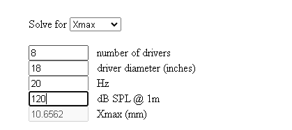

115db at 1meter isn't a small chore, 120db/1m is a feat. Multisub gets you there but lots of power isnt needed when enough subs are used, excursion is. With sealed subs 8, 18"s, just barely sneaks by with 14mm xmax ran down to 20hz.

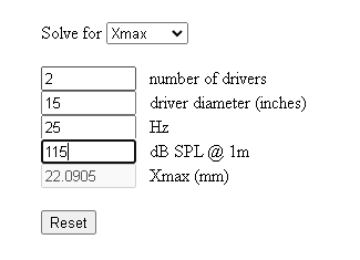

I don't get it?? Are you accounting for mutual coupling?? A pair of properly set-up 15's and some EQ will get you 115Db @ 25Hz with relative ease. Going to 20Hz flat as what a technical exercise?? Any content down there where it would be needed??15db at 1meter isn't a small chore, 120db/1m is a feat. Multisub gets you there but lots of power isnt needed when enough subs are used, excursion is. With sealed subs 8, 18"s, just barely sneaks by with 14mm xmax ran down to 20hz.

When I first started making choices I knew that I should able to reach 115db/1m down to 30hz, under Xmax, per side. Now, as I put the finishing touches on things, and after seeing that I was already close, after the movie experience, I'm like ok, I have to use multi subs any way, lets see if I skinny into 120db down to 20hz. Just to be on par with the Imax theater.I don't get it?? Are you accounting for mutual coupling?? A pair of properly set-up 15's and some EQ will get you 115Db @ 25Hz with relative ease. Going to 20Hz flat as what a technical exercise?? Any content down there where it would be needed??

This is likely the territory that I didn't like (10mm and above) but it would only exist at the lowest note....Excursion is considerably lower at 30hz, 4.7mm. I don't know about sealed 15's hitting 115db/1m@25hz... you call 22mm "with ease"?...I call it, with distortion and far out enough to loose BL considerably.

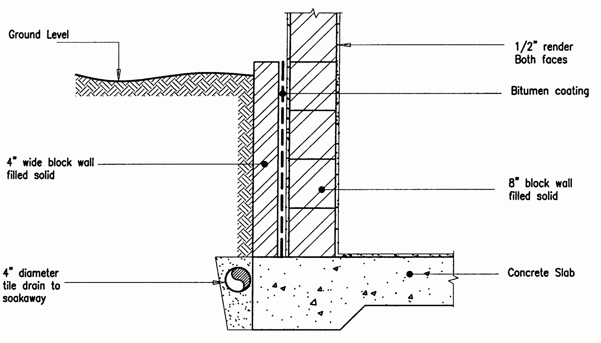

Unfortunately, OSB and underlayment prices have nearly tripled from a few years ago.
Are you sure you sure you really mean a retaining wall? Sorry to be picky but I’m an architect 😀
