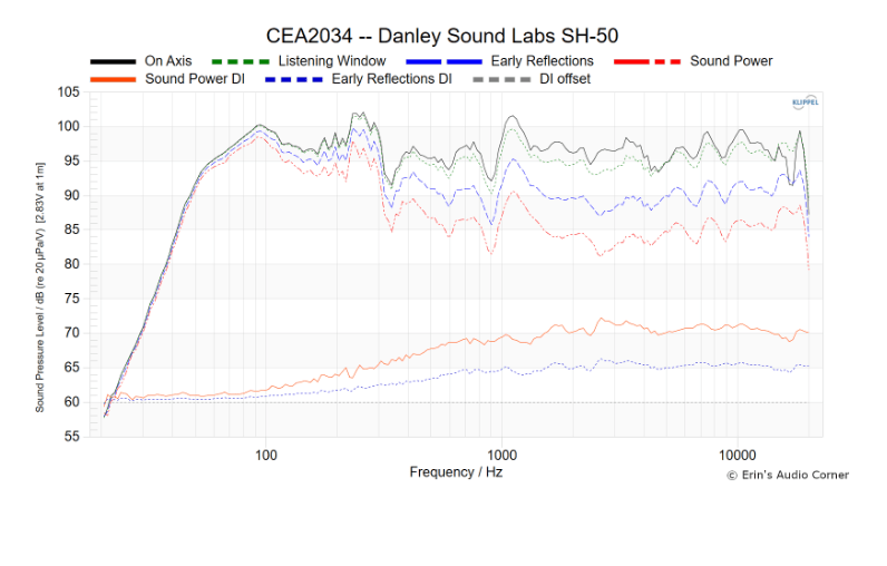

Are they achieving +/-2.5 db on these types of builds? Should we expect even better than that from a Mastering Monitor?
I know we've talked about this long ago and likely throughout, but I ask, where do we set the bar for expectations of Anechoic FR for a mastering monitor? I'd say about 2.5db to 2db margin of error but I am just guessing with some education.
You can use FIR filter and make system response to +/-0.5db easily, exactly target response, to any particular axis. But, all depends on the physical construct how good it is acoustically. Edge diffraction for example can easily make 2.5db swings to frequency response, resonances, room, all sorts of acoustic things that can make the response vary to other axi which might reflect to listening position if room is involved. If you manage to build constant directivity system, and have it problem free, use FIR straighten it out, you've got target frequency response at main listening position!
I think your margin or error is quite reasonable, and a worthwhile goal....at least on-axis or whatever near center axis in chosen to be the reference axis.
All the synegies I've built don't measure as well directly on-axis as they do 10 or so degrees off-axis.
By measure well, I mean when tuned to a particular reference axis, the measurements away from the refence axis stay within an acceptable margin of error.
Typically, and a bit unknown to me why, 0 deg H&V often ends with the most variation of any measurement within the "listening window". And it's worse the more symmetric the horns H&V patterns are.

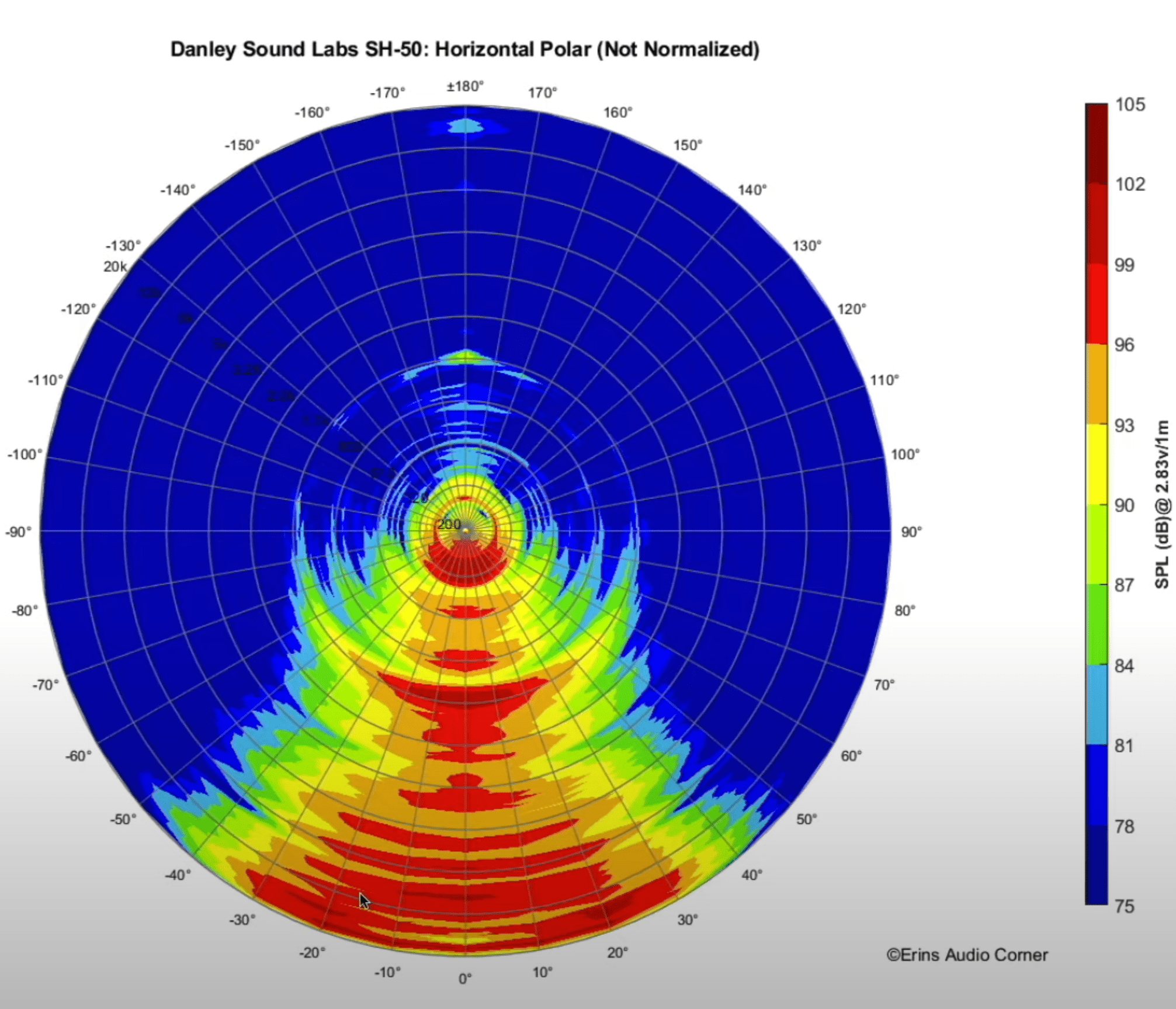

I think directly on-axis issue might have something to do with Erin's measurements of the SH-50, which look much more ragged than I would have expected. I know he talks about the quandary he faced on how to measure it, and discussions with Tom. I certainly trust his work, but am left wondering how well the NFS system fits a narrow horn system...or for that matter a dipole or a line array etc . Simply dunno.
With regards to "listening window", it's all i bother with trying to smooth polars anymore. And I do it mainly because I walk around a lot, listen from other rooms, indoors and out, yada yada. And it makes sense to try to widen the area of sonic purity (from a single axis).
Plus, optimizing to a window, instead of a spot, is a way of assuring FIR corrections aren't too heavy handed.
Oh Ron, I think you're spot on about the SH-50's consistency between the Listening widow and on ax. Should make for easy FIR correction (which Tom has said he did once for his home SH-50s)
Not that it matters to the discussion, but the reason I don't even bother with polars outside the "listening window" (which for me ends at +/- 30 degrees),

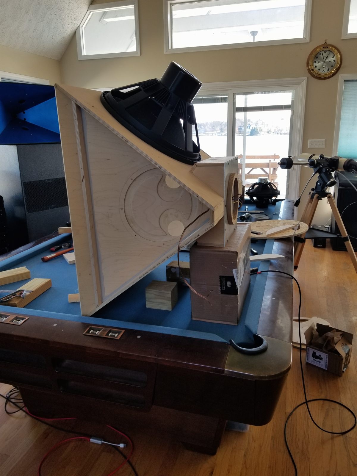

Hey folks, double 18" synergy in progress....
Repurposing syn9 v2's 75x60 horn. It's cool because it already has sealed chambers for both 12"s and 4"s. So all I have to do is fit the 18"s and build a big **** box around it all. I think I have just enough wood left....i hear baltic birch is simply unattainable in the states now....
Reactions: 8 users
