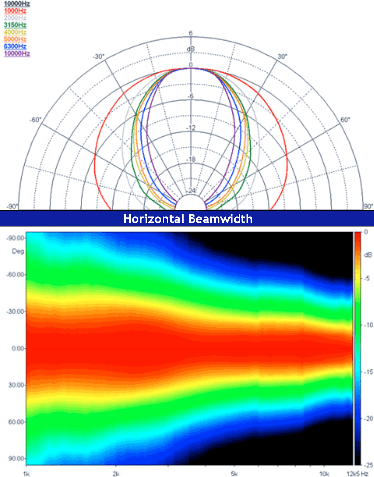

I think my polar should resemble this but from a much bigger horn so the directivity would extend deeper, the polar might be more narrow through the treble and upper mid? and the larger exit vs this 1.4" would cause a more narrow upper frequency polar, or at least it would start beaming sooner.
Yep, thx fluid.... i know all that, not sure why i said i don't...
Me neither :)

CEA-2034 has gained lots of popularity recently because of Klippel NFS of Amir and Erin. It is a good way to summarize spl responses at various angles. But a designer or a deeply informed reader (like we here at diyaudio) want to know more - raw measurements and spinoramas. What is happening more than 30deg off-axis, even on the backside give important information of how a speaker behaves in a room.
Waveguides, horns and coaxial drivers practically always look bad on-axis, but typically 10deg off represents Listening Window of CEA well. Vertical interferences of stacked multiway speakers have wide variance (depending on C-C distance and xo freq and type) and can be the source of bad sound - it doesn't show up in CEA directly.
