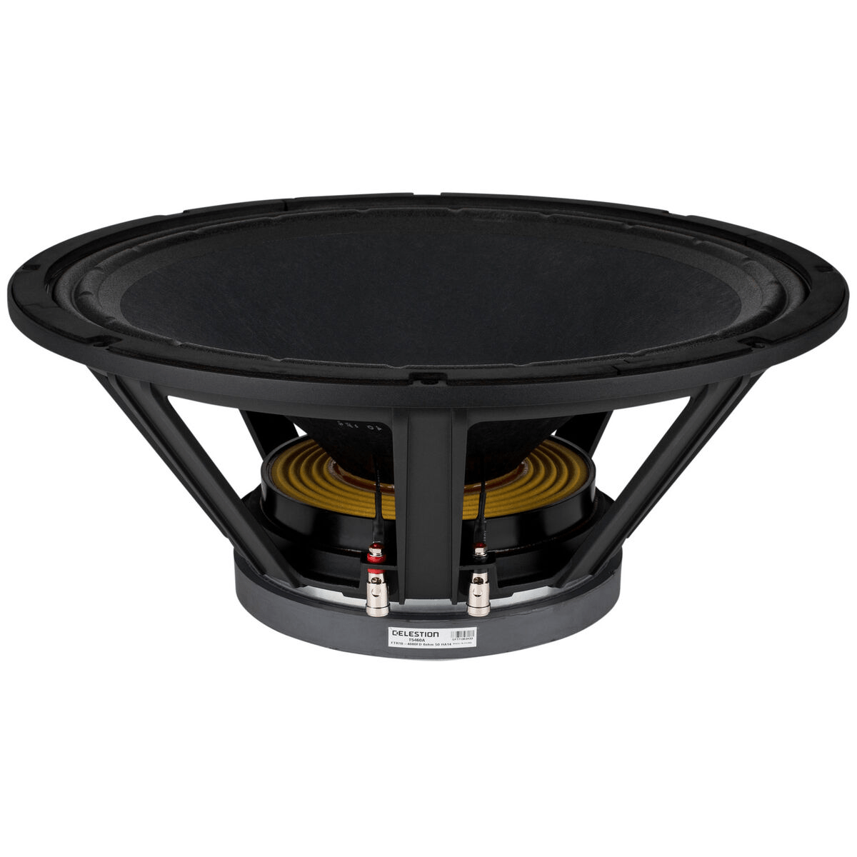

2 15"s in a 500l BR with a 500cm2 port tuned to 20hz, in 4 sets, can do 120db/1m down to 20hz within 5.3mmXmax....With the filter knee able to be placed so low, why do you not like ported subs again? Multisub running up until about 100hz? This will allow the front woofers to play midrange with ease. Sounds like a win, except I'd be using dual 18's in the rear on each side.I'd go with multiple closed boxes no matter what the room configuration. Independent LF DSP assumed.
The current mains set up, is pretty good. With another set of subs in the back, 120db/1m is reachable. Because of the spare woofers I chose, I would have to make them BR to reach the levels needed to combine with the fronts and hit 120hz. 4 more 18"s would work sealed but I'd need 14mm xmax at least.
