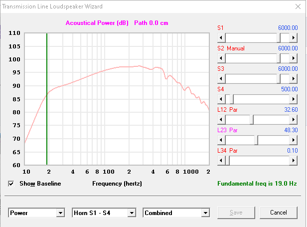

If I sim the similar 500l BR in TL mode to add a little Filling I get this
Gd is around 33ms in this sim at 20hz and 8ms at 30hz in this sim without filling.
OK now that we can see that it is looking in the ball park...Something like this could be used in a TMM with a xo of 350hz to a large horn, using the 18h+.
What do you guys think?

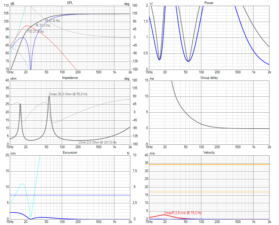

What if I put the 2 - 18h+ in a large Tapered TL or BR, say about 500liters, tuned to 20hz, GD delay reaches 28ms at 20hz...whats that sound like?
Given that 20 Hz is largely felt rather than heard - below 20 Hz the average human being is unable to distinguish pitch, I don't think GD doesn't matter much unless it's very high.

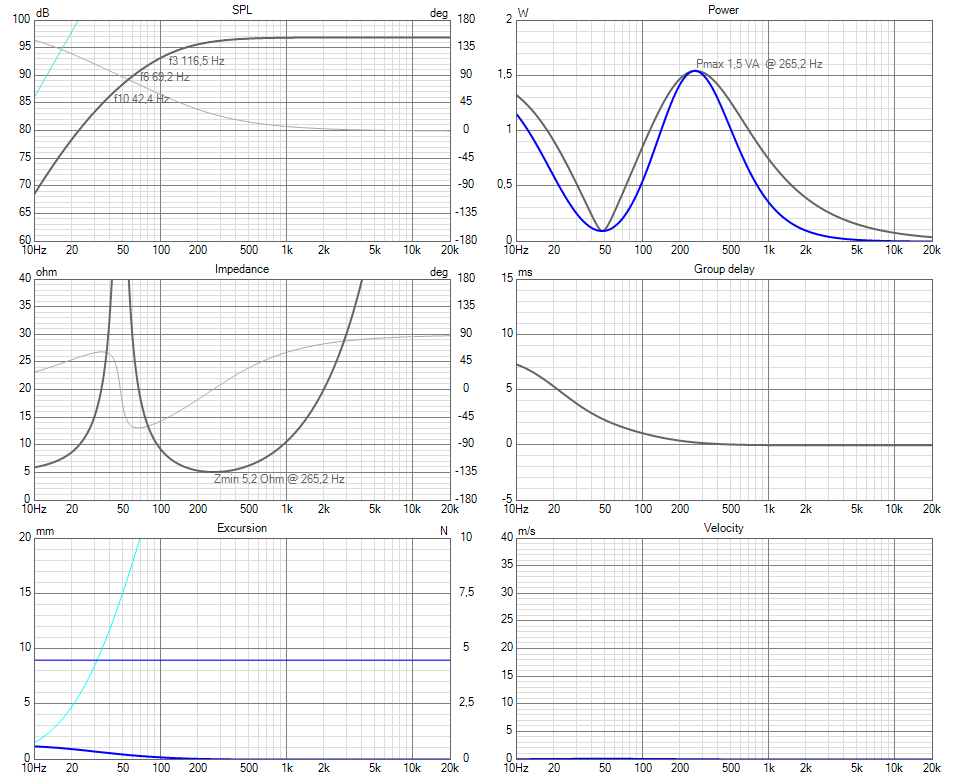

If you compare some of the sims I posted before (2x12" in BR cabs) to this (B&C 15TBX100 in 180l closed) you'll see that GD is only marginally lower at infrasonic frequencies. At the same time, the output at these frequencies is substantially higher for the BR. Simply put, the B&C/sealed actually hardly delivers any meaningful output below 40 Hz. 'Sealed freaks' will argue that the GD is lower above 40 Hz, which is of course true. But as I have stated before, imho, the difference doesn't outweigh the disadvantages.
Very good, close to GD of sealed cabs.View attachment 1108861

The point of diminishing returns seemed to be based around headroom, so that does leave options. But if I want to achieve 123db down to 20hz, with what I got, I'd need more drivers or to try a vented enclosure.
Largely true, but there might be some unique individuals who could hear the pitch at VLF.
