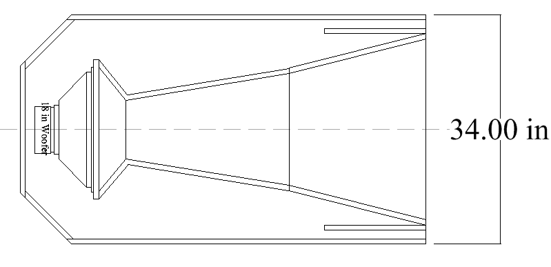

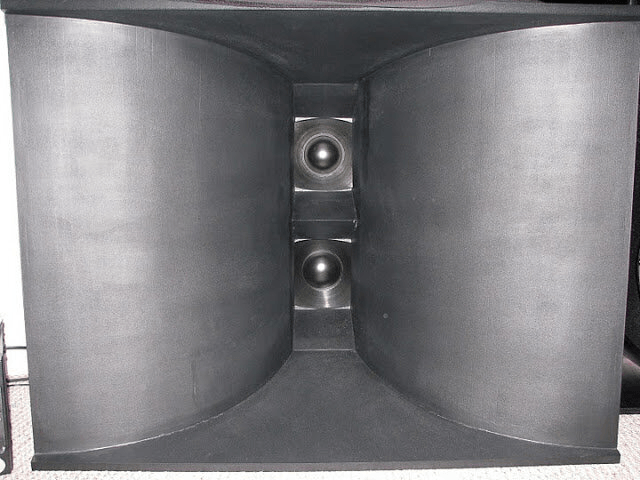

Camplo, what you want is something similar to this:
More precisely, the big ones:
In this case we are not talking about a traditional FLH, but something in between an FLH and a (woofer) waveguide.
The manufacturer calls it a 'waveformer'. Those systems are vented, which would be my personal preference.
The XO of both systems is higher (>500 Hz) than what you've in mind.
2x TD18H 16 Ohms in parallel should be enough to achieve your objectives.
C-C distance, lobing, cancellation etc. are hardly an issue below 400 Hz.
Personally, I'd go for a variant based on JWC's Tractrix mid bass horns to suit your big mid/high monsters and are also easier to build.

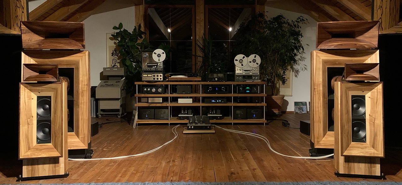

This system was by far the best system of the show according to me (and many others). Not perfect, but the only system that sounded really lifelike.

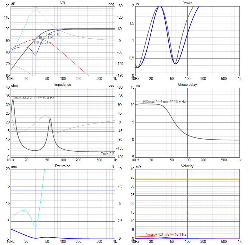

Another option is a variant of the Inlow Sound 40 Hz horn with bass reflex.
2x 15" in separate vented horn cabs of sufficient length should reach <40 Hz.
I'd lower the compression ratio to improve midrange extension (even for camplo a sensitivity of >110 dB (x2) is overkill).
Like this, specified for 30 Hz with TAD TL-1601 and crossed @ 500 Hz:

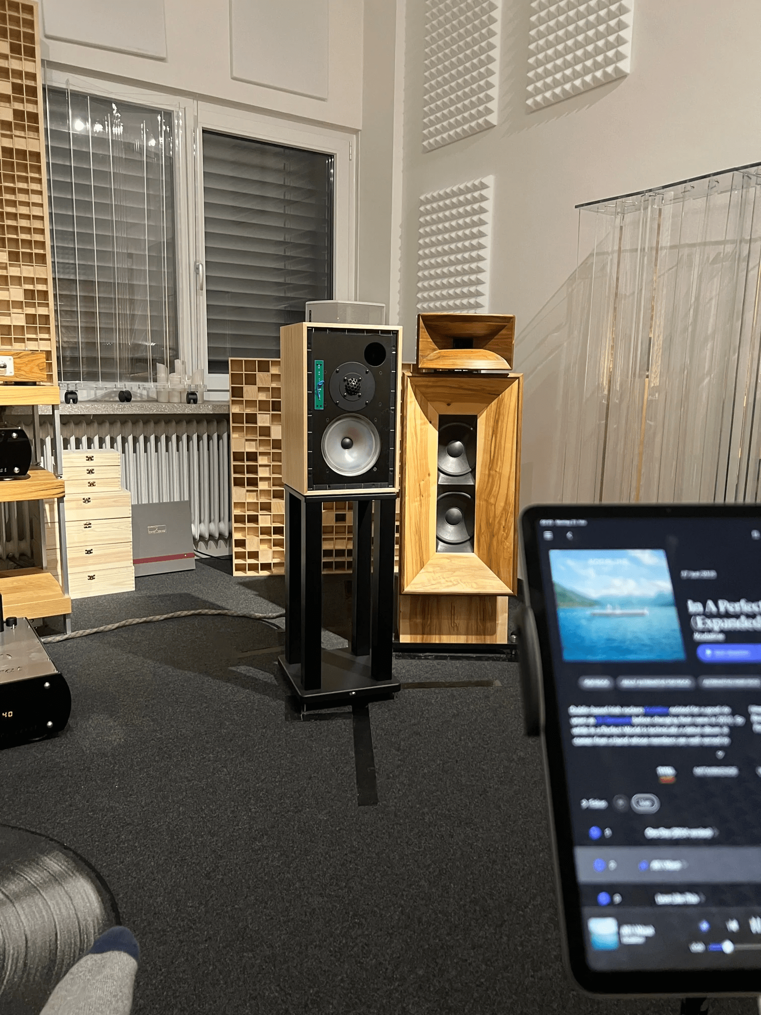

Coincidentally, I came across Joseph Crowe's visit to the German dealer/distributor Klangloft and Munich High-End.
And what catches my eye?
Joseph makes no mention of the Blumenhofers, but - to my surprise, he's positive about the Steinway Model A:
Steinway Room (Model A Speaker System, including amp & processor):
“Excellent soundstage depth. Medium soundstage width. Very good low level detail retrieval. Detailed highs like a ribbon (actually AMT). Bass is great. Sealed and against back wall.
70k Euro system MSRP. Uses what looks like 5” SB woofer and AMT. “
Perhaps the conditions were better in Munich, but my impression of this system was completely the opposite. Dominating, woolly, chunky, undefined lows with a rather unnatural sounding mid/high section. Piano sounded like a cheap keyboard.

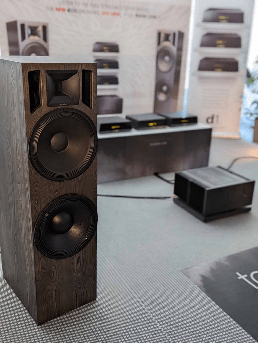

Total DAC Speaker:
“Sounds better than Cessaro despite having a B&C ME20 “style” of horn. Uses a 12” mid-woofer and 12” lower woofer. Extreme clarity across entire frequency bandwidth. Compression driver sounds as good as any I’ve heard.”
This is a 2.5-way system where the upper 12" woofer is crossed at 3500 Hz to a Beyma TD-8060 + (presumably) a CD1Fe. The speakers are sold for €14,000.

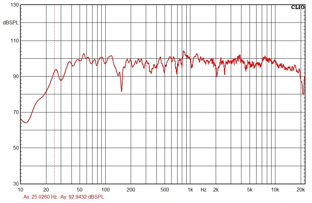

In-room response:
