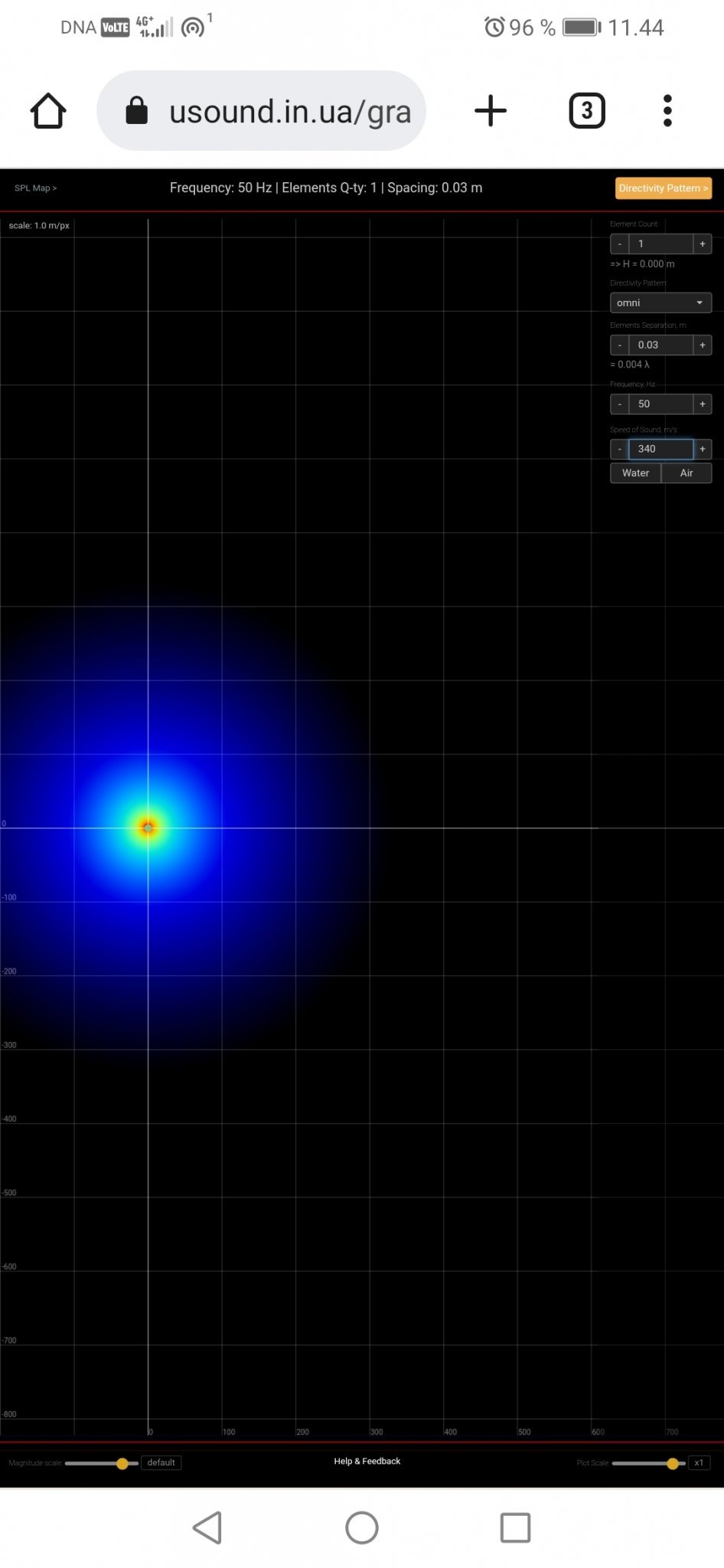

Simulation of Linear Array of Point Sources
https://www.usound.in.ua/graphs/

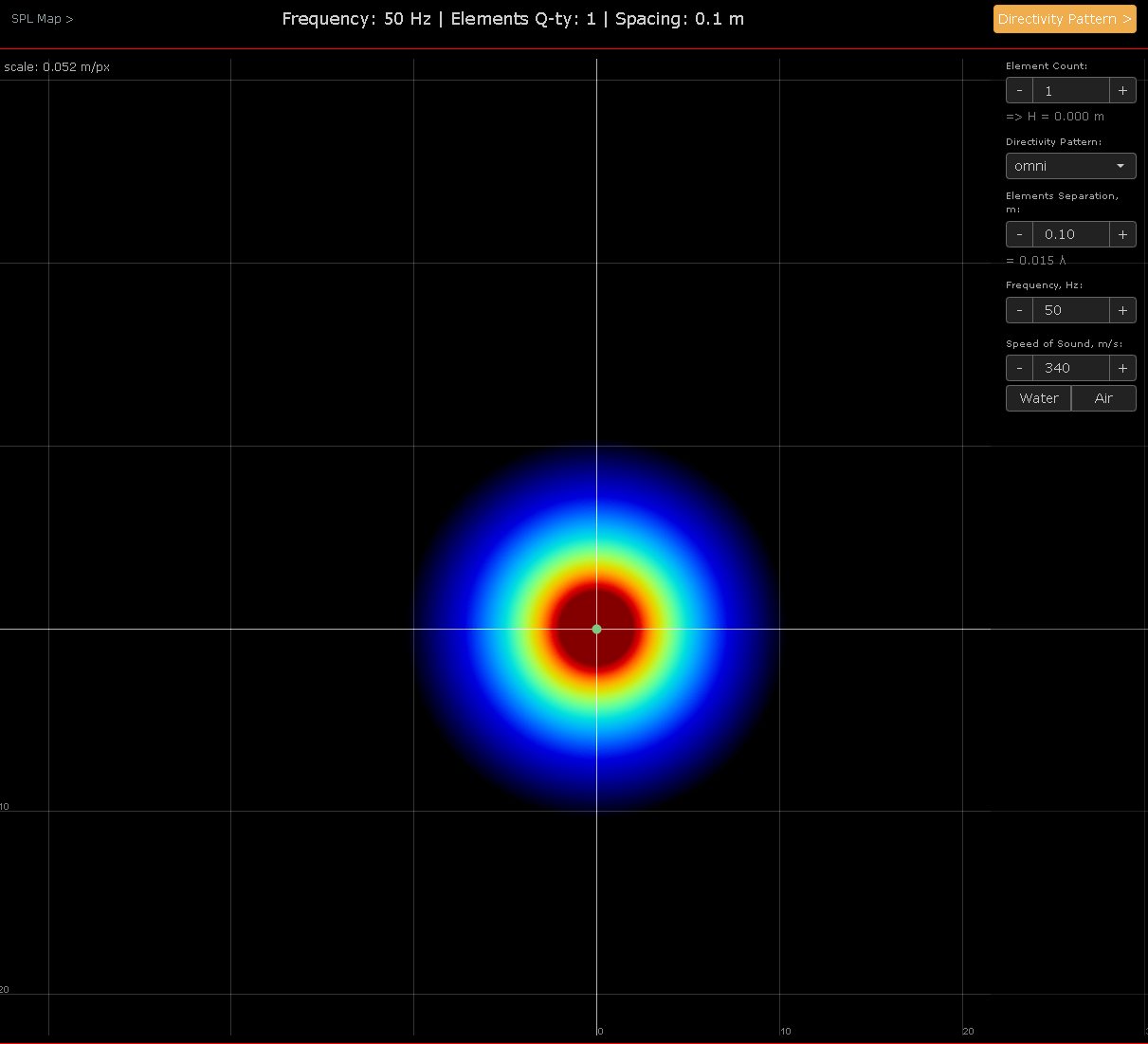

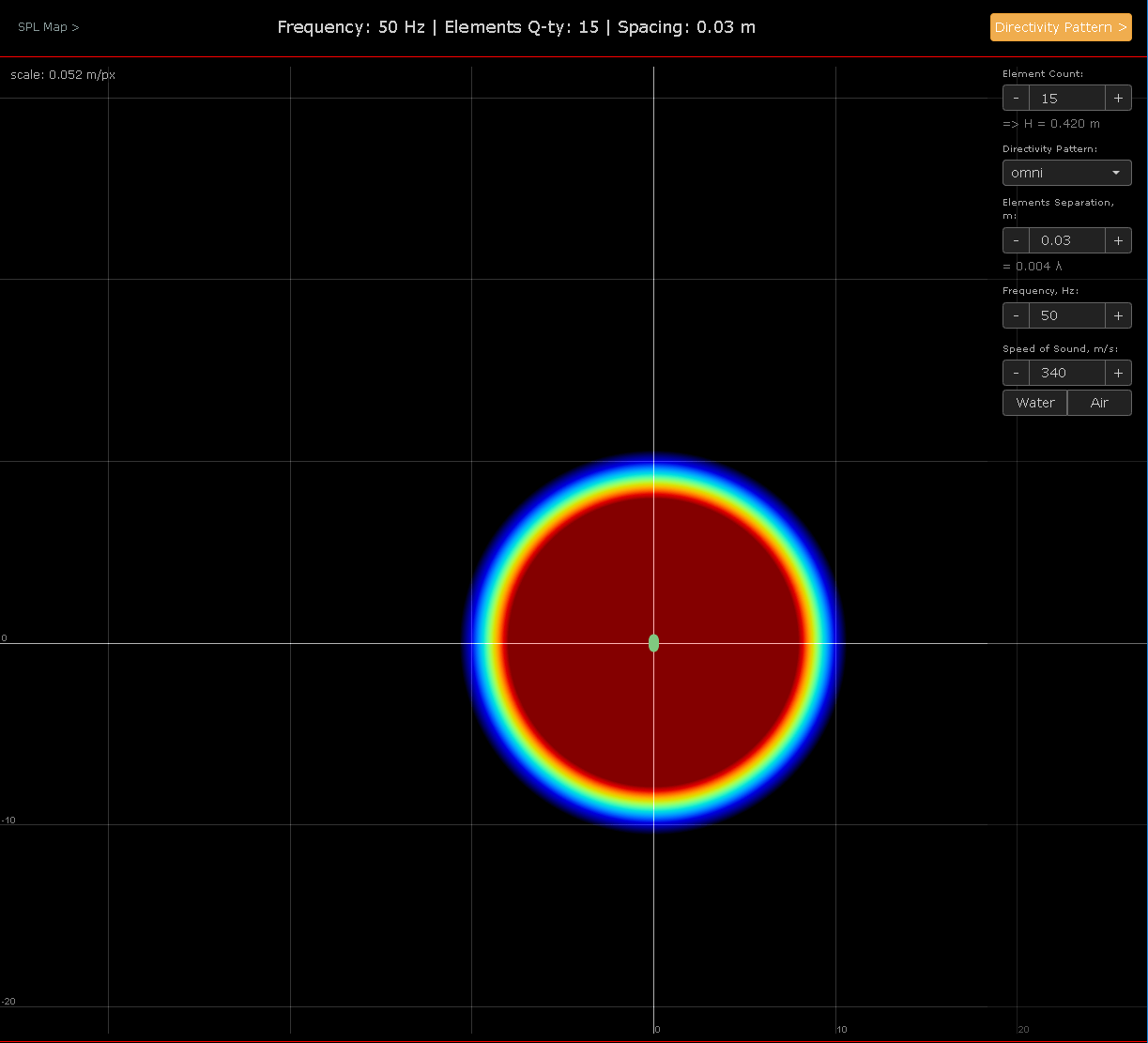

I made one sim with 1 point, and another sim with 15 points spread at 1"
The graph changes dramatically... I thought colors were supposed to be spl but if the Radiation mass is close enough related maybe they plot similar? I think this is volume matched, the outer shell is about at the same line.
If this could be looked at as a representation of volume matched, high and low sd....The reflective character is going to be quite different. I have no way to connect this to a real life situation as far as how much input the sources are running at.....I mean is this 1000w or 1w....Amplitude had to be lowered to the larger radiation source to match spl at the border line.....but no idea the radiation size to expect vs watts, so its kinda generalized and hard to relate to a real life situation.

I see no one can or has explained why when I increased point sources in the sim the polar changes in a way that looks very similar to how I suggested that direct energy increases... the larger red area suggest an area in the sound field that remains closer to the velocity of the point source "surface".... Do tell 🤔🤔🤔

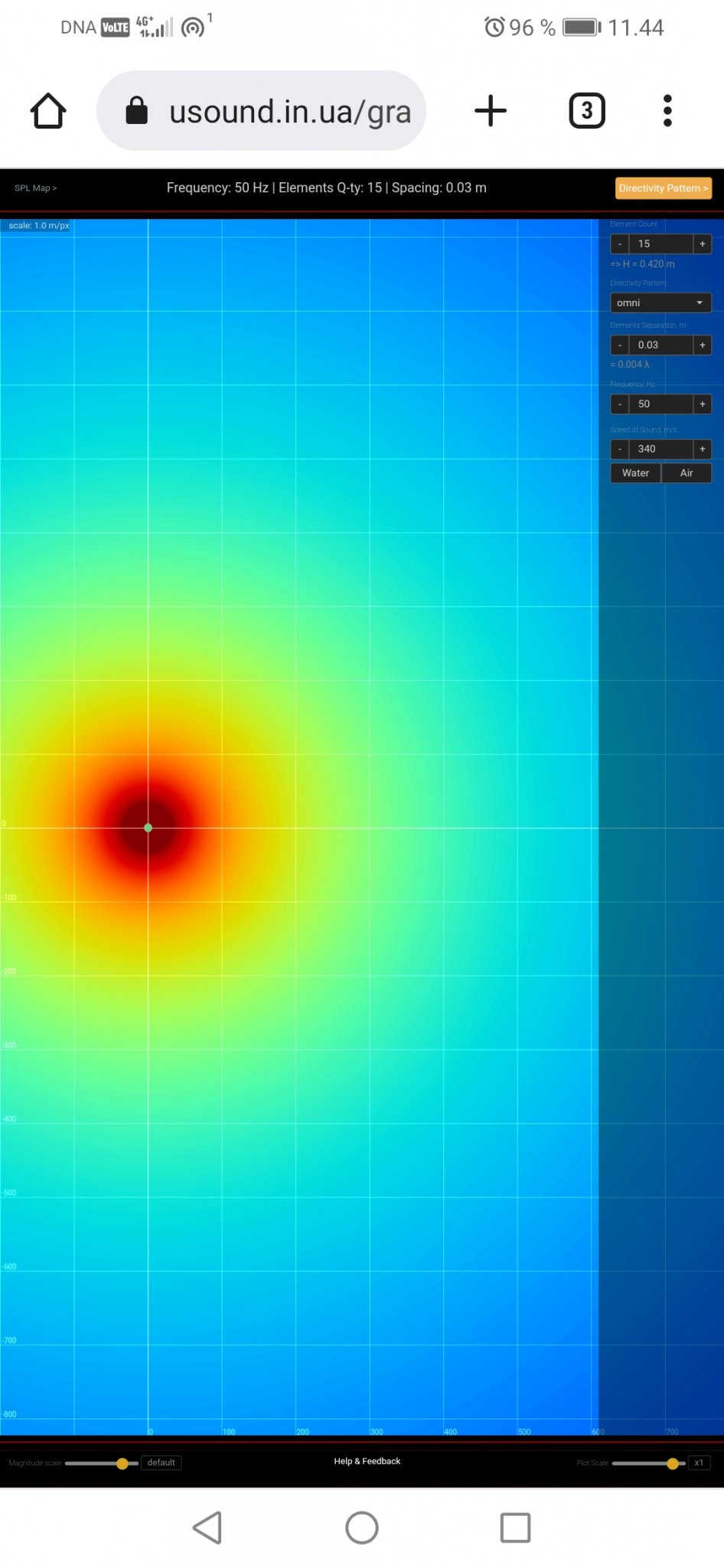

I cant replicate your results, did you manipulate the sliders on the bottom? they are not visible in your screenshots.
If I try to do it it looks like attached, intensity increases as expected. Polar pattern is omni in both cases because size of the array is very small compared to wavelength, with your screenshots and mine. This means sound towards boundaries is same as towards listener, in other words relation of direct and indirect sound stays the same. Things just get louder as you increase Sd, more sources in the example, until size of the array gets closer to wavelength. 50Hz is almost 7meters, ~21' and if you increase spacing of the 15 sources you start to get dipole/bipole response, increased directivity index, which is less power into room compared to direct sound. You must increase directivity to reduce sound in room in relation to direct sound.
