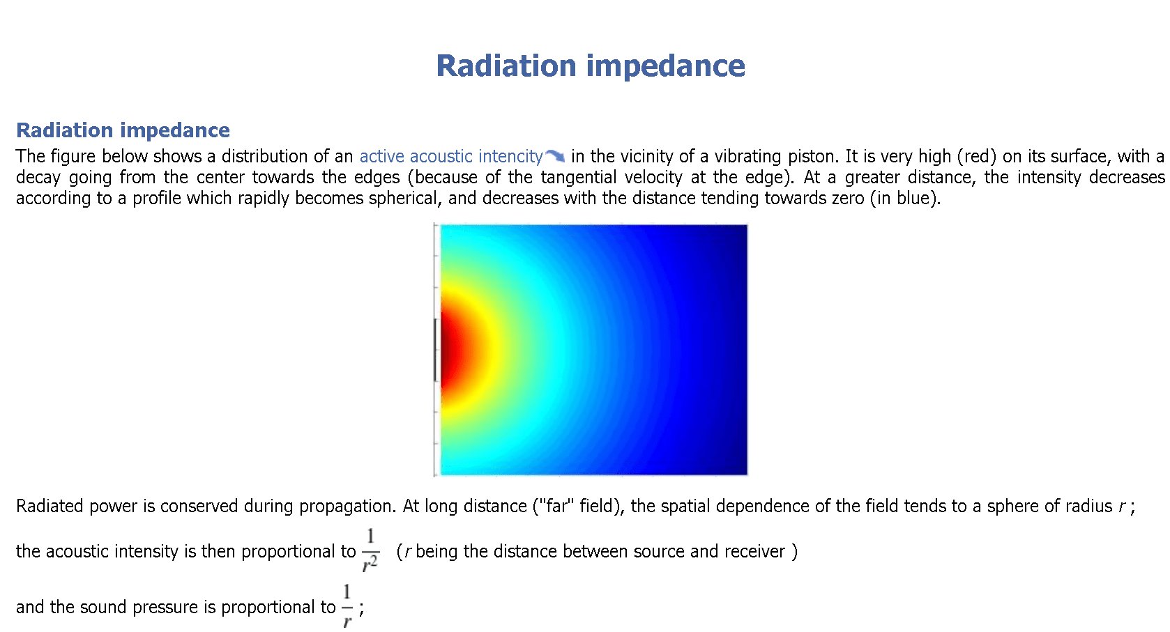

Increasing Radiation area increases the volume (3d proportions) of pressurized air the driver creates...unlike increasing excursion, increasing Radiation area, increases the volume (not level) of Direct Sound emitted from the Radiator. Think volume (3d proportions) not velocity. Velocity does not create more direct energy persay but it probably can extend the radiation mass forward, I dont know for sure
If we can simulate the radiation mass/impedance of a small and larger driver, volume matched, they will not be identical. It will tell the same story I describe, or maybe different.
@fluid would you be bothered to sim a 4" and 18" to demonstrate the volume matched impedance/radiation mass? At I dunno...50hz?

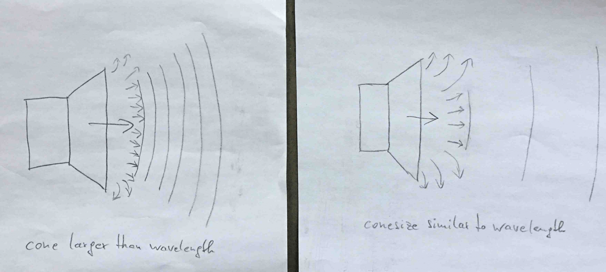

Such long wavelengths require big room. Geddes says it very clearly in the quote, difference in sound is in the room size.
I'm by means no expert on this, just googling around, but thinking the definition of diffuse sound field as simple terms it understand it so that in diffuse sound field sound is smooth accross an area, you can move freely in diffuse sound field and the sound is the same. However, when wavelength is long, like size of the room, the diffuse sound just does not happen as there are modes, standing waves, peaks and dips in response. Sound changes as you move in the room, its not diffuse. I think this is the difference.
So, the radiator size just doesn't matter at all when wavelength is very long, closing in size of the room, because its the room that prevents diffuse sound for the long wavelengths. All you can do with small room is to mimic diffuse sound field as well as you can, with multisub setup, reduce peaks and valleys to make sound smoother through out the room.
See attachedHowever, when wavelength is long, like size of the room, the diffuse sound just does not happen as there are modes, standing waves, peaks and dips in response. Sound changes as you move in the room, its not diffuse. I think this is the difference.

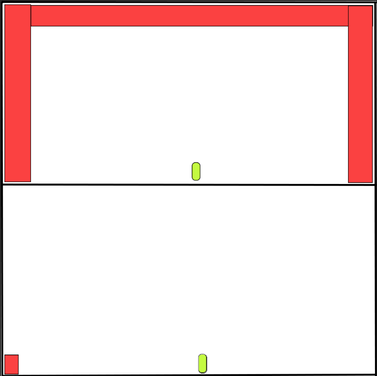

One of the easiest ways to express a trend is to exaggerate the cause
Lets say that all the Red space is Radiator area. The green guy is the listener....The system is playing 50hz, omnidirectional to both systems....If you think that the lower room will have the same Direct sound vs Indirect sound compared to the upper...I'd say that you might misunderstand what direct sound is.....A diffuse response is balanced between room (indirect) and source (direct) input.....A small room is normally Dominated by Modes in the LF......Modes of indirect sound. If I increase Direct sound....I am one step closer to evening out Direct vs Indirect sound. SPL is a sum of Direct +Indirect......That is all.
I rather move on to proving right or wrong....How does one measure Direct Sound vs Indirect, So I can prove this to be true and move on

Yeah you are right, its just not possible to increase direct sound in LF without also increasing the indirect sound (reflections) because the sound radiates allover from any transducer that fits inside the room. You'd need to absorb the "indirect sound" in a small room. When wavelength is room size, or bigger, you cannot fit in a structure that would restrict sound to walls, at the long wavelengths.@tmuikku
" After many "paper" studies of the situation (including a PhD thesis) I arrived at the best "approximate" solution and that is multiple subs. This yields much more diffuse LF signal along with a much more uniform response."
He was not talking about large rooms yielding a "much more diffuse" LF signal in this sentence. All I took it as, is that with multi sub it will be more Diffuse like...not actual Diffuse....The only thing more diffuse like is the increase in Direct Sound
For short wavelengths this works fine thoigh, because we can increase directivity, we can focus more sound towards the listener direction and reduce towards boundaries. Horns, waveguides, arrays, but only so big fit into a room. Its all about wavelength.
Yeah you are right, its just its not possible to increase direct sound in LF witgout also increasing the indirect sound (reflections) because the sound radiates allover from any transducer that fits inside the room. You'd need to absorb the "indirect sound" in a small room. When wavelength is room size, or bigger, you cannot fit in a structure that would restrict sound to walls, at the long wavelengths.
You are just missing the bigger picture. If one were to cause LF to beam it will lower indirect sound portion and raise direct sound portions to the listener standing in the Beam.....A room that is Diffuse at LF has certain characteristics to it.....IF you can bring Some of the characteristics to your small room, your room will sound more Diffuse...that doesn't make it actually Diffuse at LF. A small room+system to listener might be 9parts indirect sound and 1part direct sound.....If directivity were to change that to 5 parts indirect sound and 5 parts Direct sound....it is a more Diffuse like responseWell, even if I missed the main message on the paper I'm quite certain after reading it that the diffuse and modal stuff is about room acoustics, size, and transducer size doesnt matter
You think that at 50hz that the signal will be the same at listening point in these 2 rooms!? how?!?!? Impossible
This is the devils advocate to my "Big Point", and yet to be proven true..... My first thought was the whole Velocity thing, Remember we have to lower velocity to compensate SPL to that of the smaller radiation room.its just its not possible to increase direct sound in LF without also increasing the indirect sound (reflections) because the sound radiates allover

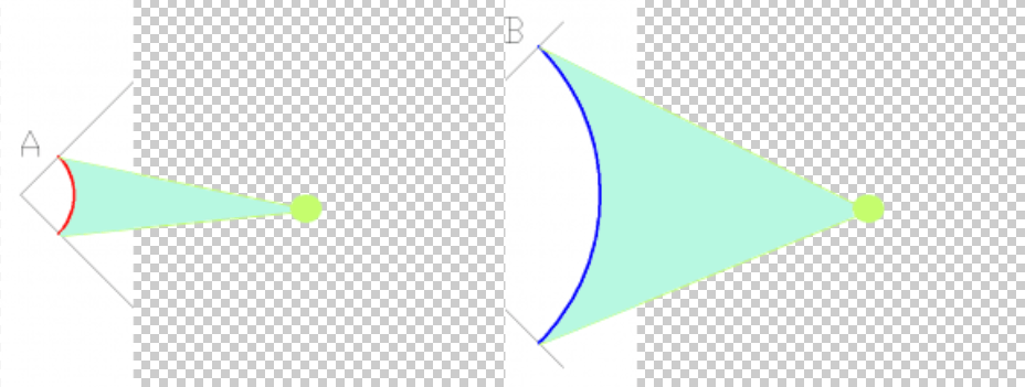

Well thats just it....Having, once again, direct sound coming from multi directions, is definitely going to increase Direct sound....There will be more intersects at the listening point that have not Reached a boundary yet. Mulitsub is essentially an increase in Sd ie, Radiation area.
The more paths you can draw to the listener, the more Direct Sound the listener is getting. Directivity allows one to draw less lines to the boundaries and potentially more to the listener....increasing Radiation size, increase the amount of lines you can draw straight to the listener.....
The part you added in is the idea that more lines will be drawn to the walls as well....So it gets complicated. I think what happens is, there is still a larger amount of Straight lines that reach the listener First before the reflections arrive, From the Larger Source, Than with a Small Source,
Do you get what I am trying to say now....So at this point I am reminded that we do not perceive LF until many cycles? So the Ear part is null....
What I am saying now is that the more Lines I can draw from the the Radiation source to the listener....The more I can feel the sound coming from that direction of the lines.
