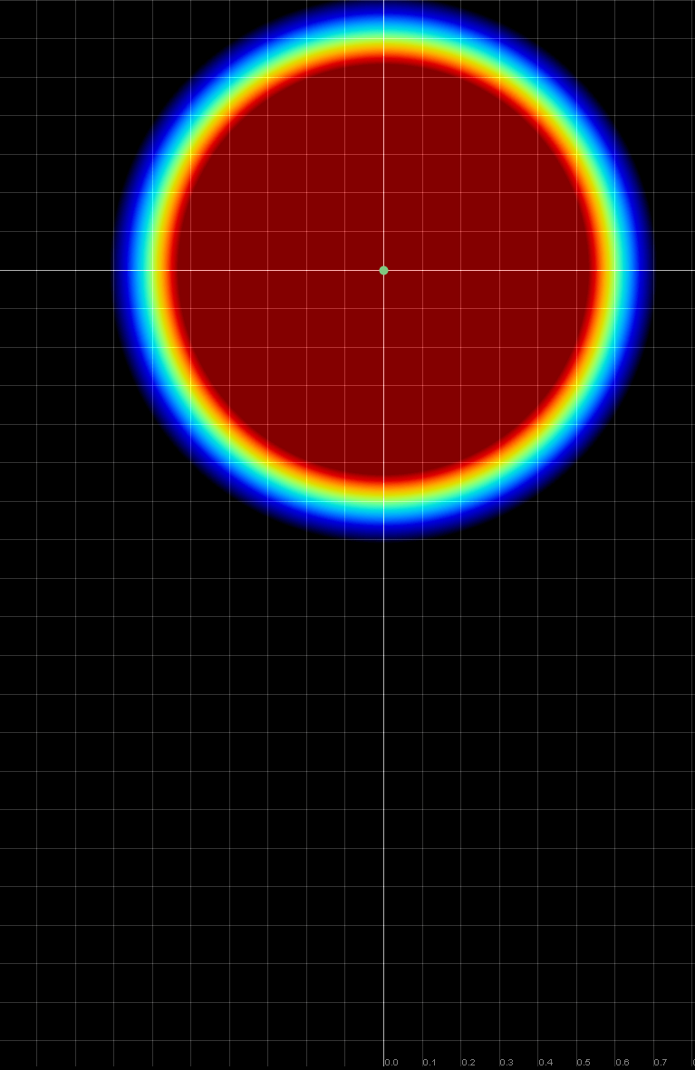

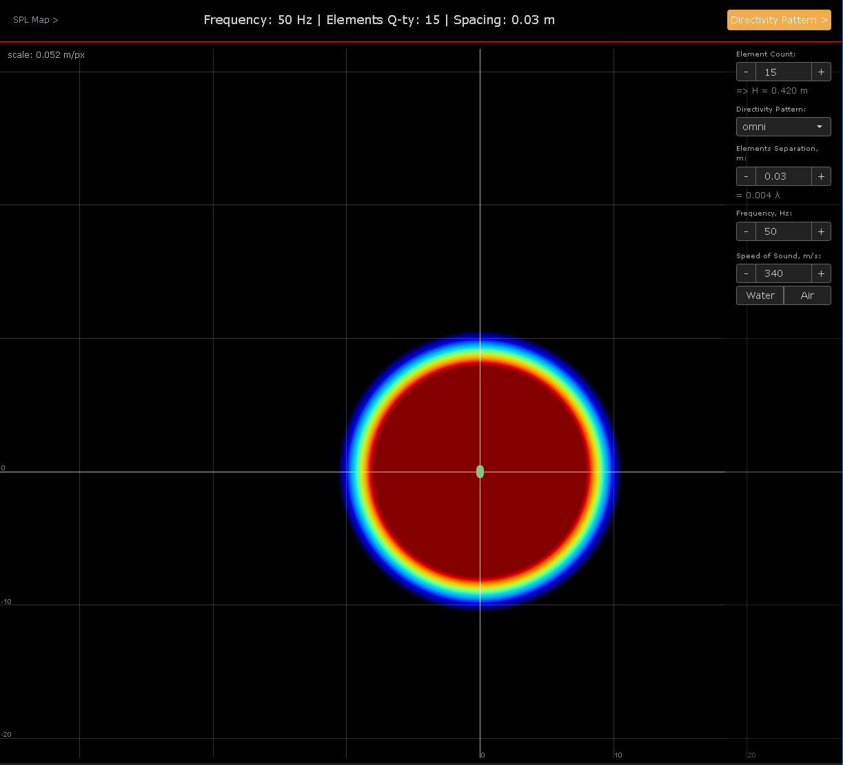

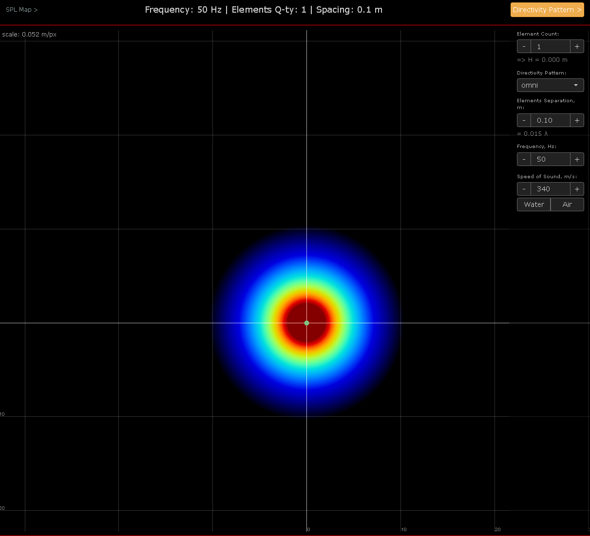

This is the sim I got from https://www.usound.in.ua/graphs/ by increasing point sources and creating the same sized radiation mass....This is not actually a radiation mass simulation but one for SPL, but the connection to spl and velocity is a close one, so this is the best simulator I have to help express ideas.
If you are speaking on radiation size, direct energy, vs LF and HF leaving out Directivity, then yes, I agree...With LF we have to consider cycle time...As I said before, I believe that we can sense the direction of pressure in some type of way....So the more Radiation from the source, the more we can sense the pressure coming from that direction....In a room mode, the pressure will seem to come from everywhereWhen talking about the perception of "direct energy" you absolutely have to consider the LF and HF perceptions
The discussion is all over the place, and I've been doing my best to keep these guys from jumping topics....No one expected me to produce the above sim, they thought this thought would just fade away.
Ok I found some more mistakes I made....I said that Radiation mass increased when increasing Radiation Area, which is true but that leaves out volume matching. Radiation Mass size should be identical if volume matched. For example the outer edge is the same spl in the below sim. Increasing Radiation Area increases the area in the sound field that has the same Velocity as the surface of the radiation source...I haven't figured out how to show how this plays out in the real world just yet. The Red in are in these sims may so small in comparison to the baffle that difference between a 4" and 15" are unnoticeable. In regards to LF in a small room, cycle time would null out any advantage of receiving more direct energy according to @gedlee....I went on from there to say many things but the one thing that seems to worthy of holding on to out ability to sense to the direction of the pressure. This ties into another statement I made saying that as you increase Radiation area, in a room, the room becomes less of the final SPL. Hoping Earl would speak on that.

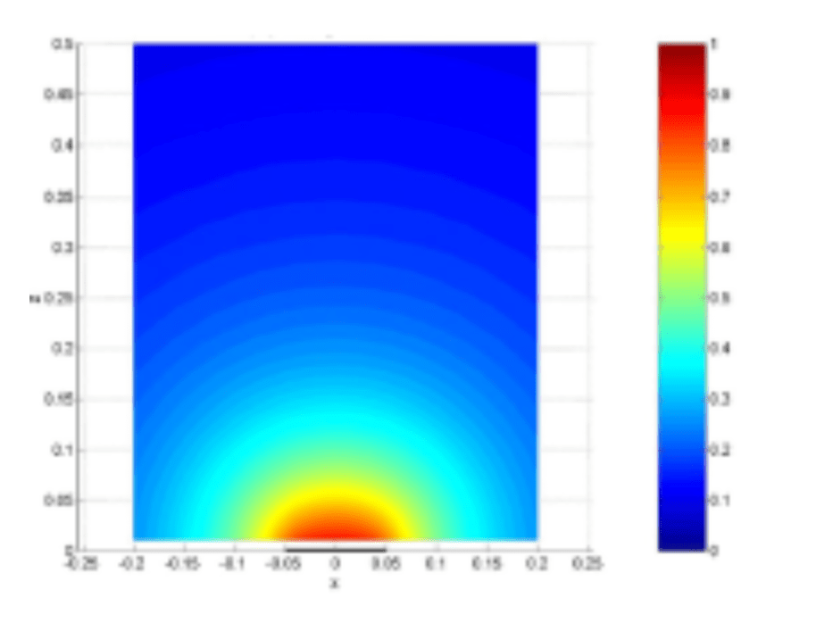

If I can trust certain aspects of this sim then this could be basically a 1m measurement of a sound source small sd and one with high sd.....Obviously velocity is remaining in sync with the diaphragm, for a much larger part of the sound field. I also stated that increasing Sd the point of the critical zone further away from the source. These sims would seem to support that as well. Theres way for connect increasing point sources in this sim to sd other than assuming that everytime I add a point source I am adding X amount SD where X= the sd of the point source....Looking at the sim I cannot shrink the radiation mass below 1m, so 10m = 1m for this matter. A 15" has about 15x more Sd than a 4" so this simulation is in the ball park. The reflective nature of things within the 1m are going vary in velocity much more than whats happening with the smaller woofer. I probably need to research more about Volume Velocity.

If it's omni, then the only thing that matters is Volume Velocity (VV) - i.e area * velocity. Smaller area needs more velocity, but if VV is equal then area doesn't matter. I explained this before.@gedlee

Both source at 50 Hz will be identical. If they are also both linear, which is difficult for the 4", then they will be identical at all volume levels. For equal output levels, the 4" will have much greater excursion, that's all.
