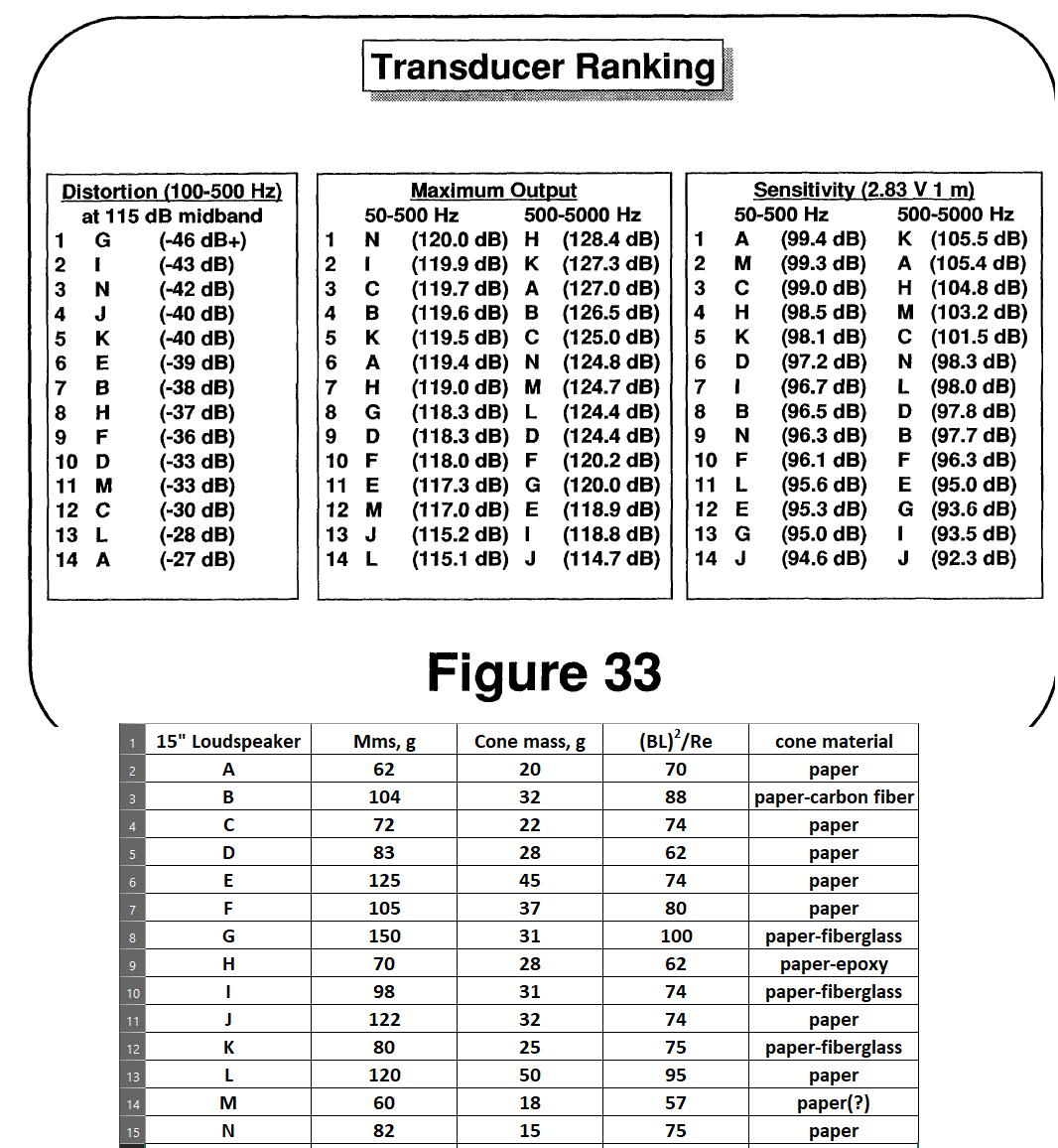

When I first looked at the graph below I was mad that there was no connection to alphabetic order and other aspect of mass or motor listed by the character
My interpretation; At face value these charts serve to say that there is no obvious connection to mass/motor and superior performance of "distortion" (what ever one they are referring to) sensitivity and max spl.
Look at A lowest mass lower performance distortion wise highest sensitivity. That's a hint look at higher mass like G and look at the ratings.
You really need to look at the entire paper. The conclusion is opposing requirements that need to be juggled by the designer for the desired overall response.

The driver models are not indicated, but from the description of the drivers it can be understood that G and I are JBL (G is with Aquaplast coating), the J driver is TAD 1601 (the only driver with Alnico magnets), the N driver is with a neodymium magnet and a heatsink (I think at that time, very few such drivers were produced, and if you look for 15 "drivers of those years with Nd magnets, you can determine the manufacturer.) The description indicates that some of the drivers are guitar.
P.S.
Probably N is also JBL

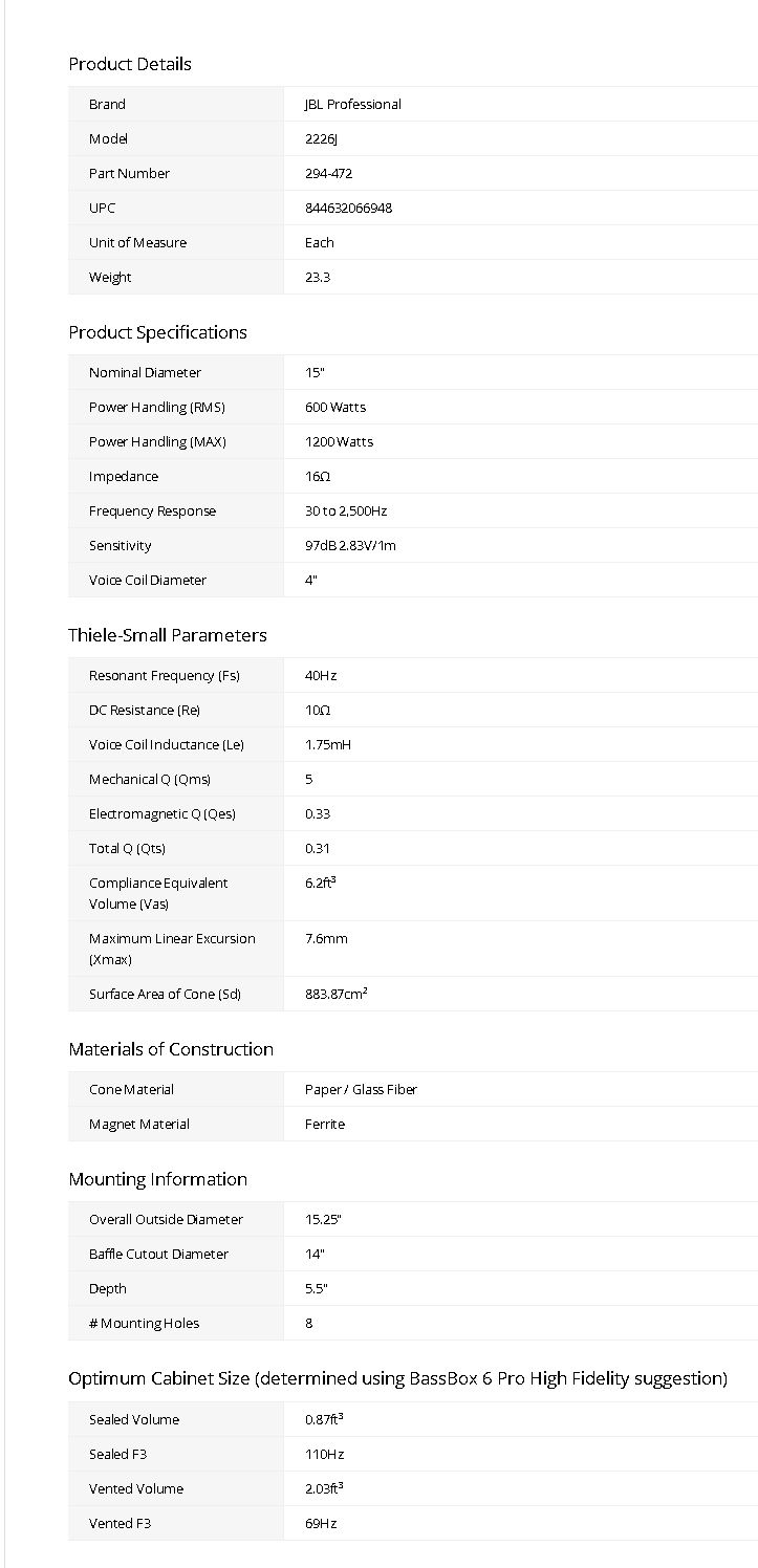

In a lot of woofers I see, with an 8ohm and 16ohm design, the 16ohm design has half the Qts/Qes of the 8ohm version......whats the connection?
Measuring Loudspeaker Driver Parameters
The calculations for those parameters depend on Re

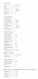

yes but what about the times where a manufacturer has the same driver and both 8ohm vs 16ohm models are listed as matching Q specs....how is this achieved?
Yeah I believe that, I'm looking at the spec sheet for the 2226J vs 2226H and it only list one set of Q specs.

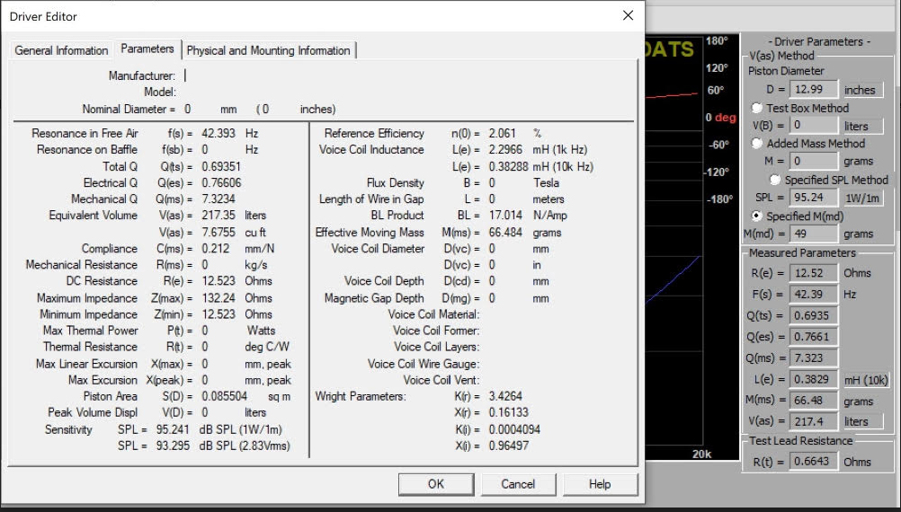

If I remember correctly....Q can be adjusted via slope of the roll off via EQ? If this is true.... then the only disadvantage I am left with regarding the AETD15m I have with Q=6 and Tm=17 Re=12.5 is the loss of sensitivity from the weak motor force.
Is this something I can have the manufacturer "fix"?
Since this is all custom, seems like you'd want a 16 ohm system to keep current draw/thermal power distortion low.
Anyone against the Jbl 2226J?
Rob🙂
Yeah but Look at L, it breaks the trend.
Hi Camplo
Since you want to lower the Qts you can't just take a resistor out of your parts bin because you would need a negative resistor and those don't come in the usual form of a component with two leads. It has to be synthesized using current feedback from the amp's output. The active PSI studio monitors use something like that. Another method that gives the same response without using current feedback is the use of EQ. If the fc is correct and only the Qtc is wrong you can get the desired response with a parametric EQ. If both the fc and Qtc have to be corrected you can use a biquadratic filter like the Linkwitz transform for instance.
Charles
Does changing the roll off change Qes?
If these measurements are accurate
Changing Qes to .3 gives me correct BL. So can a filter cause that?...is what I am getting at?
