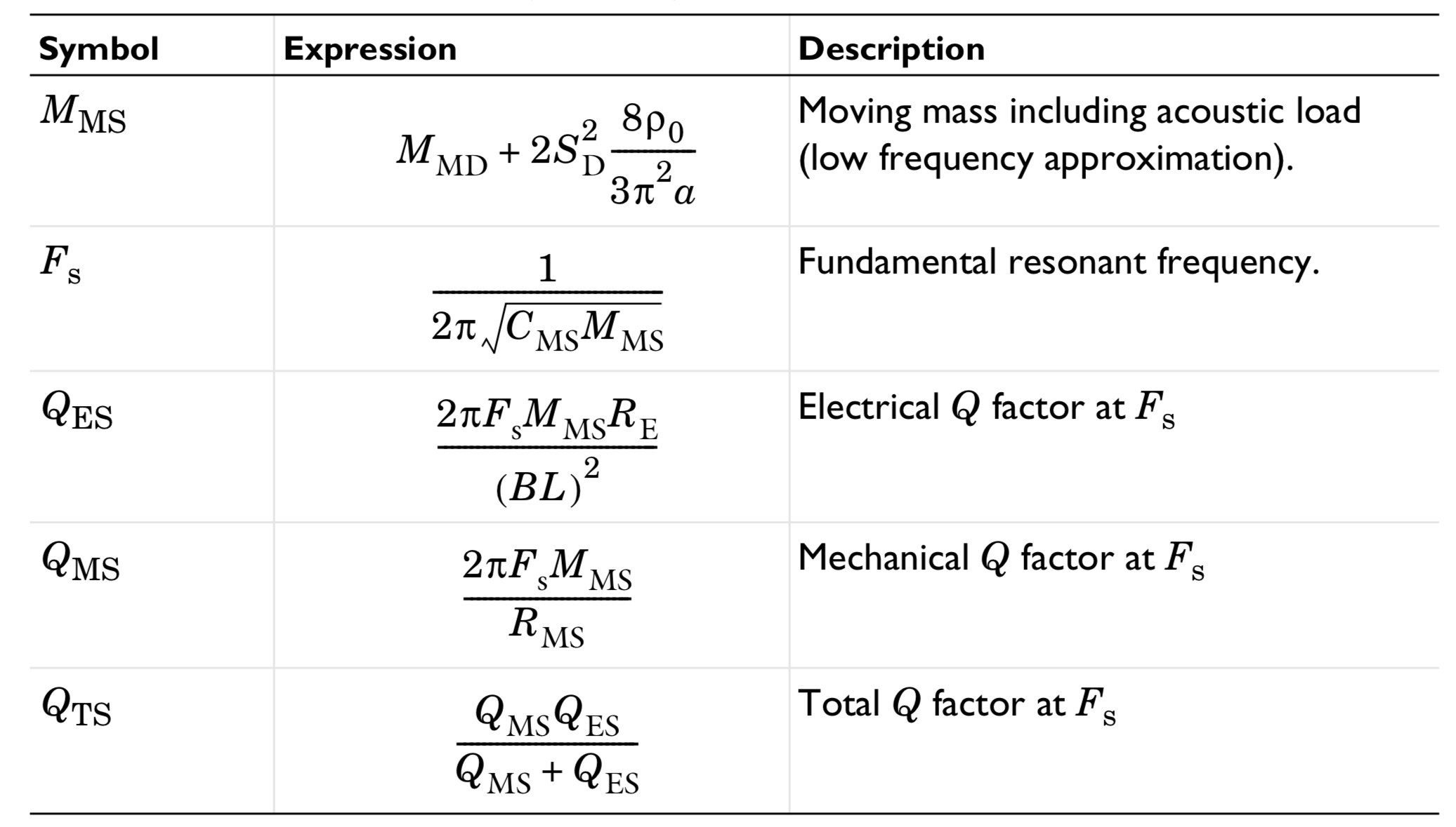

Adding a resistor will change Parameter. It is the way that I could take a 8ohm AE15TM and reach the parameters I have now with my 16ohm Woofer but maybe not the only way.
Where I am stuck at is this issue of CMS/RMS and the idea of a looser suspension being more accurate at low volumes and stiffer suspension "opening up" with more volume.....
Is this really true? I asked in another thread and I only got the vibe that it can be true but its not that simple. Sorry I don't know if I can get Klippel measurements on all these woofers, is there a way to discern this aspect through Thiele specs?

My issues with CMS are holding back from purchasing a woofer. The surrounds on the Oberton have half the CMS of the AE woofer.....Rms is still very close though.....I would think that Rms mattered more.....
Also, IF I change Resistance.....How Does this Change Inductance....I did not see the connection within the formulas I've viewed so far kyleneuron

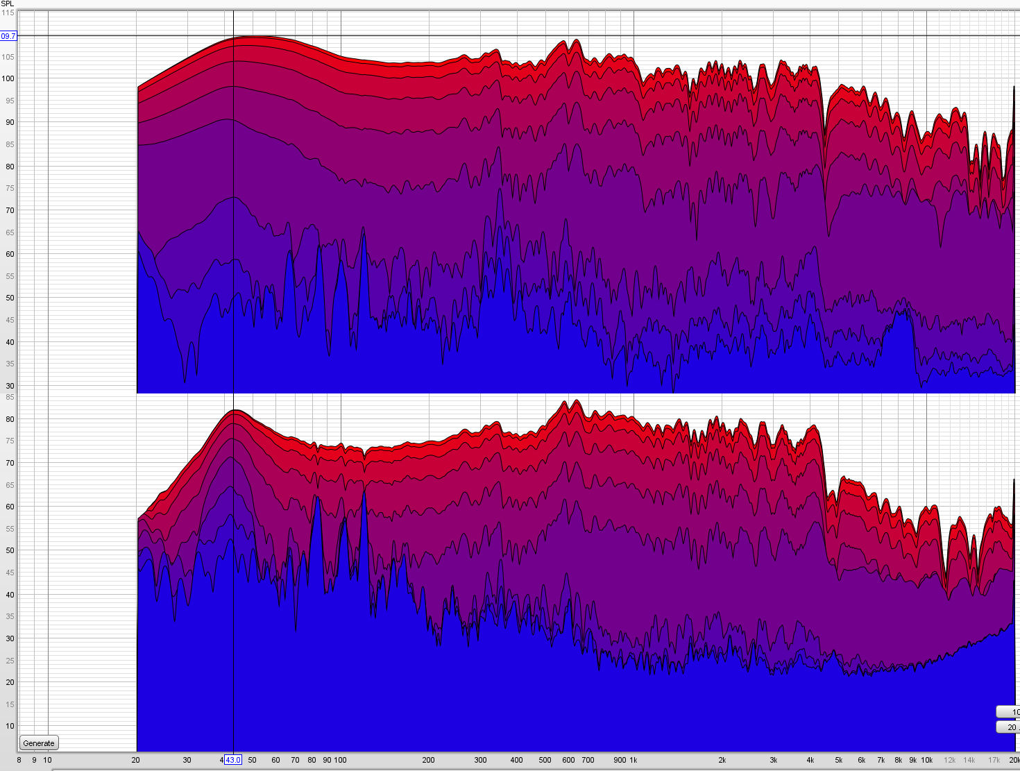

Also interesting is the different performance had at different voltage. Something I should considered since I will desire low voltage playback at some time. Below are some free air measurements of my fresh woofer. I bet over time as a woofer breaks in, the difference in performance at different levels, starts to even out.
I am really curious to this idea that driver with a lower CMS value are not accurate to transients at low Volume.
High Volt
Low Volt
Notice the performance at Fs

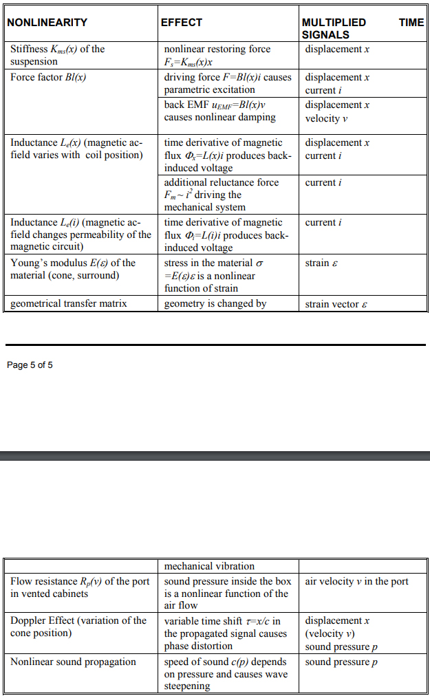

The LPM and LSI modules from Klippel use electrical measurements. Those are the ones used by most speaker designers; small and large signal parameters, as a function of excursion.
The other modules are more focused at R&D of transducers or complete systems. If you ask nicely, and explain why you’d like to see it, many transducer manufacturers will share a Klippel dB-Lab file with you.

Look at how much decay changes at F. This would be high passed in my application but I wonder if there are such large variances with the enclosure in use instead of free air.
