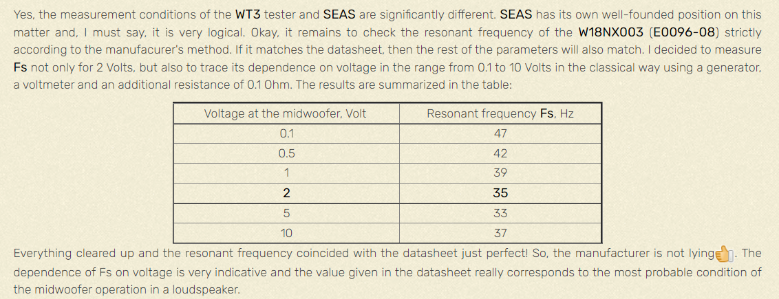

camplo you might find this contained within a review of a Seas midwoofer interesting as it pertains to TS parameters varying significantly with drive voltage.
Seas Excel 6" W18NX003 (E0096-08) midwoofer review | HiFiCompass

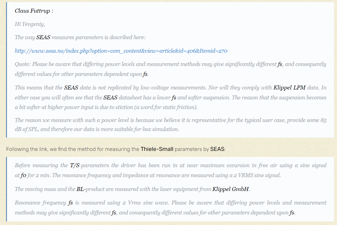

The right level of signal would depend on the expected voltage during use if that is known. Most hifi woofers will be looking at 2V plus as they tend to be in the mid eighties SPL at that voltage.
This is why SEAS measures at that voltage. And the difference in Fs can be quite significant from 47 down to 35 in that example.
