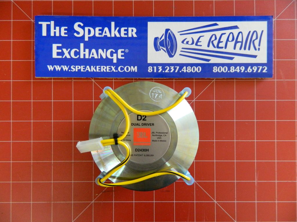

It's not conjecture it is a dual diaphragm driven by the same signal.Could you guys point to a source of this or is it conjecture?
Brochure
http://www.linkwitzlab.com/M2_Brochure_Jan2013.pdf
and wiring seen here

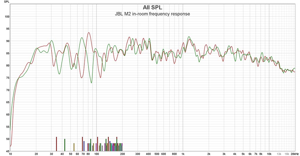

I have a few in-room measurements of the JBL M2 from different rooms. Here is one example with 1/12 octave smoothing:
Legit 20 Hz to 20 kHz operation. DSP/DRC can smooth the frequency response as desired.
Erin, aka @bikinpunk has run the full gamut of JBL M2 loudspeaker measurements, including polars at: JBL M2 Master Reference Monitor
Brochure
Yes, dual ring radiator / dual phase plug / dual voice coil - BUT a common electrical connection. I’ll be less sloppy when splitting hairs in the future😉
