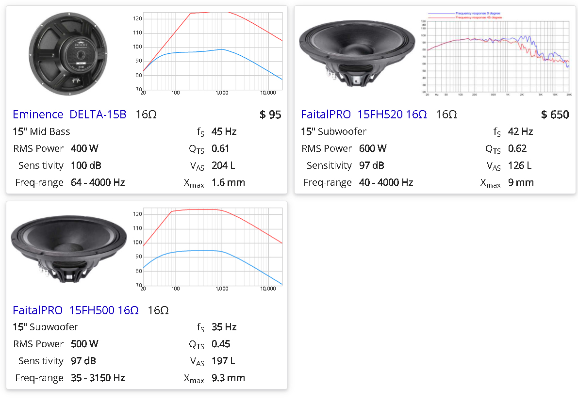

Since this is all custom, seems like you'd want a 16 ohm system to keep current draw/thermal power distortion low.
Slim pickens....
The AETD15m I have now measures like it will eventually have a Qes/Qtc .6ish, 34hzFs, 17tm, 66Mmd, 49Mms, 12.5Re...312vas....
I don't know enough about woofer design but if we Do something to raise Tm to 23-24 where it should be....How does it change everything else? The only thing that could save me is if my woofer magnet wasn't charged properly? How do I check the magnet charge lol...
There some other woofers I looked at that offer 16ohm versions....They don't sell them anywhere....but the manufacturer has it listed as an option....but its not sold anywhere....see the pattern.
