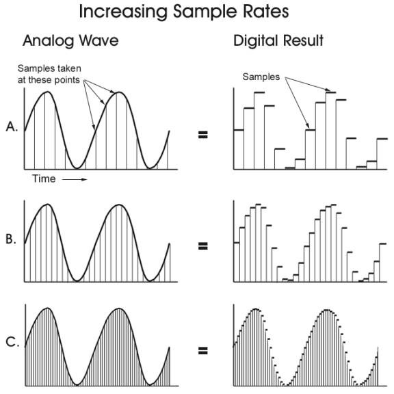

The sample rate is basically a carrier signal for the music signal itself, when looking at digital.....so the higher the frequency, the more points of data generated, the more accurately the system can replicate the impulse.

No, to represent a 20khz sine, you can do this within a 44.1 or 48khz bandwidth, using 96khz does not represent the 20khz sine any more accurately. Not ... one ... iota.

using 96khz vs 48khz (for ease of example) does allow you to represent double the bandwidth before bandlimiting, but it doesn't plot the same frequency signals with double the accuracy. it doesn't need to, either; using more does not increase the accuracy, it's already perfect.
Looks more accurate to me. Something else must be going on, on the digital side of this...?
According to what I just dug up "Therefore, we need to measure the wave at least two times per full cycle to accurately capture its frequency. ".... Capturing a generalized frequency and capturing an exact waveform are not he same thing. How does it know whats happening in between the samples?
yep, you are misunderstanding the way sampling and the sampling theorem itself works, but dont worry, it's a very popular misconception 🙂. Let me search for a decent youtube or reference to do a better job of explaining than I have the time, or ability to do. The Nyquist sampling theorem will get you on your way, but there was a very good link posted some years ago that did a very good job of explaining the subject.
a sine is perfectly represented with just 2 points, one at the top and one at the bottom. we need JUST more than double the sample rate vs the max FR we want to sample in order to get a PERFECT result, remember we are talking about digital representation here. The discrete samples are interpolated between (over time), (sort of like a Spline in 2D and 3D modelling) rather than a straight line being drawn between them.
The classic myth, explained in Sound on sound article🙂
Reconstruction filter is able to convert the "stairstep" visualization of digital data back to "analog line"!
Yep, the way its drawn by some, with the lines in between (which are utterly meaningless and misleading) went a long way to causing this broad misunderstanding, even by people interested in audio. I would have expected it to have been cleared up a bit by now, almost a decade after that youtube vid was made though ...
the part where he describes how only a single frequency will pass through all of the points is important and relates to what I was trying to tell you. the points/samples of a 20khz wave, will only superimpose on a 20khz sinewave.
