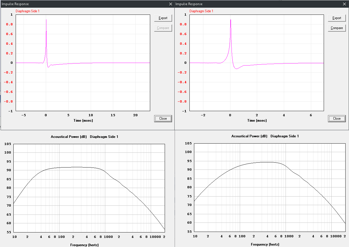

Regarding a diaphragm...Imagine being able to adjust mass and rigidity independently from each other...whats the use of adding mass?
Well with some nice tools like Hornresp, VituixCAD or Akabak, you can actually do this and observe the resulting changes in magnitude response, group delay, and so on when keeping the 'box' the same.
Perhaps give it a try?
If you'd like to know the 'why' for the differing results you'll see, there's always those books that keep getting brought up.😀
lol point me to the book that explains it and I'll look it up....I think I have a firm enough grasp on physics to grasp the basics.....a 0 mass, infinity rigidity, diaphragm, is the holy grail.... "Every" aspect has harmonic characteristics it seems (dimension/mass/Geometrical configuration/volume/density/etc) So if one can separately adjust mass of an infinitely rigid diaphragm.....they would intend to tap into a mode placed where they intend to use the diaphragm...modes come with drawbacks not just increased sensitivity.

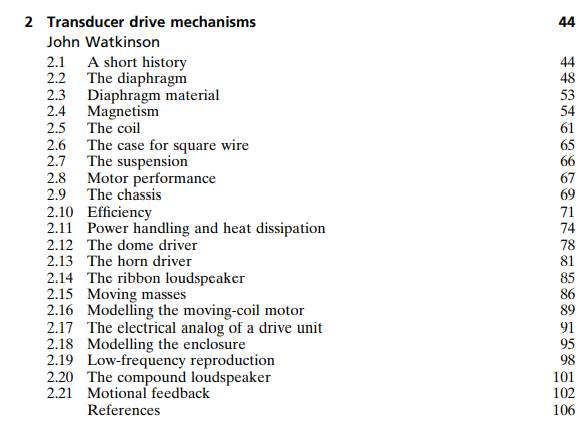

Loudspeakers and Headphone handbook by John Borwick would be a good place to start. I have a feeling that Ro808 has even gifted it in this thread if not the internet can provide to get you started quickly.lol point me to the book that explains it and I'll look it up
I'm sure this or any book doesn't explain everything you might want to know but the conversation might be easier to continue.
I have given a couple of books multiple times by now (in this thread even), seems you still didn't spent much time on those........

To expand on your (very good) recommendations with a psychoacoustics book that’s actually fun to read for those who aren’t happy looking at pages of just equations:
Acoustics and Psychoacoustics - David M. Howard, Jamie Angus - Google Books
As to the final line in the reply to my previous comment; my point is that you can use a large number of tools with a lumped element model of a transducer, and freely put whatever value you'd like in for Mms/Mmd, or Kms, or any other parameter.
The diagram I included shows an electrical equivalent circuits (resistor, capacitors and inductors) which can be used to determine the radiated output of a transducer, at low to mid frequencies at least.
That is covered in various levels within the books recommended so far in this thread, and the papers from that era (1900-1930) are all open access at this point, too.
Even if you don't go to read the text, you can at least move a single value up and down and see the effect on the response.
