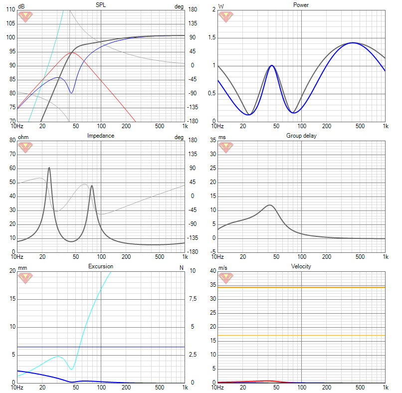

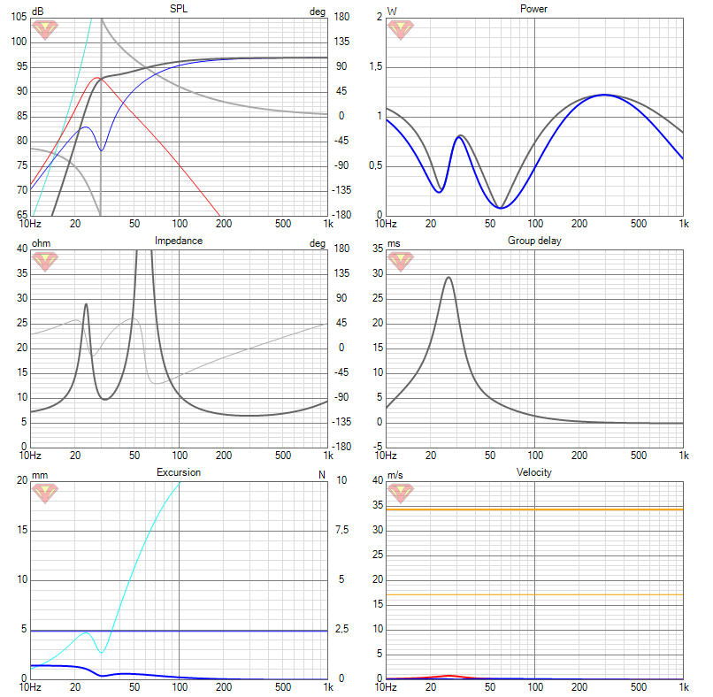

Does anyone have a recommendation for a 15" woofer to best the AE 15m... Something with a similar or lighter Mmd/Mms...
I like the sensitivity - but the 38Hz Fs for a driver that large is disappointing. And it has a pretty low Qts, of 0.249. The Mms is 67.14 grams.

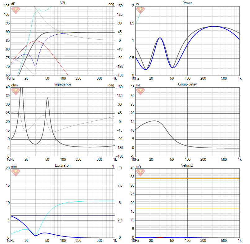

The woofer I used in my MLTL-10 speakers, is the SB Acoustics SB23NRXS45-4, which is 92dB sensitivity, Fs 27Hz, Qts 0.3, and Mms is just 27.2 grams. I am looking for a woofer that is better - more sensitive, with the same or lower Fs and Mms, and maybe higher Qts.
The MLTL-10 speakers that I built are F3 at about 27Hz, and in room F6 is about 20Hz. I have redesigned the lower portion of the transmission line, and the F3 point should be about 25Hz; and the in room response should be better, since the terminus opening moved from the lower front corner, to the lower back corner of the cabinet.

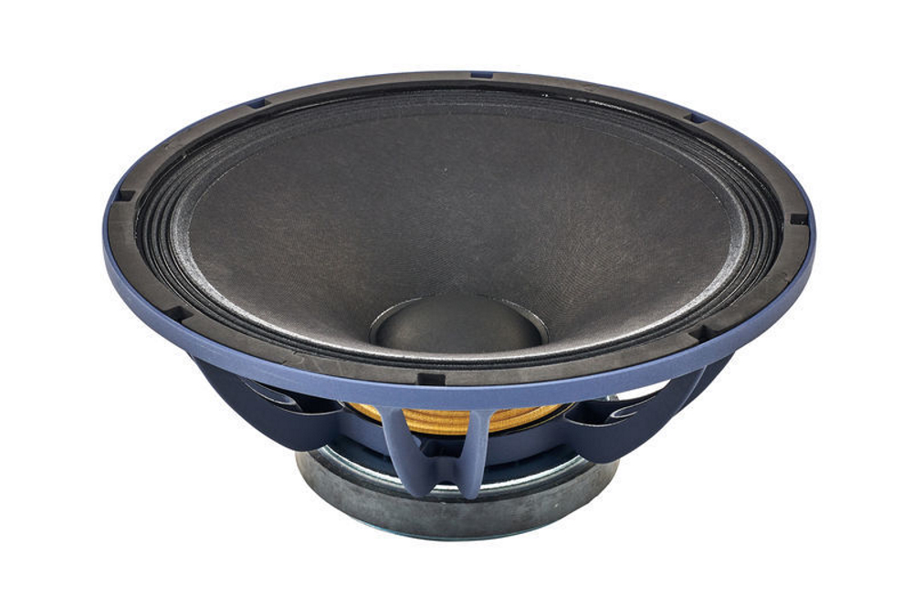

Oberton 15L400 - 15" Subwoofer

Heres one that is the epitome of a lower mass 15"...Why isn't this driver the holy grail if low mass is King
The15NMB600 has my attention. Any nay sayers?
